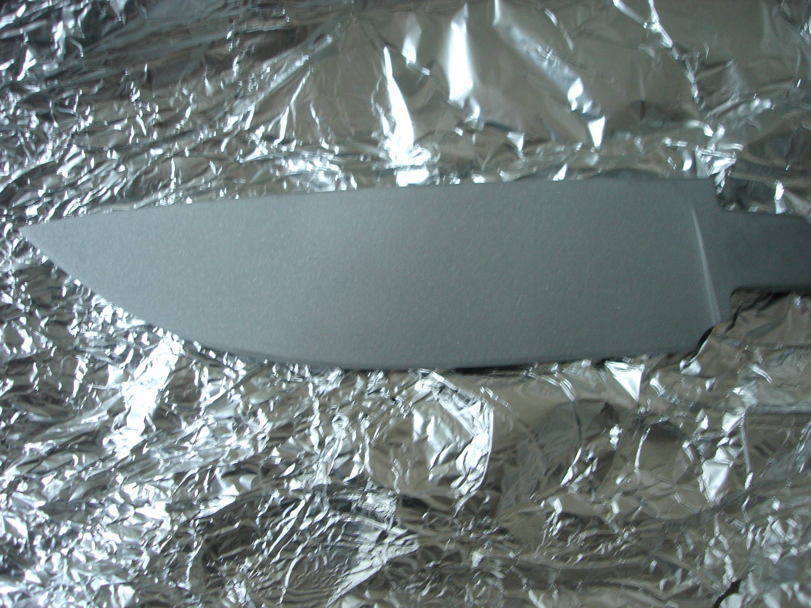

This data in bold text is from shop where I get this steel . BUT we don't HT plate we bye from them ...in the name of god :mad: We HT knive with specific geometry . Blank on picture is ready for HT , but HOW long to soak ??? It's 5 mm. thick on spine and about 0.6-0.7 mm on edge . So , how long I need to soak this blank for hardening ?? I would / not only I / be very grateful if someone explain this problem . Which thickness we take for reference in determining the soak time ?? Spine or edge ?
Hardening: 830 ° C (holding time 2-3 minutes per mm thickness) / annealing at 170 ° C for 1 h = ca. 62-63 HRC.
PS . Several times I send them email with a question, but they does not answer to me . I'll never get anything out of them again !
Yes, 5-10 minutes will do, insert the blade in your furnace only after it reached the target temperature and it is stable; start counting the time after the blade reached the target temperature (you see, it doesn't matter the thickness, soaking time starts with the whole blade in temperature!). I suggest lowering the temperature to 805 °C, try not to go hotter than 815-820 °C. Final HRC after tempering to 175-180 °C should be around 64, and that steel will work wonders at that hardness, but will work very well even at 62 HRC if you feel more comfortable and plan to abuse the blade, in that case rise the tempering temperature to 190-200 °C.
If you have an hardness tester you could confirm it by treating some samples at different temperatures and different soaking times.

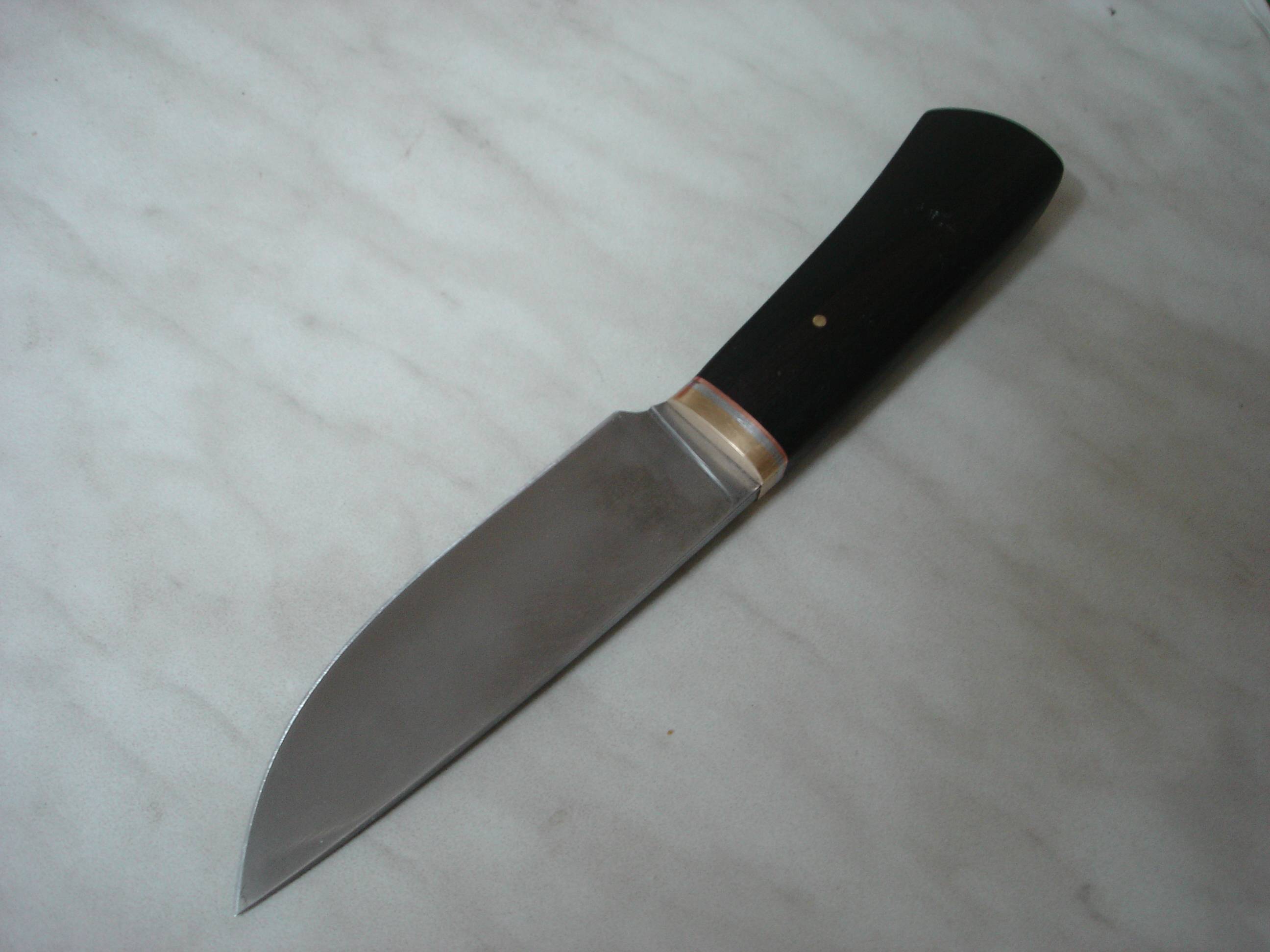

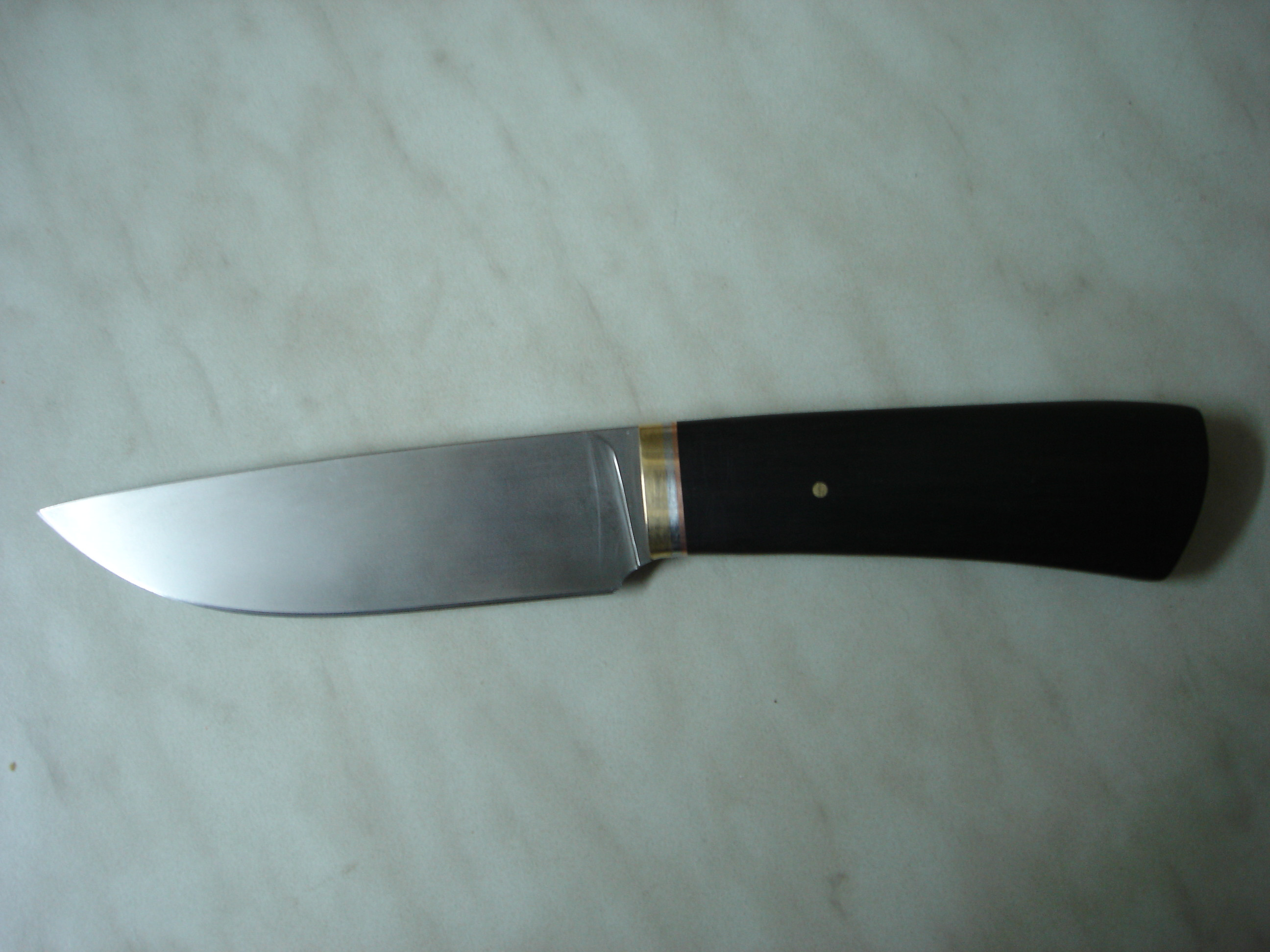

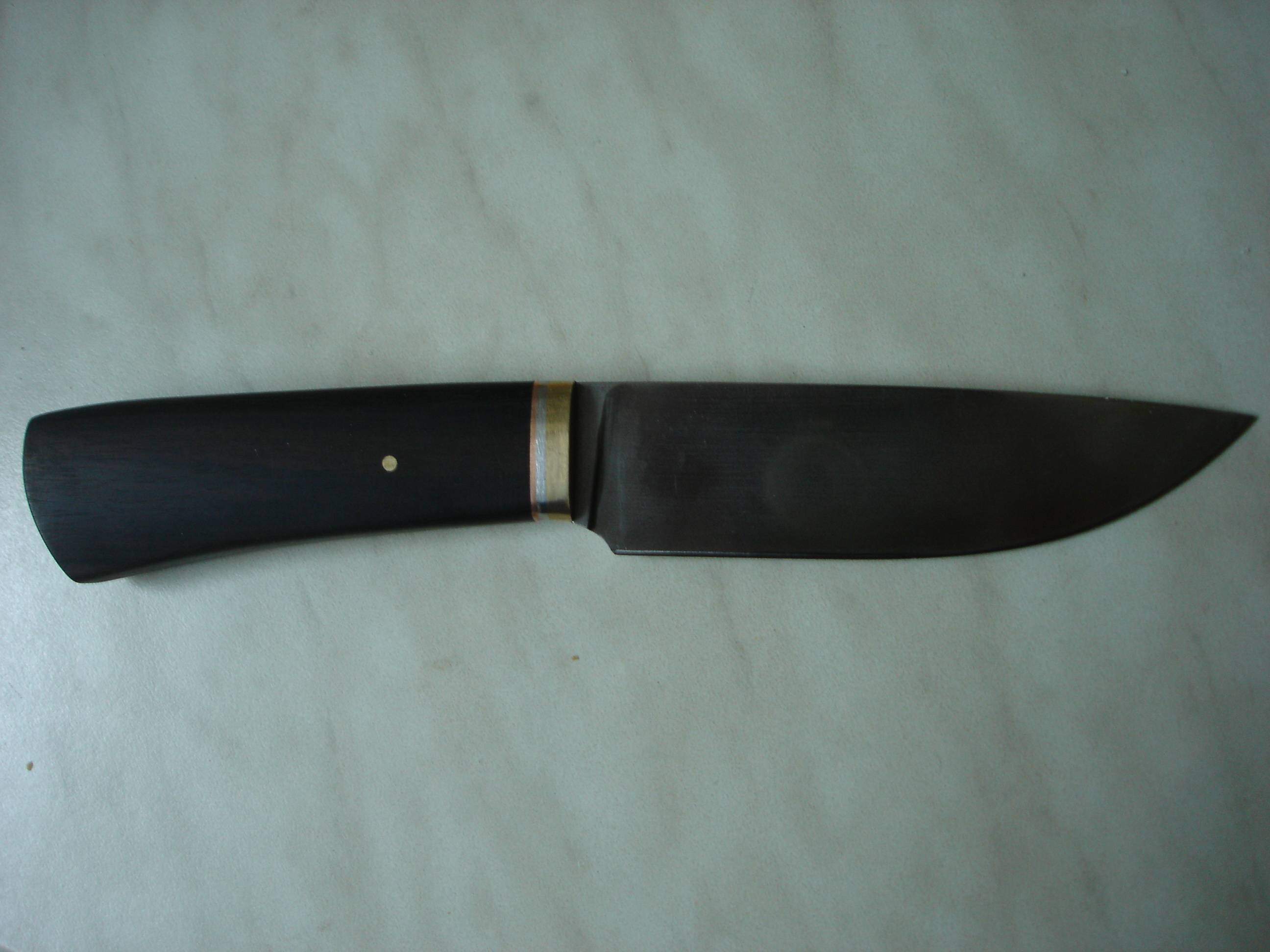

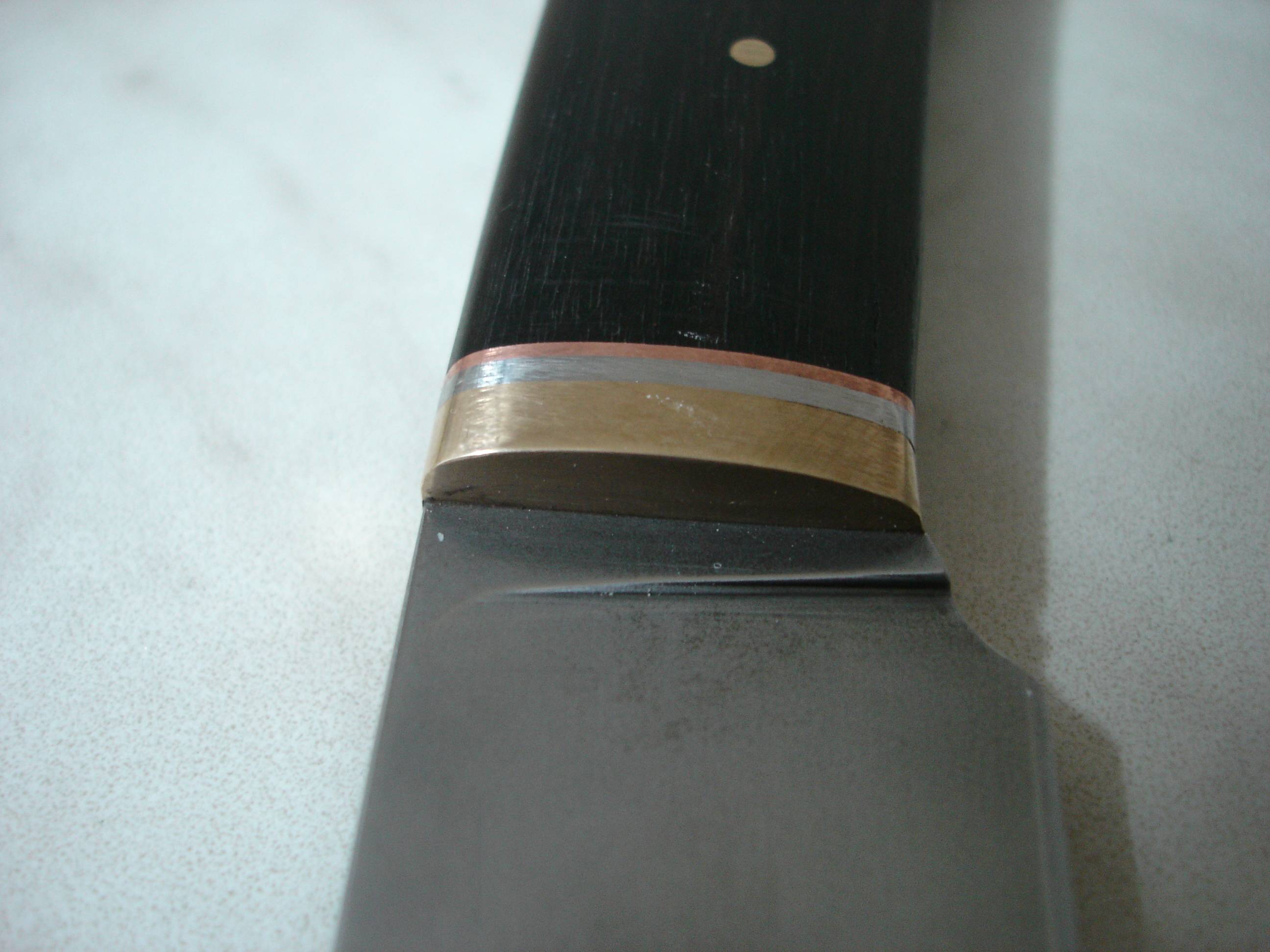

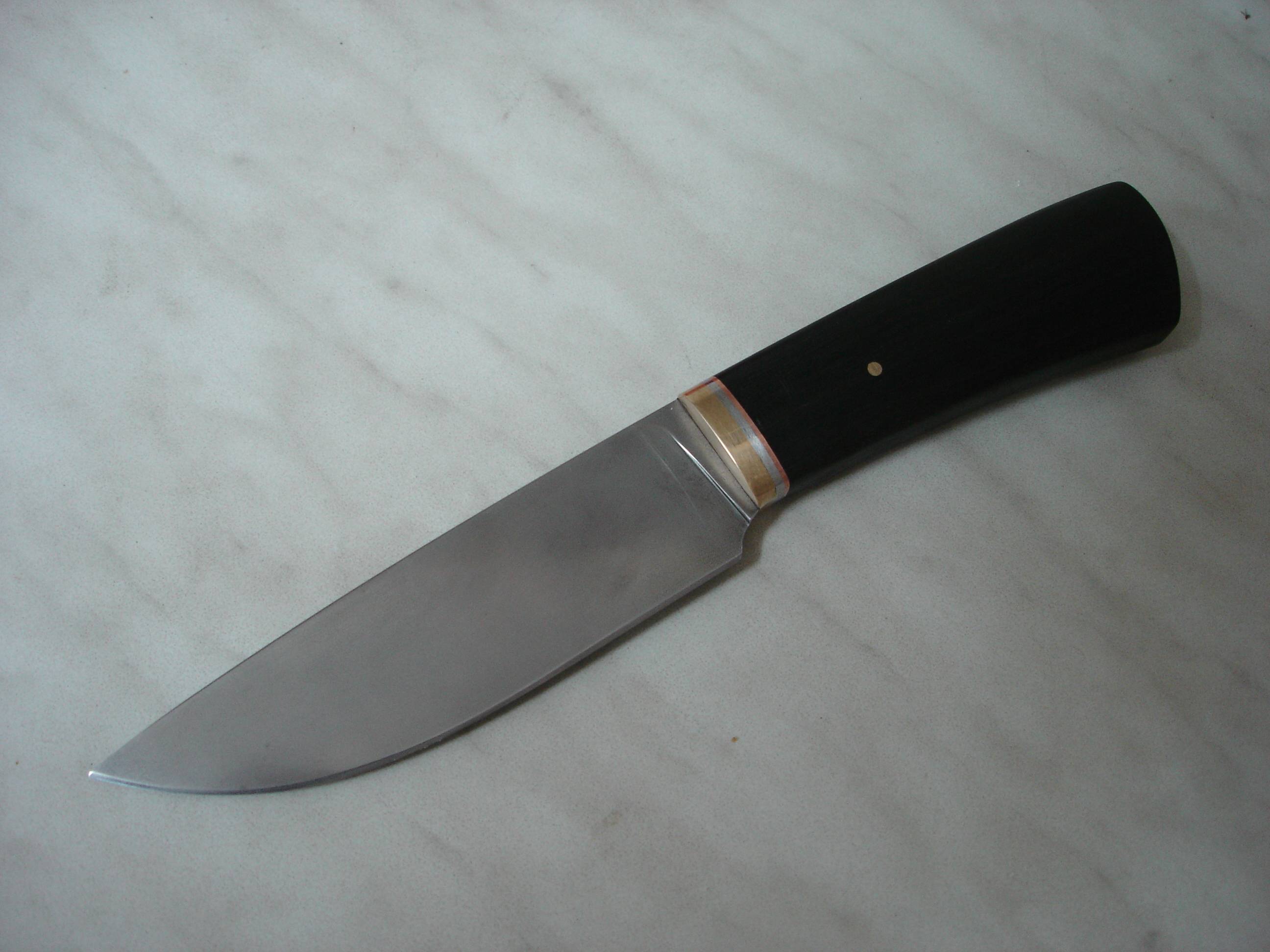

I finally finished this knive .I left as it is in hardness . I decide to do hard chrome so I sandblasted blade . . . . but then I change my mind and here we are............. wood is a black ebony and for bolster I use combination of bronze - stainless- copper . Thanks again for your help and I like to hear what do you guys think about this knive ? I'm making progress in this new hobby or . . . :)
Thank you ! The total length of knive is 25.5 centimeters . From tip to bolster is 13.5 centimeters which mind handle is exactly 12 cm. /bolster + wood / It s lying good in my hand . . .
And if anything means,balance is exactly on the bolster ?
It is a beautiful knife! It is difficult to tell from the pictures, but if you are going to keep it for yourself as a user, i'd thin the edge with whetstones down the road, blending it into the main bevel. The steel you used would allow it.
I really like the line you gave to your knife, it's really craving for the hunting season!!
Thanks stezann ,I'm glad you like it :thumbsup: Yes , this one is for me .The first plan was to hard chrome this blade . that s why I grind full flat.But I change my mind ...... I would have grind it convex if I know that will not do hard chrome . Now is about 0.30 - 0.35 mm. behind edge , angle is 15-16 degree per side . When needed in future I'll sharpen it as if it's convex grind :)
