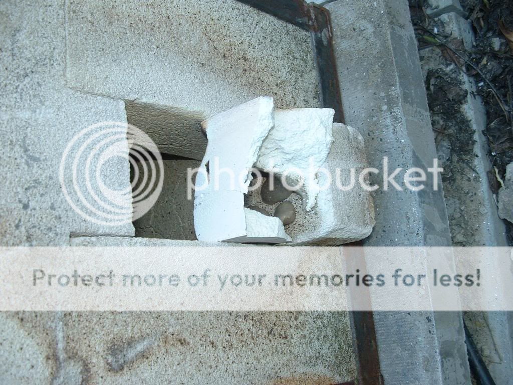

I have to disagree here.
For a forge (which is after all what Atlas do), I'd completely agree that the JM23/K23 are not the best choice. I have tried other IFBs which are much more resilient and which have a significantly higher melting temperature.
However, for an electric HT oven, which will never see more than 2300 degF, the better insulation afforded by the K23/JM23 IFBs makes them the better choice. In addition, they are easier to work by hand than the denser IFBs I have used. The difference is enough to be significant in terms of time taken and cost of tools when building a one-off HT oven. I built my first with "other" IFBs and my second with JM23s. With one exception, every one I've built since (I think I'm up to 7 now) has used the JM23s, despite them costing nearly twice as much here, because IME they are so much better for HT ovens.
The exception was a sword-length oven built quick, cheap and dirty. For that, I used Ceramic Fiber board for the roof, backed up with Calcium Silicate board, which meant I could build it with a 9" wide chamber without having a problem spanning the gap. As a result, I only needed to cut 2 bricks to fit. I was not greatly concerned about the lower insulation value because it was only ever going to be used for Carbon steels, though I did test it to 1100 degC, 2012 degF. I had the cheap IFBs to hand because I'd bought in enough for a couple of forges.
I use a router to cut the element grooves and the cutter has no problem at all with any of the IFBs I've used so far. Filing the grooves into the first one was enough. Sawing the JM23s is easy with a cheap hardpoint woodsaw and the saw lasts pretty well, though it's no good for wood afterwards. The others wear away the teeth and take the set off the saw *very* quickly.
For a forge, I've tended to go with cheap no-name 23-grade IFBs. These have lasted pretty well for my occasional use. When I was playing with burners, I used a chunk of a JM23 to restrict the opening on a forge and it dribbled. Peak temperature measured was 1445 degC, 2633 degF.
