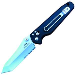

Here's another "Coming soon in 2008" that would be really a cool idea.
Okay, get ready.
Take a deep breath.
...and imagine a Rainbow Titanium X-Ray Vision. :) :eek: :)
This picture (due to the photo being "off" ) should give everyone just a hint.
