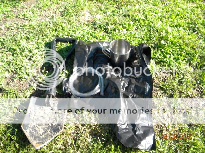

I am starting the process of making sure I can use all the items I take out with me. One of which is several large black trash bags. Amoug other things it can be used to construct a solar still. Also in my kit I carry the stainless cup and the tubing which both also have several uses.
First garthered up my tools, Shovel, cup, tubing, and trash bag.

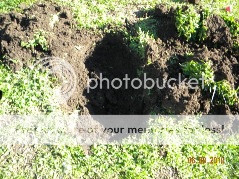

Then picked a spot that would get sun all day, as long as it is sunny. And dug a hole. I made the hole big enough so that the trash bag would cover the entire hole. I then cut the trash bag open.

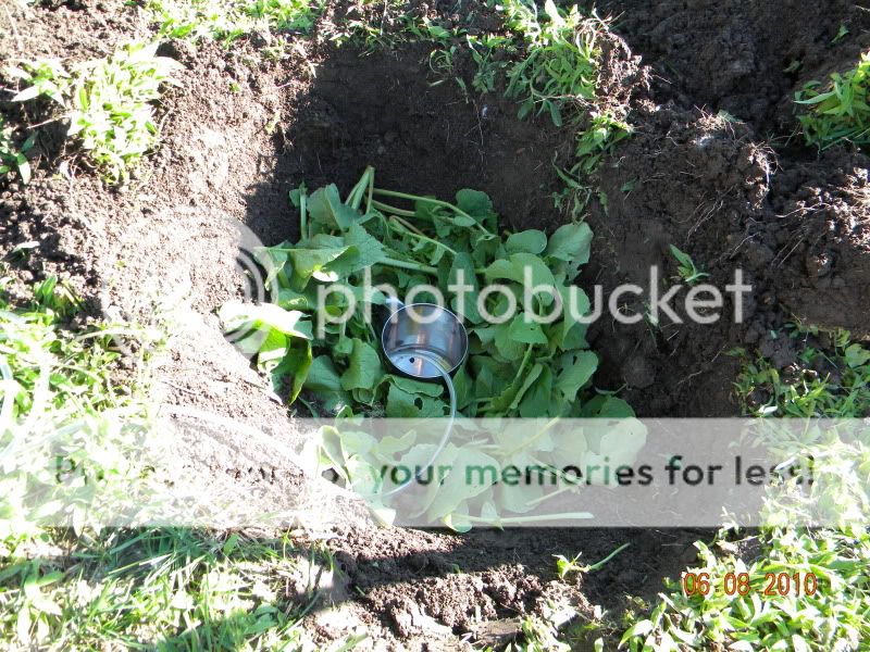

Placed some nice green leaves in the bottom, that would contain lots of water.(Happen to be radish tops from supper) I then urinated on them to add to the moisture in the hole. If you are wondering the water in the urine will evporate and leave the bad stuff behind. Made sure to place the cup in the middle of the hole with the tubing in the cup. Making sure it was long enough to get all the way out of the hole.

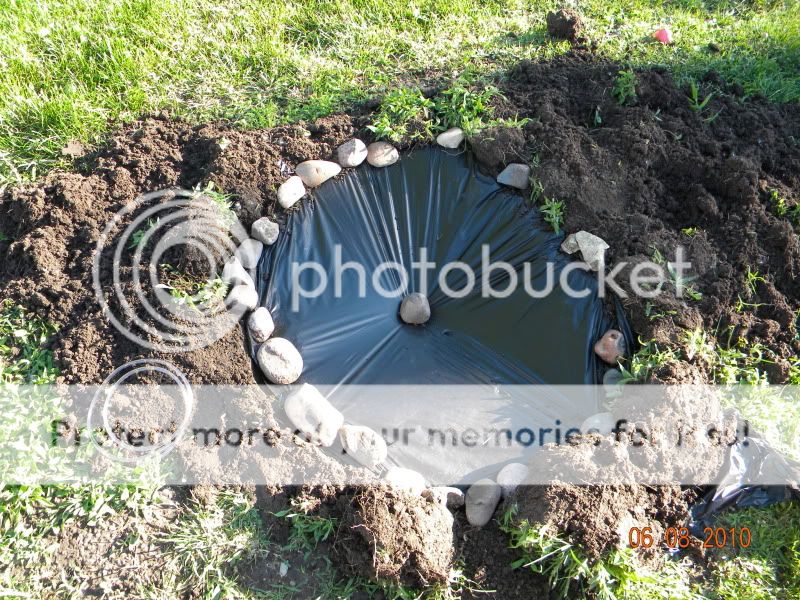

I then covered the hole with the trash bag and used the dirt from the hole to help hold it in place. With the aide of some river rocks. Made it as tight as possible and placed a rock in the middle directly over the cup to funnel the water droplets into the cup.
I plan to leave it for a full 24hrs then go check it to see just how much i collect. I have done this before, but it has been quite some time ago. I know this method works, just wanted to practice and share with those that have never tried it.
