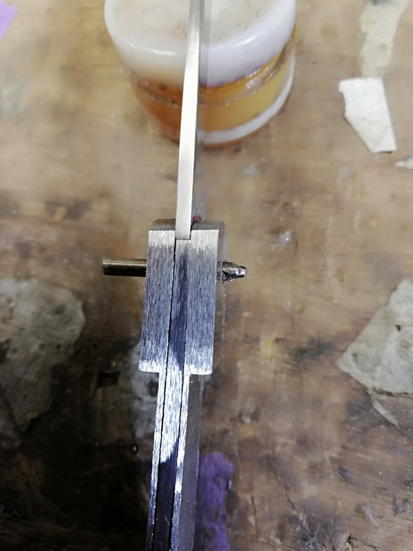

I'm using a (German) stainless to stainless flux for soft solder
This is the setup I'm using, I have a small burner fixed and pointing upwards and I move the piece over the flame.
It is not pretty and I cooled, cleaned of burned flux and reheated twice but I have solder all over.
Is this acceptable?

hello. some solder flux's have a shelf life. how old is yours ? are you sure the surfaces were clean enough? looking below where you soldered on that liner its hard to tell. i have noticed if surfaces are too rough, or too shiny ( mirror) the solder has more difficulty taking hold and spreading. i found a clean 1000 grit surface works nice on stainless. also as stacy mentioned, make sure that flux is specifically made for that solder, by the same company. somehow things get much more difficult when soldering stainless versus other metals. another thing to try is while you are heating your work piece and the solder melts, take a long piece if 1/8" brass pin stock wet with the flux and use it to wipe the solder around, trying to spread it evenly while heating it. sometimes that helps the solder grab on a wide flat surface and get less blobs. even with a heat gun, its still easy to burn the flux. once the solder starts to bubble, move the gun back another 3 inches. another issue may be too much flux. flux actually starts to eat into the metal before you heat it. it will make a frosted line on your stainless if you leave it there for a few minutes. the heat speeds up and finishes the process. it just needs to be wet when you start heating it. if you have a puddle of flux on your bolster when heating it, there is gonna be a thick hardened patch of flux your solder has to get through to contact the metal. that excess flux never touched the metal, so it never did anything helpful to begin with. it just needs to be wet enough so you can see the metal changed color when you wiped it on. good luck !

It was a battle of wills but I soldered a pair of bolsters!
This is an older slipjoint I made that I took apart to rehandle and practice something else.
Now it is going to get a pair of soldered bolters as well.
The biggest game changer I think was getting fresh flux. I got the same brand as before but maybe the older flux has gone bad over time.
It came with new solder, 3,5% silver rest tin.
What I have learned and may help somebody else:
Don't overheat, heat doesn't disapper immediately when you move the piece away from the flame.
Get the solder liquid and move it around with a (titanium) pick. The piece doesn't need to be in or above the flame for that.
If it doesn't take somewere, heat that part up and drop just a little drop of flux with the pick and while it bubbles move the liquid solder over it with the pick. (flux is colder so heat that part up a bit more)
I've re-heated a bolster that had parts not tinned correctly and moved the solder over those spots with success.
Also don't have huge blobs of solder sitting on top it prefents the two parts adhering well. Just have everything covered in solder and whipe the rest of with the pick.
Now that I'm getting some controll over the process I'm actualy enjoying it.
I'll be doing some slipjoints with solderd bolster and maybe try different metals after that.
Here is my result and the flux I used. I got it in Germany, it may help someone (the "ST" is important!)
