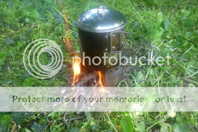

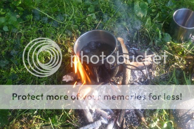

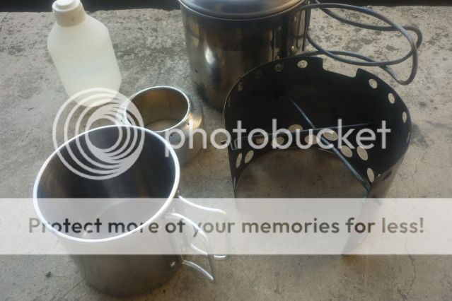

I made this compact solo cooking kit recently. Accent on this one was on higher pot stability and larger wood burning chamber and feeding hole

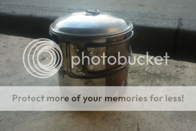

It started like this
To this

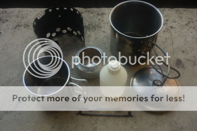

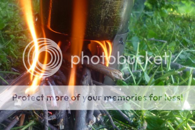

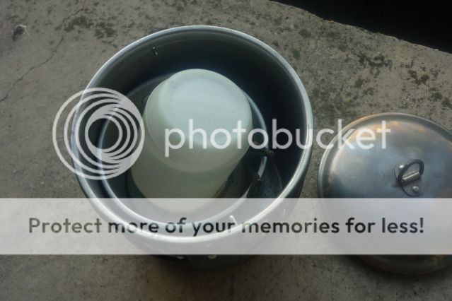

Insides :D

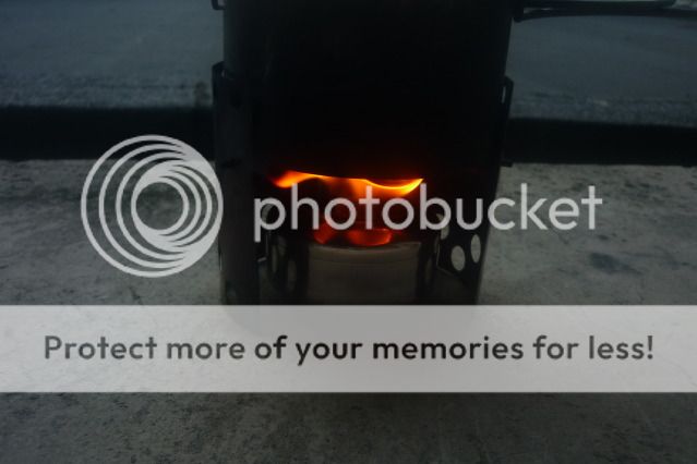

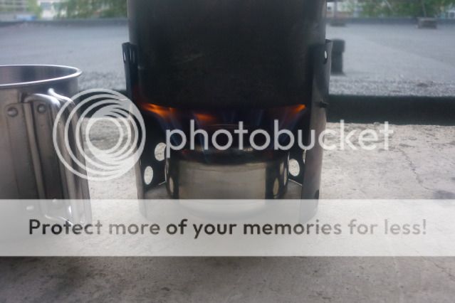

Pot support wires have two heights, lower for burning:
Gasoline
Fuel tabs
Alcohol

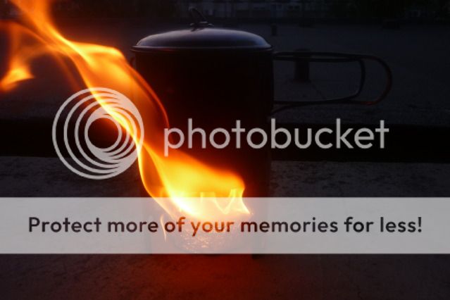

In higher position for burning twigs and alike

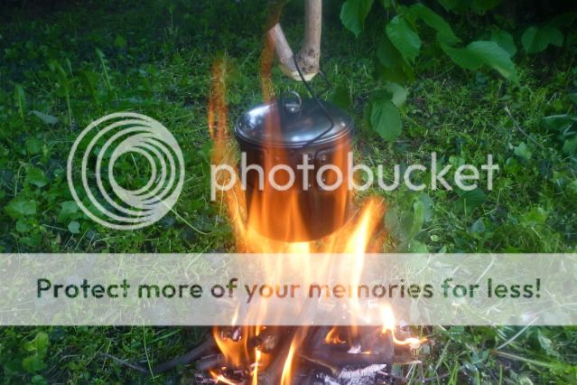

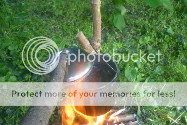

It has removable bail wire
And good old coal cooking :)

Nice - if you're ok with just alcohol, then a Whitebox Stove www.whiteboxstoves.com with the foil screen / integrated pot stand will save you a bit of weight. Right now, you've got a super flexible multi-fuel system so you're not reliant on a singel fuel source! I imagine its still pretty light anyway :)

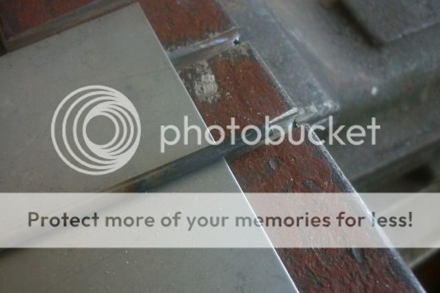

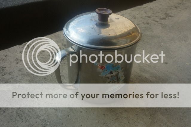

Containers i was using are just plain stainless mugs. Wind screen was also made out of the same mug. I cut shape, and using this
with hammer i bend plates that holds handles and rivet that to a mug

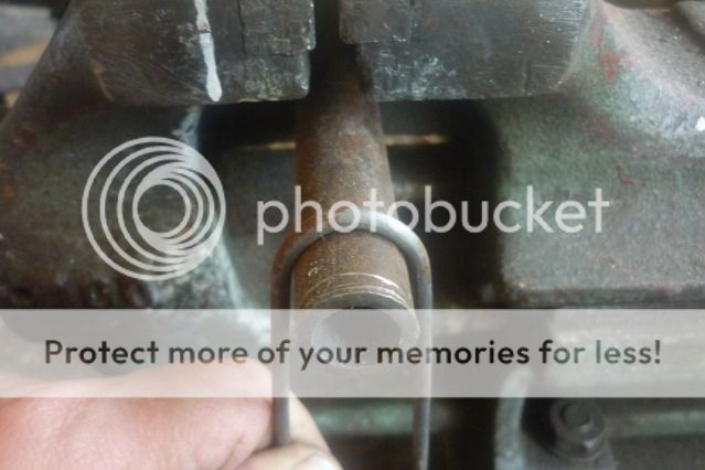

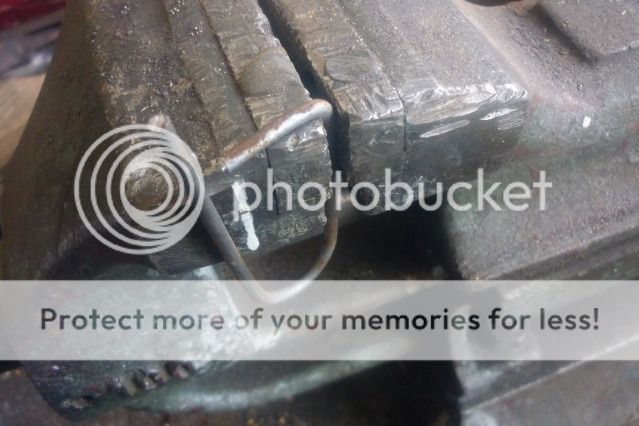

When bending wires, always bend around something
And because wires are thick-ish, don't use pliers but vise and a hammer
This was just to show how, it's not the actual materials used in the bild
I hope this helps
Nice work. Had no idea you had made both of the containers. They look a lot like GSI Glacier cups. The multi-fuel system gives you a lot of options. I really like that.
