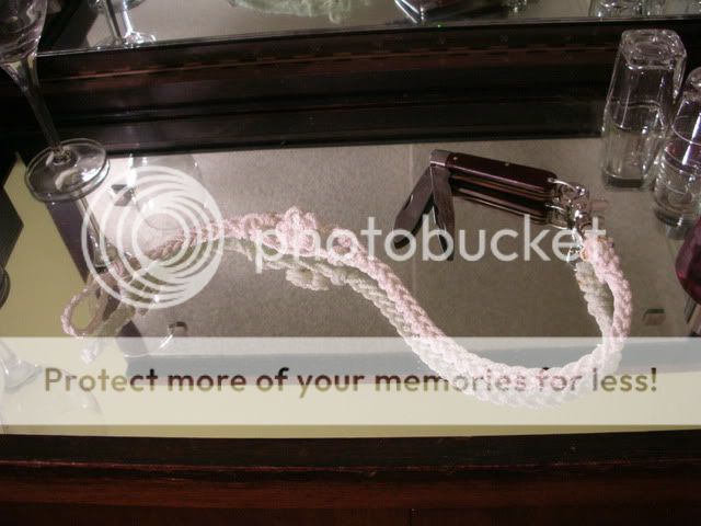

Here is the finished product clipped to my Boker TL29...

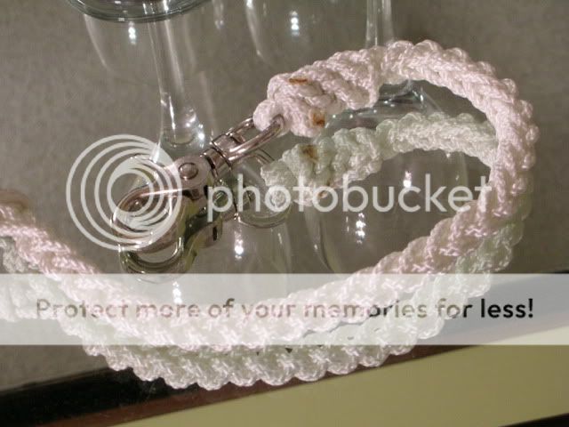

From the clip going back knots are as follows: 2 luggage tag loops, double finish crown, stacked single wall knots, double wall knots, and half round french sinnet...

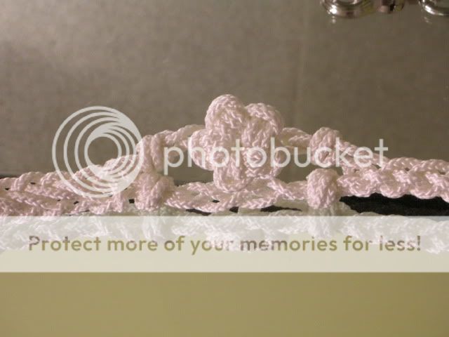

From right to left continuing up the lanyard: other end of half round french sinnet, two (2) 3-strand M.W.K., two (2) three plait braid, 5-point star button knot (slides on braid behind for adjustment), two (2) more M.W.K.'s, combined into 6-strand flat french sinnet...

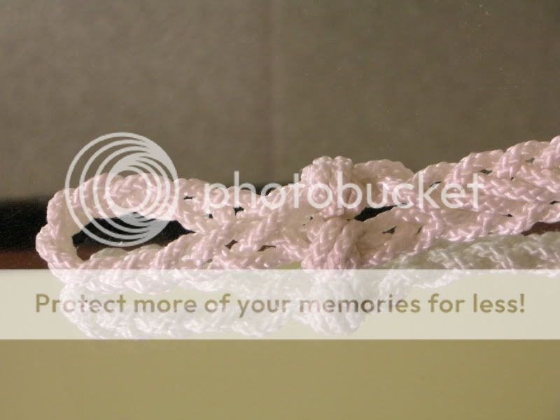

Again, from right to left: other end of 6-strand flat french sinnet, two (2) more M.W.K.'s, combined into three plait braid loop...

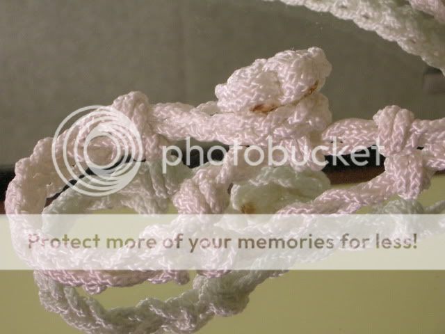

This one shows how to use an adjustable rope toggle: take your loop and pass it through your hard point (belt, rail, taught line, etc.) and then slip your button knot through the loop and cinch it up. The button knot slides up and down to adjust for different size hard points...

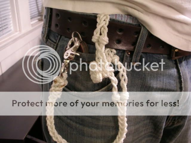

Finally, this is how it looks when attached to a knife and carried in the watch pocket. I don't even notice it as it weighs almost nothing and doesn't swing or bounce like a metal chain does...
