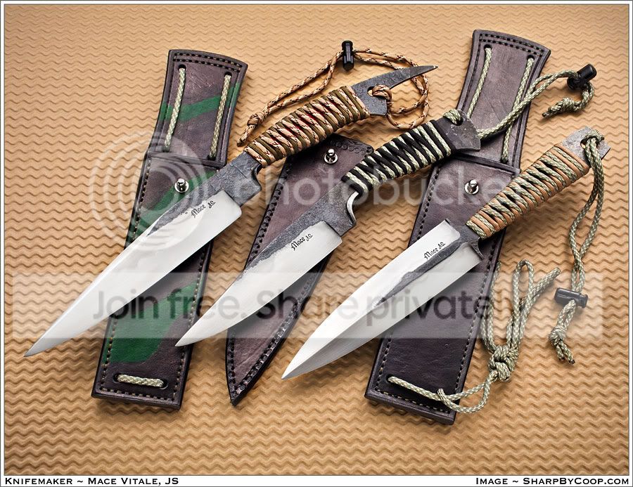

I have not posted much here in a while, so I thought I would share this pic of some of my fighters that Coop did for me.
All blades forged from the finest 1084 Aldo has!
Let me know what you think.

When I ran across this pic I had to tell you those are very cool; do they have a hamon temper line? It really looks like it.

I love them Mace.... :thumbup::thumbup: Thanks for sharing... Soooooo..... I've looked, and been unable to find a WIP or tutorial on upset integral guards like on your knives and the ones Joe Keeslar does... Any chance you'd do one? Or even mind if I contact you for a conversation???:D:D
Very nice, the wraps look wicked!

Tin, Welcome to the forums. Those are hamon that you are seeing. All these blades were quenched with clay on them, then polished and etched.
Brian, Right now I just dont have the time to do a tutorial, but I would be happy to explain how I do the guards. As far as I know Joe does them starting with the handle(which is how I did the first one in the pic)...I usually start with the blade(preform) then start to shape the handle a bit. I might use a round bar, fuller, or horn of the anvil to start the finger notch area. Once I have it deep enough I then clamp the blade in the vise point down...close to the finger guard area....(I'm not telling you when I take a heat...I figure you will know when you need one)...I tend to "tip" the handle portion of the bar back out of the way a bit...then I go to town with a cross pien of a smaller hammer on the finger guard area...straight down towards the tip. This goes on for a bit till it starts looking like what I want. Making sure not to push too much metal to one side or the other. You can straighten it out a bit over the hardy hole...then straighten the spine in a vise. Then I will forge the rest of the blade...then cut it off the bar and finish the handle.

Cool. Thanks. That's will help. My first attempt was before I bought my post vise. :eek: The guard turned out well on my first attempt but too far forward as I had forged the blade in first....Just trying to shorten my learning curve. I appreciate the help.:D:D

Brian, It does help to do just the blade pre form...(keeping it thick)..then forge the finger guard....then forge your blade out.
