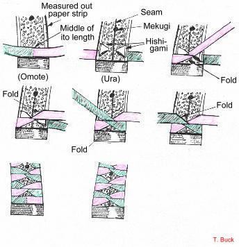

Check out some youtube videos on tsukamaki. Here's a helpful diagram too. (nevermind the paper triangles etc. I'm no traditionalist.) Just takes some patience and practice.
You can do this with some heavy shoelaces too. One should be long enough to do a kiridashi. I'm trying some with some skateboard "grip" tape underneath. Looks pretty cool. I'd say a regular two part epoxy thinned out a little with acetone would be just fine. I just always had the west system.
