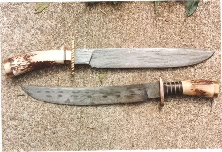

Here's a couple I've made.
The Bowie has an 11" blade of my 320 layer of O1 and mild steel ladder damascus, an elk antler handle my first mokume for guard and butt-cap, and pure nickel and blued mild steel damascus bolster and nut.

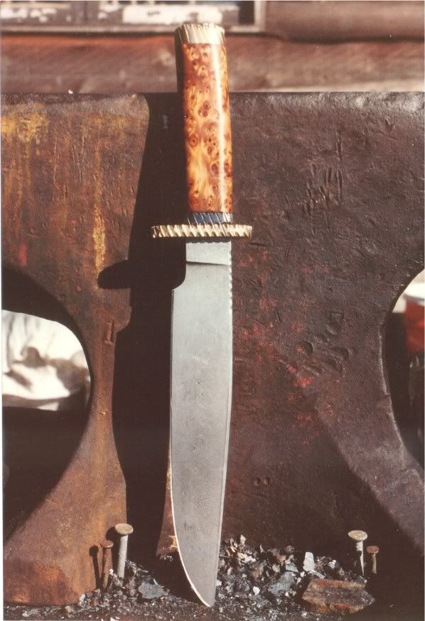

The hunter is made from my 1095 and 203E 448 layer ladder damascus.
It has a birds-eye red cedar handle and brass fittings.
