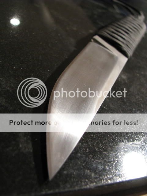

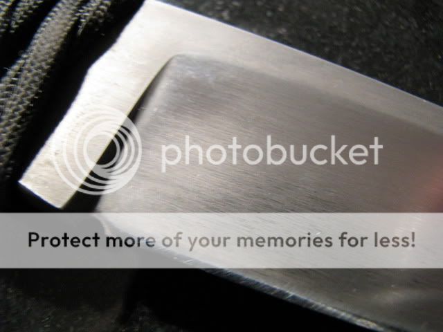

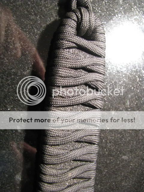

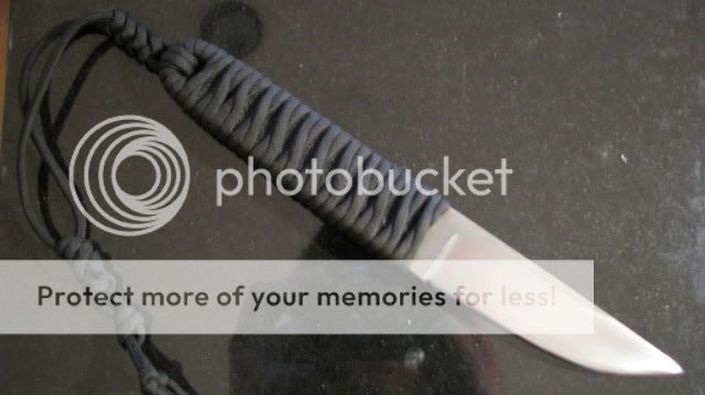

O-1 tool steel tanto, differentially tempered with grip tape and paracord wrap

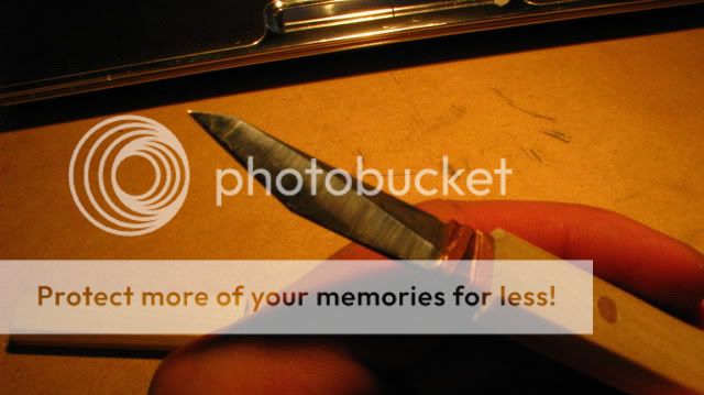

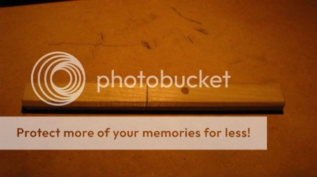

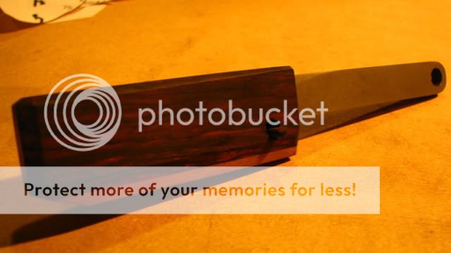

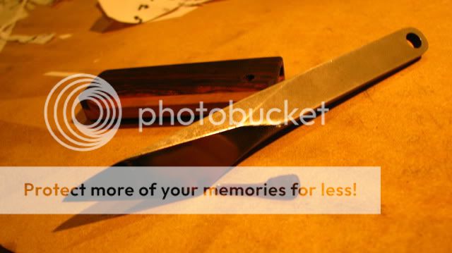

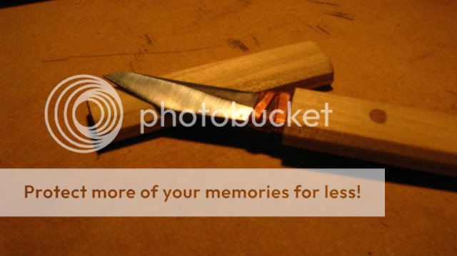

Laminated forged left hand chisel ground kiridashi with a poplar sheath in shirasaya style.The steel is O-1 laminated with CR 1018, and the mekugi is dogwood( I know that's not typical of traditional kiridashis, but who says this is traditional, lol) . As you can tell I can't/ don't have the things to weld a proper habaki, lol, hence the folded copper.

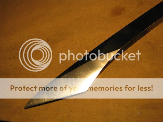

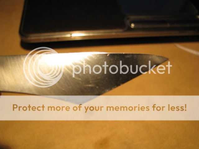

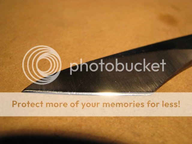

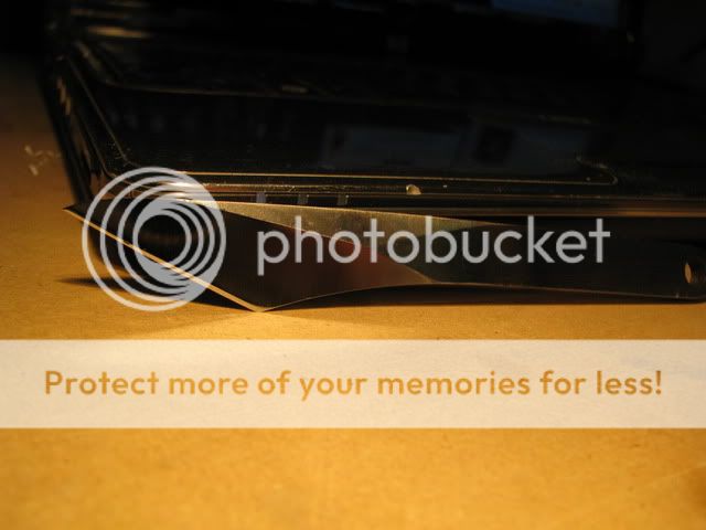

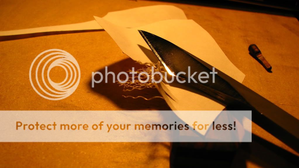

Another lefty kiridashi I made, also out of O-1, this time though was from stock removal and was differentially tempered with a blow torch, and is probably the sharpest knife I've made thus far as it will whittle hair easily, lol. I put a patina on the blade for added rust resistance, and thus far has been holding up fairly decently. While the polish isn't that great I'd say it's still fairly decent for a user, I'll post picks of the sheath when I get the chance.
