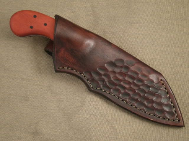

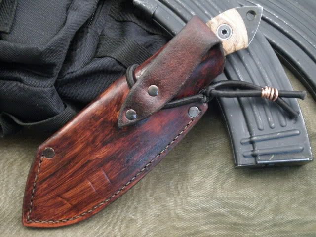

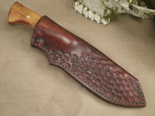

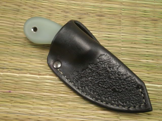

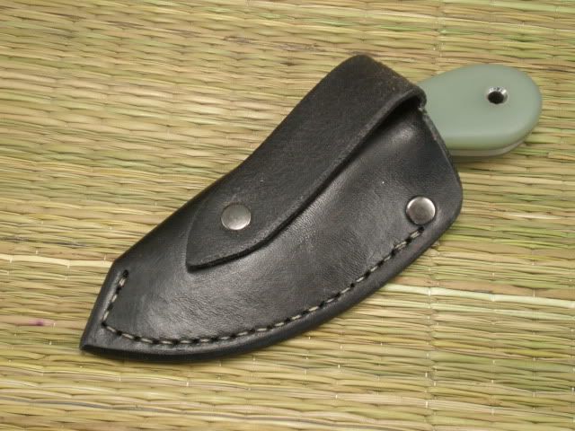

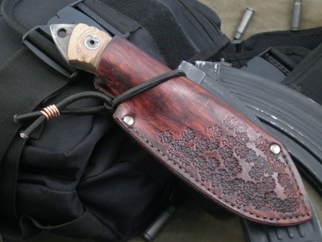

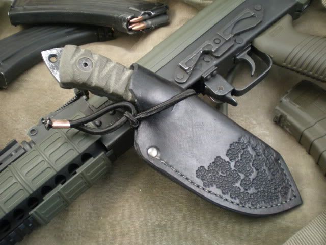

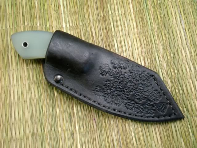

I wouldn't really consider my self a sheath maker, but here are some sheaths I have done recently.
Most are modest deep carry pouch style. Let me know what you think.

Hey guys thanks for the compliments, it is no trick really, I use the Eco flo dye from tandy leather which is kind of a gel.
When I apply it I use a medium wool dobber, and wipe it on from top to bottom, the "grain" comes from leaving streaks with little or dye on the leather.

Those sheaths are nice!!! The wood grain effect is great. Aesthetically the "waves" on the sheath ( pic #1) are really nice . I'm really envious of your talent.
