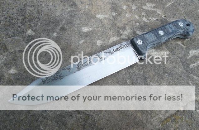

because with the black coating a bk9 looks like this
and WITHOUT the coating the bk9 can look like this
Pros of stripping- less friction, not so beat up look, modding, use mineral oil to protect against rust

look at my post on my bk7 gettin nekid... it'll detail the process for you... it will eventually show from start to finish making it mirror polished

@thrillbilly- Love the Mods you did to the 9. how'd you do the etching to the blade?
Strip the coating by using paint stripper. Most hardware or auto parts stores will stock it. Start by using a piece of sandpaper to break up the coating (just scratch the surface) and spray/paint on the stripper. Breaking up the coating before stripping help ALOT...Otherwsise you'll be having to do several strips. For putting on a coating again you'd have to use duracoat or ceracoat or something (heavy duty paint) Hope this helps man.
I too am new to the forum. I own a couple of Beckers & want to start some Modding. Starting with the BK9 Just finished stripping & was wondering if bluing the blade will inhibit rust?
Yeah, after blueing you must put on a good coating of oil or it will strt to rust. Etching the blade is pretty simple, blue it, put it in a bucket of bleach, take it out after about 30 mins (depends) sand it down and reblue...then sand again. Yeah I Know, not very through. This was posted by Clich I think for his BK-9:
