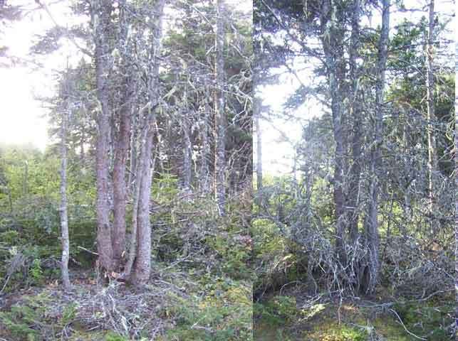

This is a before and after picture of a really rough patch of wood. When trees are very crowded and the libs die they go extremely hard and chopping them becomes impossible as they won't cut cleanly and they just fracture. The best method to cut them is to actually beat them off with a stout club or the back of an axe. If you have to cut them off then cut the tree down with a saw and then limb them from base to tip.

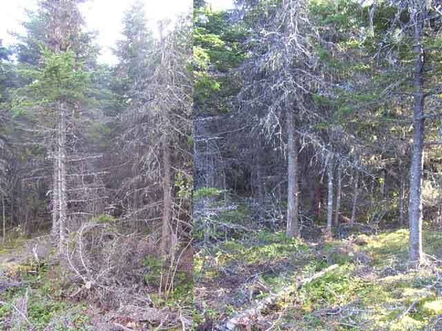

However I sheared them in a straight line towards the base using a heavy wrist snap and elbow drive. This was done as a worse case senario as in how would the blade perform with someone fairly aggressive without much knowledge. Mears talks about this in one of the episodes of his tv show where he uses a martindale golok on such wood and notes that you don't want a fine edge because the wood is too rough. Here is another patch :
It only takes about 10-15 minutes to clear out those little spots and remove the debris. I did this for about two hours. No damage to the edge was visible by eye, later it was checked and no damage visible under 10X mag. It could still slice newsprint but was catching in a few places. The edge bevel has a heavy convex grind, it goes up to about 18 degrees in the final 0.025" and quicky sweeps back to about 10 degrees. The knife used was the large bowie described here :

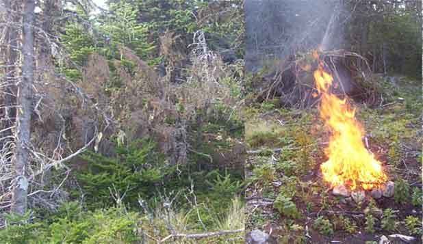

The edge angle is a bit high for what I normally run so I am still not convinced about the performance as I generally run about 14 or so for the final bevel on most of my knives, but I generally avoid the type of work done here. I definately am convinced that the performance is there to take the edge down though. I also spent some time carving and splitting and collecting brush to make a fire. I was doing some time trials on wood to see how long a flare would be produced from a given volume of wood.
This shows the type of wood and the resulting flame, this is instant, meaning those boughs will produce that level of flame with the right tinder basically as soon as they are lit. About a foot of the boughs produces about 5 feet of raw flame and only lasts minutes.
