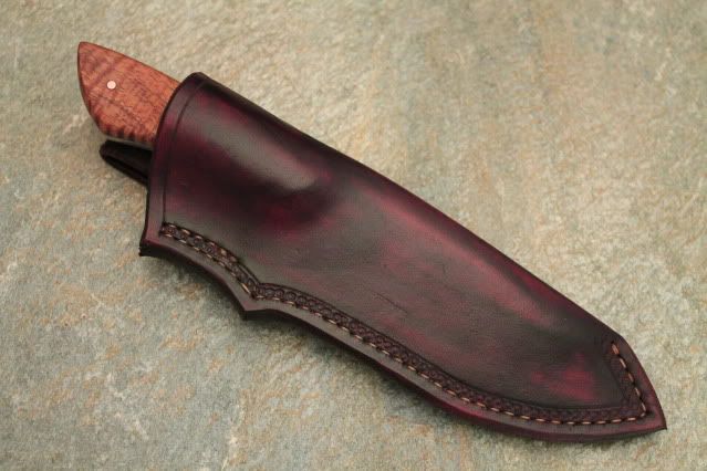

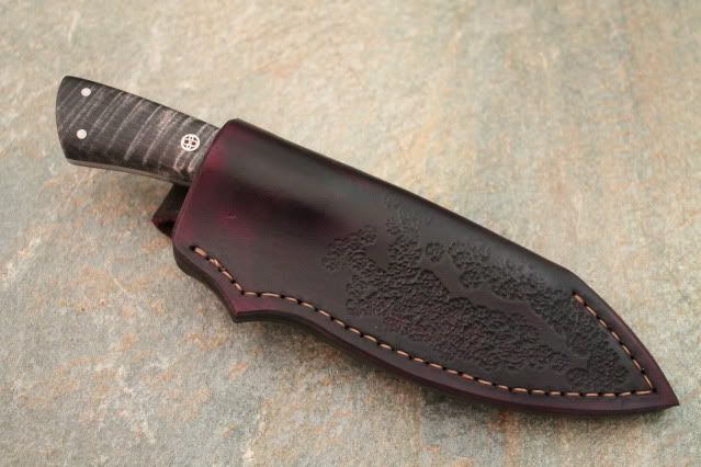

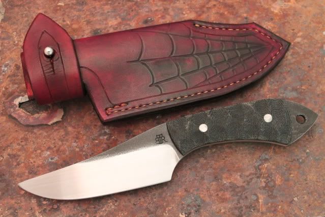

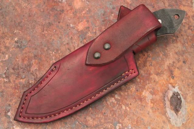

Here are some recent sheaths I have finished up. All comments and criticism is welcome!
You are developing a style of your own, and I applaud that! Well done!
I see rivets on a belt loop, one caution that I bet you already do but, make sure those are covered on the backs. Nothing worse than that tale tale rub line on the blade of a well finished knife.
Otherwise I like what your doing. :)
Very nice, Ben, and as Dwayne states, you are developing your own style which is a requisite to recognition. My personal opinion on rivets is that they look nice on Levi jeans---Sandy
Thanks guys for the input! I know, rivets are kind of a faux pas for you leather folks. :)
My problem is since I hand stitch these, and pre drill my holes for threading, it can be tricking stitching the belt loop. Any suggestions are welcome!
Sew the loop before you glue the main seam.
