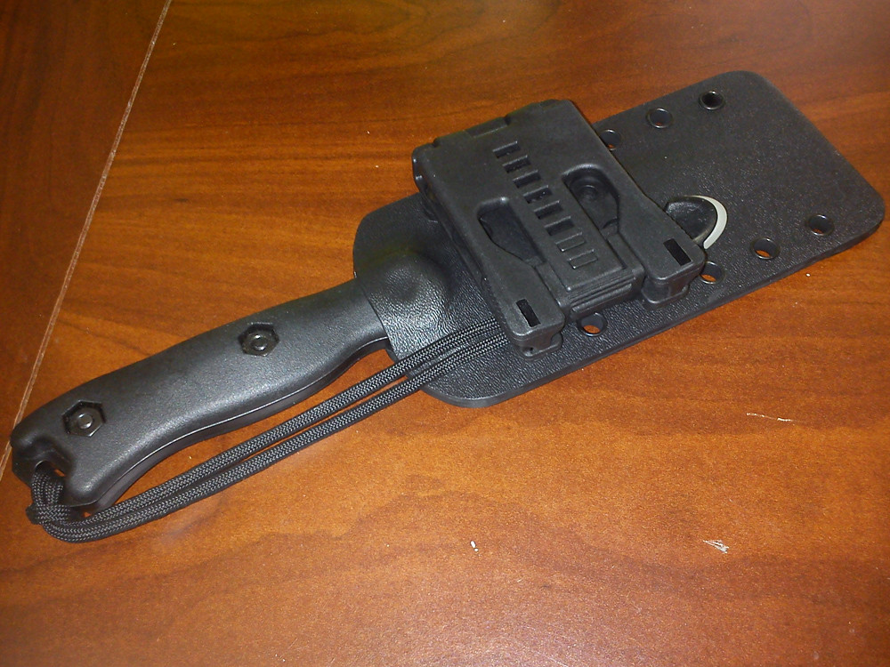

Deciding that I had little patience, I decided to modify my temperatures and see what I could do with more heat. I was very pleasantly surprised, and got the most detail I have ever managed on Kydex to this point. For 0.093" kydex, 275° for a few minutes worked perfectly, so much so that on my Becker BK16 I could see the transition on the grind at the saber area. Truly amazing. I will post up pics once I track down the camera the missus ran off with.
Glad to hear you got the results you wanted. I still fight the urge to remove the sheath before it's cooled all the way. I now set a timer and walk away from the press.
I was going to wait until I finished before posting any pics, but here is a pic of it as it is now:
Still need to cut off the excess, put a couple holes at the tip end, and set all the eyelets and polish the edges, as well as shape the mouth of the sheath. Coming along nicely thus far. What a difference temperature made in the detail I was getting out of it.

Here are the results of my first attempt after I got the temperature settings adjusted.
I still need to do a little shaping of the mouth of the sheath. Other than that though, it works. Very happy with how it turned out.
