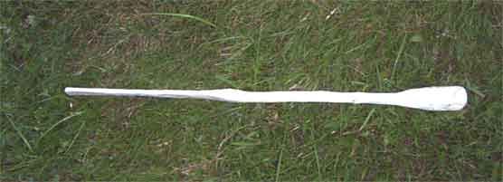

I then repeated this making a spatula, which is very similar to a spoon but jsut much easier as you are carving a flat and not a hollow.
The handle is thin as there was insect damage but it only has to turn foods so it doesn't need serious strength anyway.

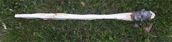

A digging stick, basically a flat heavy spoon, with a pointed top to give it more pick function.
It easily goes through some sod and pops up some decent rocks, saving the edge on the Mora for easier cutting :

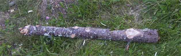

Starting off with a stick :
You chop it to shape with something suitable. Here a Bruks Wildlife was used. This was a piece of knotty pine, there isn't much worse wood to use to try to make something out of. The wood is soft and weak and full of knots which make it very difficult to carve and it is prone to fracture. To clip off the knots, lead with the extremes of the bit, the toe or the heel. You want to work very hard with well controlled impacts.

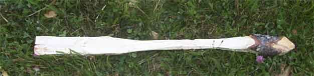

You first just plane off the head, basically chopping the axe into the wood and then turning it to make the cuts run vertical. You then cut out the basic handle by going in on a 45 under the handle and then going up to the head and repeating. The cuts under the handle prevent it from splitting off. You first frame out a very square looking object. This only takes less than five minutes, and most of that was wasted removing the knots.
and a decent taper :

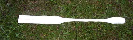

You can finish the project with the axe, but smoothing out the handle and refining the blade is much more efficient with a knife. I used the same Mora in the above here again. The axe cuts pretty much the same on woods because again the edge is almost the same. However the blade is much lighter in hand and much easier to turn and refine the handle.
It isn't actually any more productive at this stage than when it was just cut with the axe. It just looks nicer. You can finish it by sanding and applying a coat of linseed oil. This wasn't done here as this was a demonstration piece I did awhile ago for my 10 year old nephew on basic wood working.
You can do this in less than 15 minutes with the right tools. It takes far longer if you want everything smooth and symmetrical. It is much easier if the wood can be split well, but that was way too knotty. On a larger piece you can make it easier to cut out the handle by sawing into the wood at intervals which makes it easier to cut off the waste. Mears demonstrates this on TV. The local woods are not however hard enough to make that productive.
