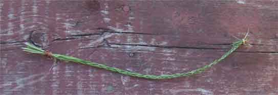

The H1 from Fallkniven is promoted as a hunting knife, but it makes a solid wood working knife. While the stock is very thick it has a high convex grind which tapers to pretty much a micro-bevel of a secondary edge. It cuts very well, close enough to the Mora 2000 that I would consider it in the same class for most woods. I am in the process of building a fairly large lean-to now and decided to make it more permanent so I am actually lashing some of it together. I usually use spruce roots, just split :

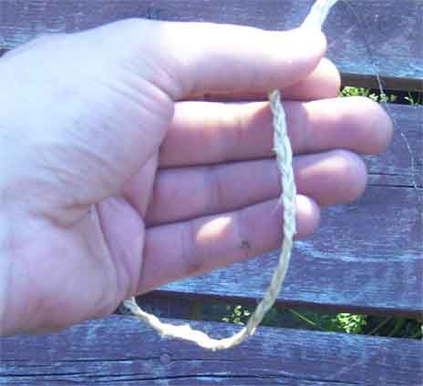

I have braided the splits, more for recreation though than strength :
though it is useful on weaker materials like grasses :
and on smaller roots. I lashed the knife to a stick after carving it to shape :
It works much better then for light vegetation just having much better reach and speed :
That wrap won't hold on woods though, even alders will break it readily. A heavier wrap done on very fresh roots will hold though. The H1 also works well as a splitter, and allows techniques like this :
