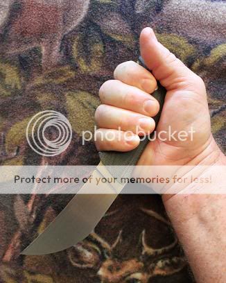

I don't thin this is Janich's grip style, but I prefer a grip like this which presents the point towards the attacker at all times-
I think Janich's grip style is like this-
