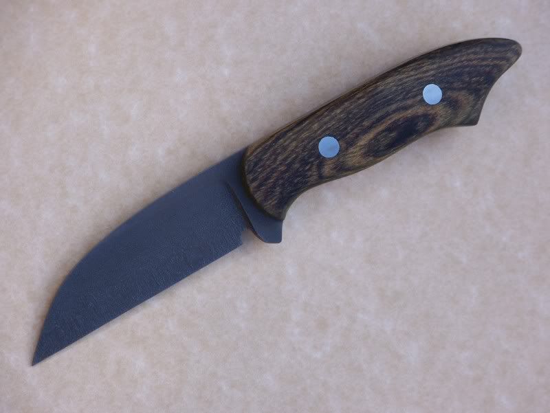

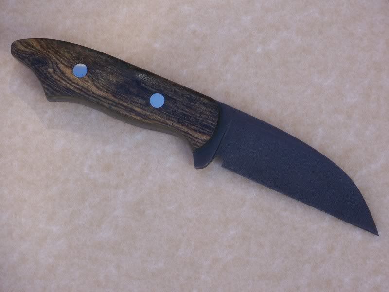

Something a little different from me
Feb 10, 2009
983
The blade is D2 etched (( it's about the same color as a Ruger hand gun)), Blade is 3" and OAL is 7", with a bocote handle.
Thanks for looking, Art

that Is a great looking knife!:thumbup
I like that a lot, great work!
Nice grind and beautiful harmonious shape. Congratulations and thanks for sharing. :thumbup:
I foregot to say I high buffed the blade to bring out the orange peel in the D2 to give a damascus look or texture to the blade.
Very very nice Art!!Just curious ...how long did you leave that in the echant?I thought I would try that on some ats-34 on a knife I"m building.
I don't know if it will work on ATS34. This blade is D2. I etched this blade twice, and I just used a Q-Tip to put the etch on and keep rubbing it for about 3 or 4 minutes.
