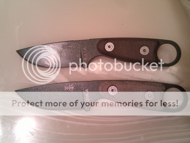

I'm looking for something - besides a sharpmaker- that will help me put a good edge back on a couple of my knives. I've noticed, for me at least, that the sharpmaker is good at maitaining an edge but if the edge gets really dull it doesn't work so well. Should I look at a Lansky? Any other recommendations (besides freehand)?
For example..my Izula came with a GREAT factory edge but I can't get it back to it with the sharpmaker.

I don't see how you are having issues with the SM on the Izula. I have 2 myself that are easily done on the 40º setting. In fact, I had a new one come in yesterday and within 15 minutes or so it was hair whittling sharp. Have you tried the sharpie method? When was the last time you cleaned your stones? How much pressure are you using? What kind of results do you get on your other knives? Have you watched the DVD that came with your sharpmaker (assuming you have the 204 version)?
Mark your entire edge like this.
You are doing the ACTUAL sharpening when you get results like this. You want to only remove metal from the very edge. When you get the results, make sure to use LIGHT strokes when you get to the flats of the whine stones.
Went through 75% of this cardboard and was dull as a butter knife.
Back to hair whittling sharp in about 10 minutes from the butter knife dullness from the previous picture.
Both of these can whittle hair.
Give your sharpmaker a chance before you give up on it. Since you already have the system, you might as well learn how to use it to your greatest benefit.

Ok...tried the sharpie method. One side of the knife worked great..meaning as I sharpened it the marker on the edge was scrapped off. However, on the other side of the knife the marker is scrapped off ABOVE the edge. So there is still a fine line of marker on the edge of one side of the knife. So for some reason I'm not getting the edge of that side of the knife sharpened. ???
***not that is should matter in regards to sharpening but I tried this methond on a RAT-1 instead of the Izula.
if its hitting high on the edge, the angle the blade is held at is off and you need to correct it and try again. the factory edge grind being off could also be causing this.
so then each edge could be at a different angle...which is where my problem might be?
Exactly newknife, every knife comes with a different angle. You can make it right with the tools you have, but it will take time.

As others are saying you are only sharpening 1 side and the other you are "rebeveling (removing the shoulder). This will explain why you aren't getting results. You need to either compensate for the other side as richard j stated earlier or you need to rebevel that side until it matches the SM angles. On the SM this will take some time depending on how far away you are.
