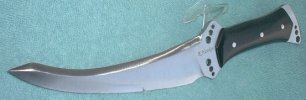

Way different from what I usually make thats for sure. Might call this one "Lucky 13" just happens to be the OAL.
This little monster drew blood (My own) before I even put an edge on it. It has a full convex grind straight to zero on both edges. It will cut coming and going thats for sure. I had to wear gloves while doing the final finishing to keep from being cut again.
Specs:
Blade is 8" tip to front of guard
13"OAL
Tripple quenched 3/16" 5160 with a scotch brite working finish.
Polished Black linen micarta W/ Nickle silver pins.
"Hey you got a problem with that!!! Step out of the light and we'll talk about it"
