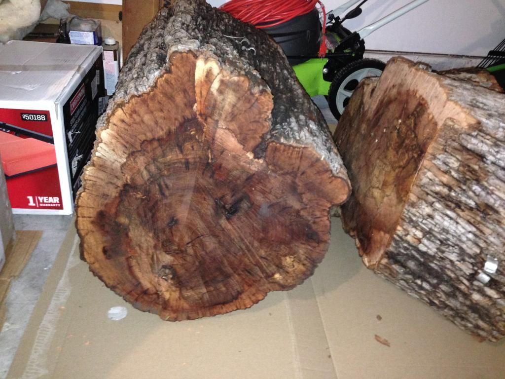

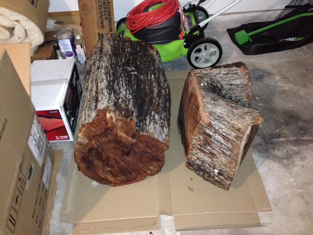

Was inspired by ndog's post and went and picked up some wood I saw just lying around for my "workshop" at the house.
Big piece is a good 30" long and 16" diameter. Looks like maple to me.
Any suggestions on how to level the ends? Chainsaw followed by planer and belt sander?

great looking log and yeah just get a sander I think the sander takes off enough that you should be able to level it easy with a strong one.
End grain is tough to sand though, get some course belts.
If it's to far out of being flat and relatively square to the world I'd use the chainsaw.
Course if the chain ain't sharpened proper it'll cut in a circle and might make it worse than it is too.

I'll probably just use it as a small table/pounding surface. I'm renting still so I doubt the landlord will like the idea of a forge on the property...
Playing around with the idea of turning the split one into some sort of two-seater bench type thing.

From what i have found the easiest way is to cut it with a chainsaw with a good sharp chain. Put the first cut flat on the ground and you can measure and make a mark all around the stump with a marker for a guide then cut it square. An aggressive belt sander will take off the rest. Try to make your saw cut without stopping and you will minimize gouges. A good sharp bow saw works too but its a bit more work. Dull blades of any kind are almost impossible to get a clean square cut. My stump here is off a bit and needs trimming as well. You might get a good double wide chopping block out of that "Y" stump. Cut a section through the crotch. Great find!

It looks spalted and if its solid and not deteriorated it may be some pretty desirable stuff for knife scales etc. If there is any way to slice off a small piece sand it out and wet it or oil it you can see what you have and get a better idea of what its worth. Thats what id do and if its some pretty stuff id go back and get some more. Corn patch is probably full of maple but its not so common in TX. At least not in my part of TX.
