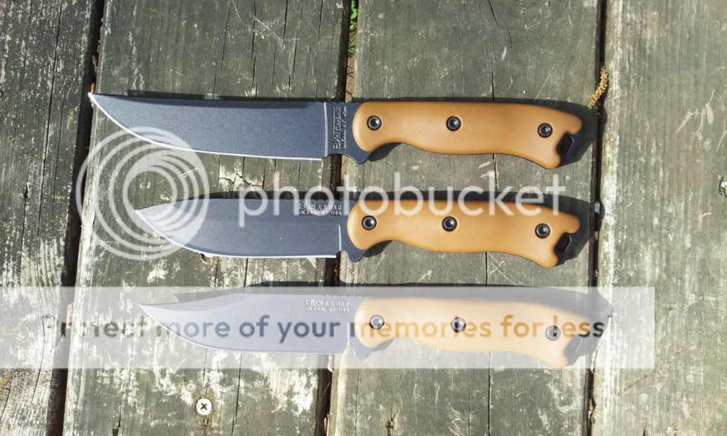

Just got these today, thought that I would share with ya'll and get some info, all in the same thread.
Notice anything different about these guys?

I mean I know you know a guy that knows a guy but they have no etching and are not form SMKC. So what gives Moose? And I WAS FIRST FOR ONCE!!! :D
Honoring the Mods. That's all.
One of the perks of the job, so to speak.
Moose
Those are rolled stamped, the coating doesn't seem to be the same as on the new ones, and the peanut butter seems to be a more orangey color (that one might just be the pictures though).
