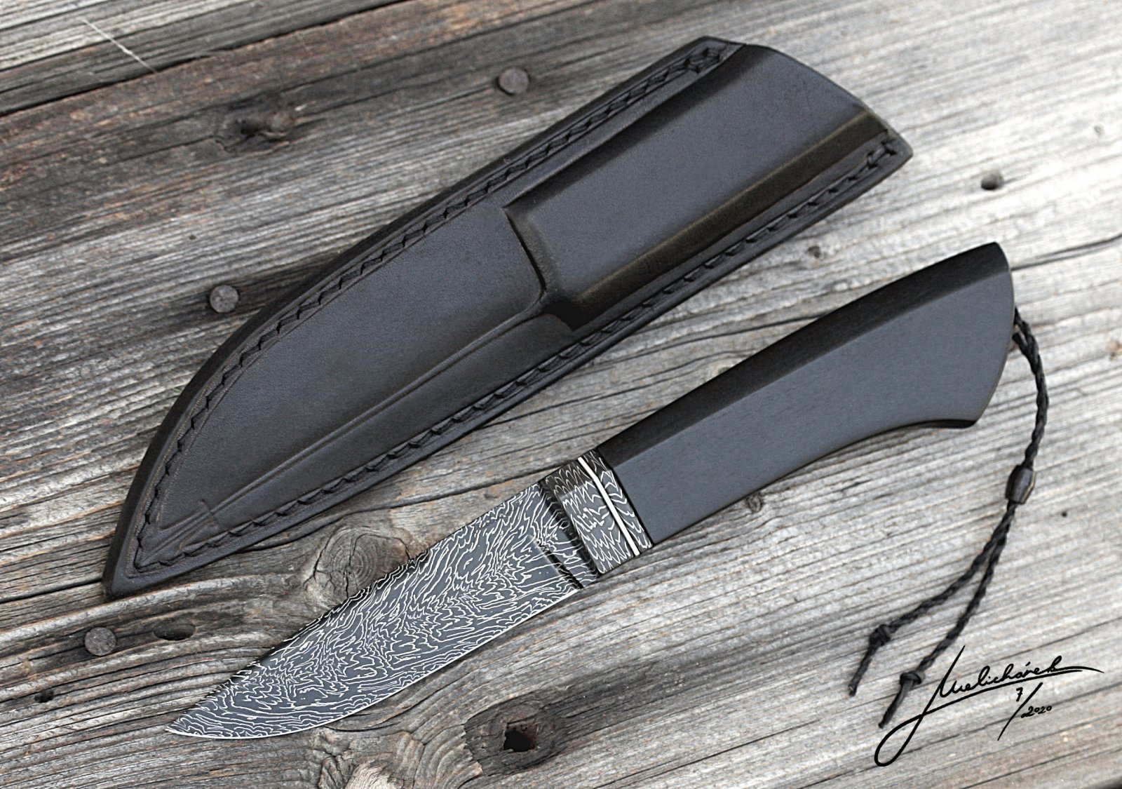

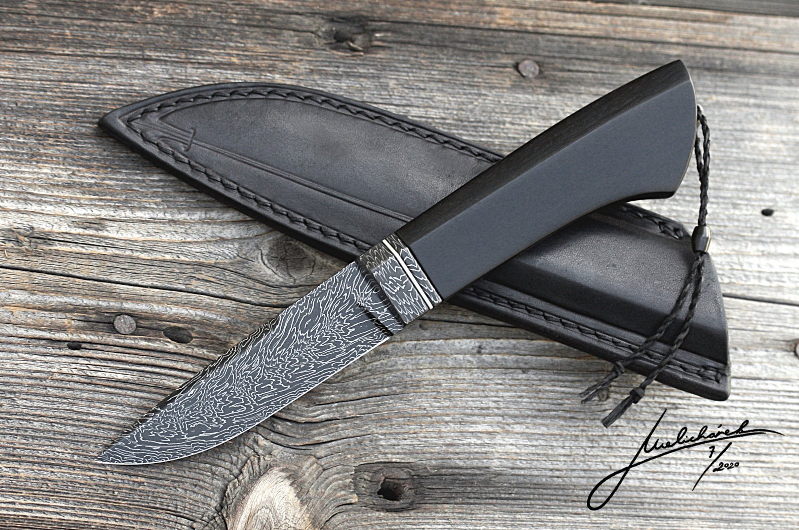

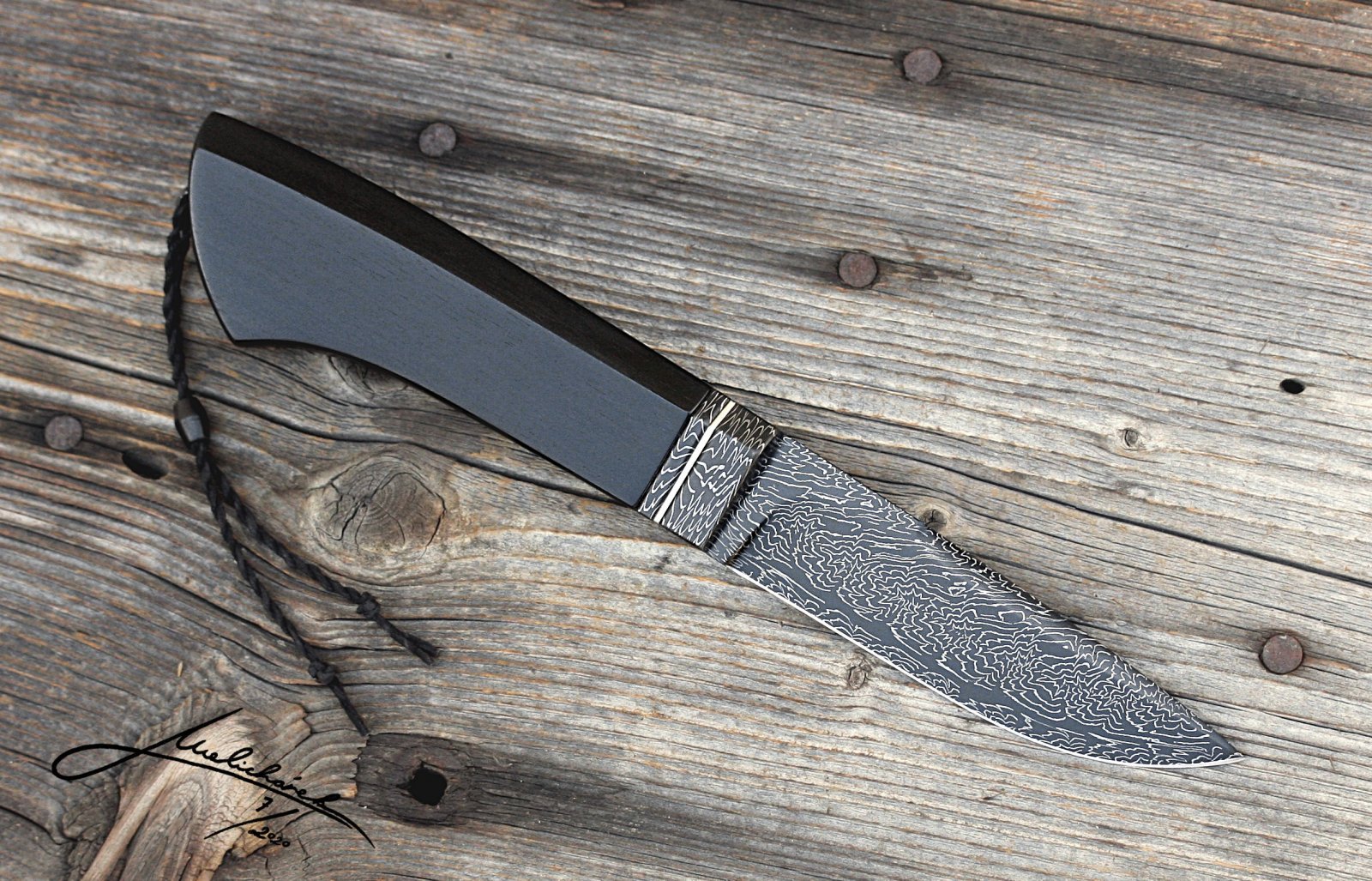

Hi everyone : )
Today I finished this dark , modern style "scandi" . I've made some similars before, but they are always different in the end : )
See you soon with more knives : ) bb Petr
SONIC

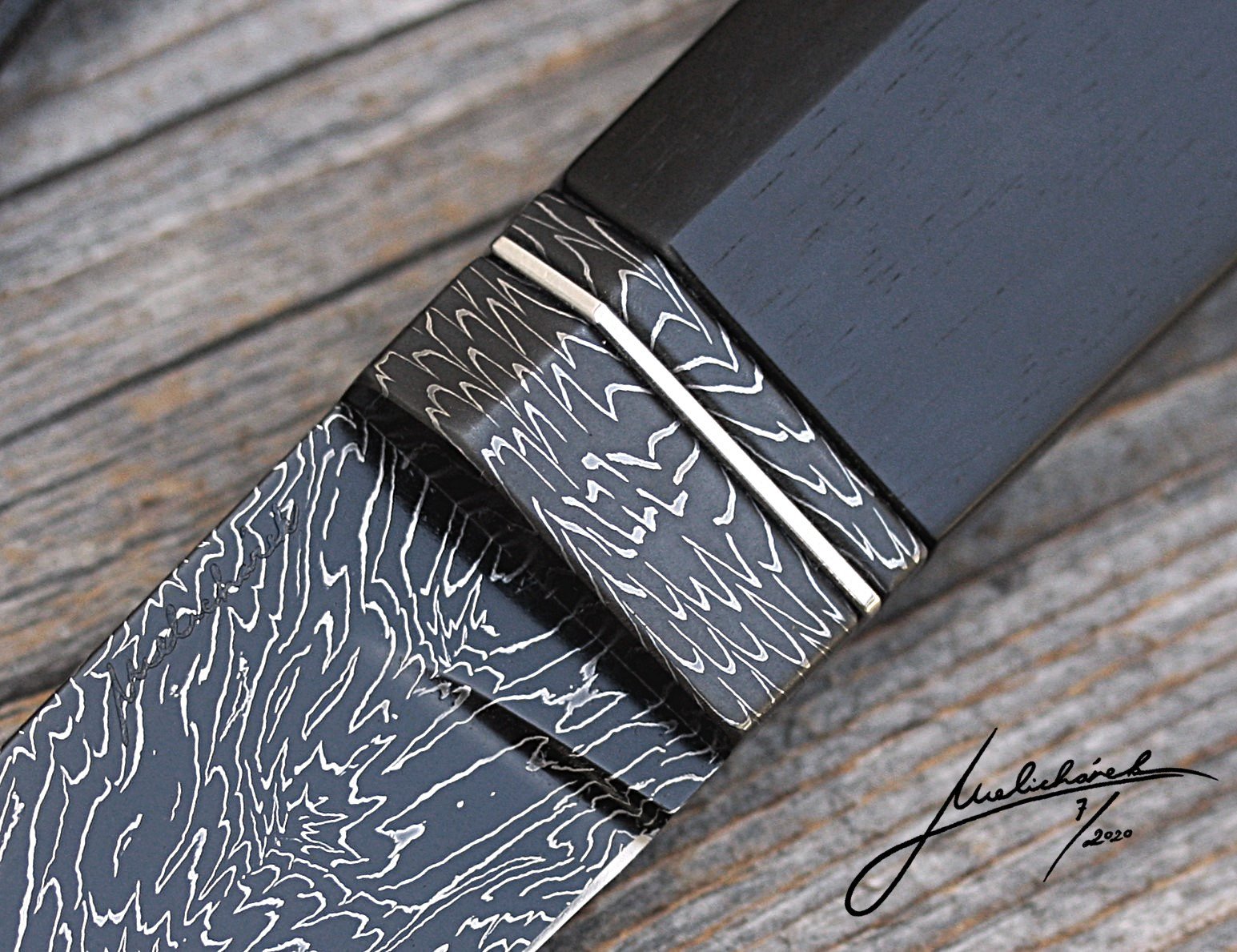

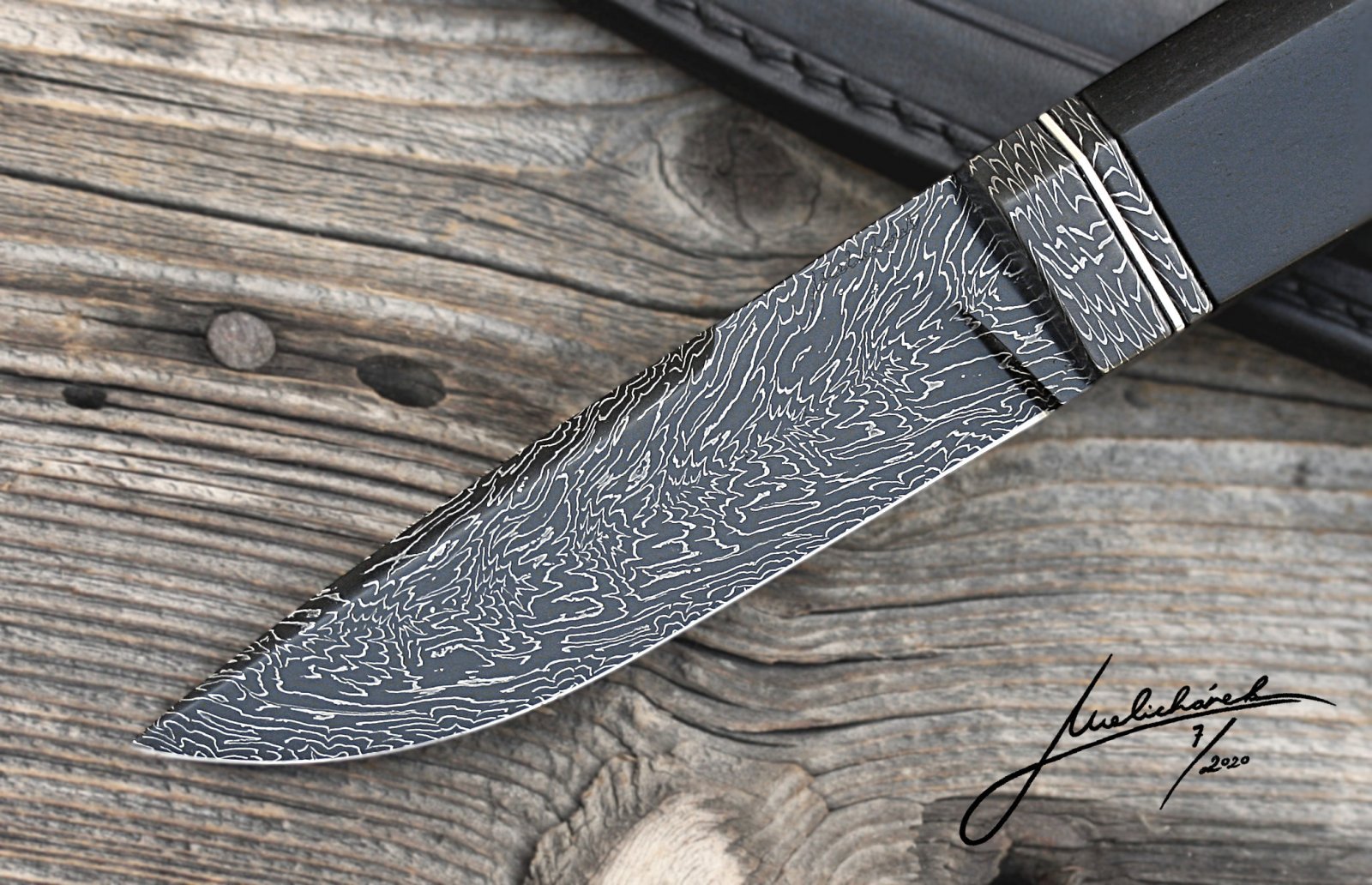

Blade - multibar twist damascus steel 1,2842 (O2) + 75ni8 Uddeholm (15N20)
Ring - 1,2842 (O2) steel + 75ni8 Uddeholm (15N20) + stainless steel 1,4301

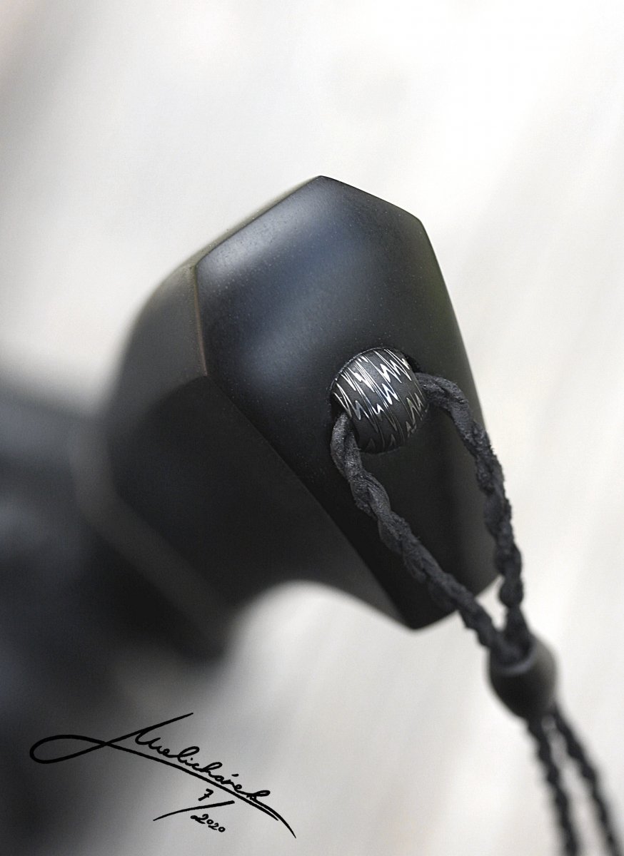

Handle - Ebony
Average length - 25,5 cm (approx- 10 inches) , blade -11,5 cm (approx- 4.5 inches).
Blade width at widest point 30 mm (approx 1.18 inch ) mm , blade thickness 3,7 mm (0.146 inch).
