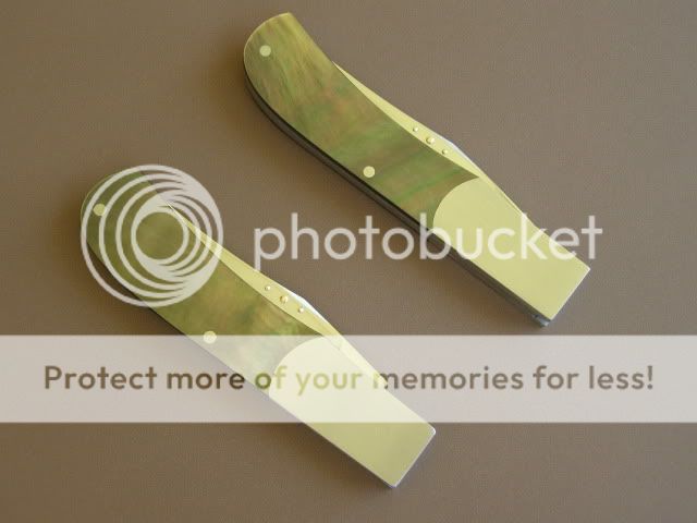

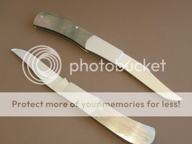

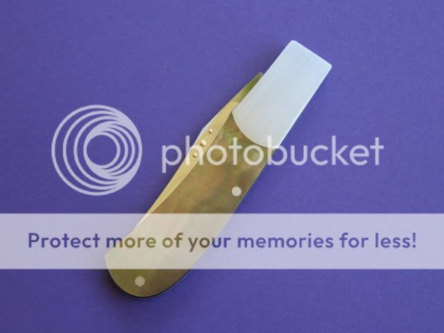

It's been a while but here's a couple of slip joints I just finished up. Let me know what you think. Ryan Minchew
These are not for sale.
Black lip mother of pearl handle
cpm154 stainless hollow ground blade mirror finished.
14k gold nail studs
relieved stainless liners
416 bolsters to be engraved my Mr. Ken Hurst.
Ryan, what's the closed length on these?
Nice pearl and an interesting take on the alternative to a nail nick.
Look forward to seeing what they look like after the engraving.
I also am looking forward to seeing Ken Hurst do his thing with these knives!:thumbup:
Ken
Thanks guys, these are roughly 3 and 5/8" closed and a hair over 6.25 open. I'll post some pics up when Ken does his stuff.
That knife looks incredible. I like the pearl alot. The engraving is gonna really set it off and make it something special.
Long bolsters aren't my preference, but that pearl looks very nice. :thumbup:
~Chris
Very nice... You don't see many knives with edges that aren't radiused.
Do you do most of your knives that way ?
I'm not much on engraving, but IMHO it will really add a finishing touch to those knives.
Thanks guys. I don't normally leave my edges this square or make my bolsters this long. I made long bolsters because that's what the customer wanted for an engraving canvas and I left the pearl more square because I'm afraid I would have lost too much color due to the color not being that deep. Thanks again Ryan Minchew
