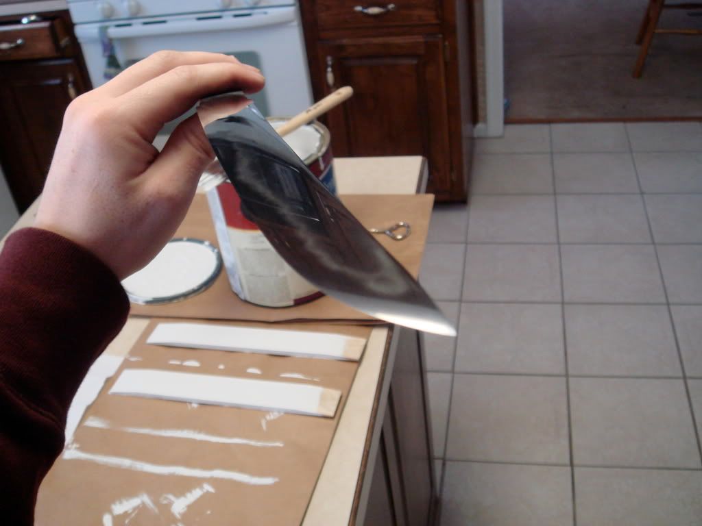

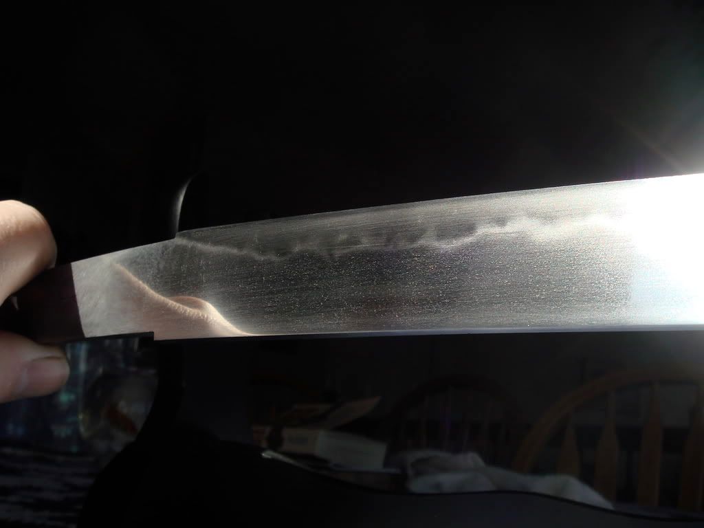

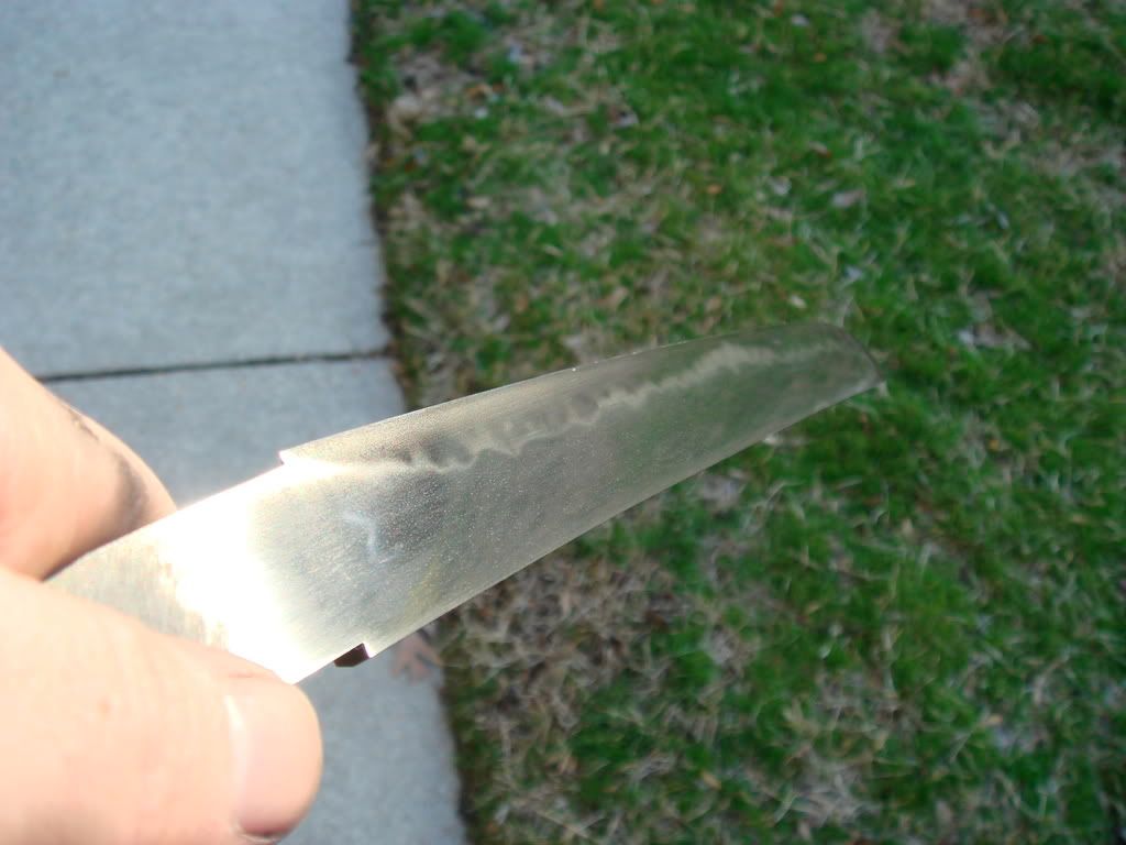

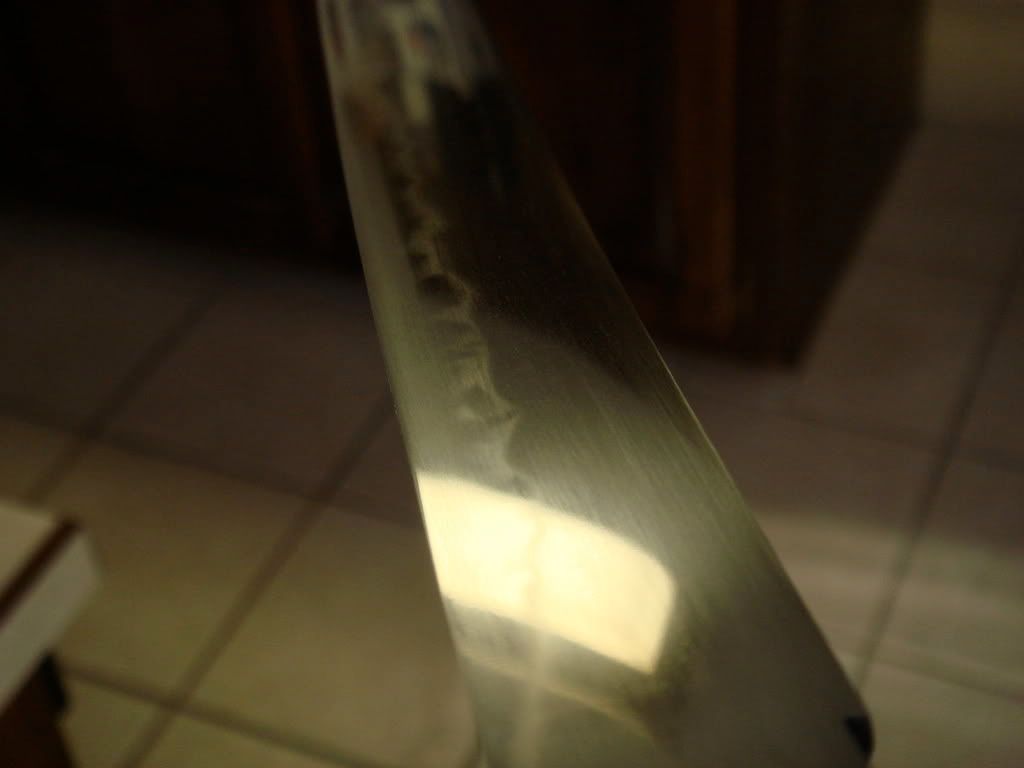

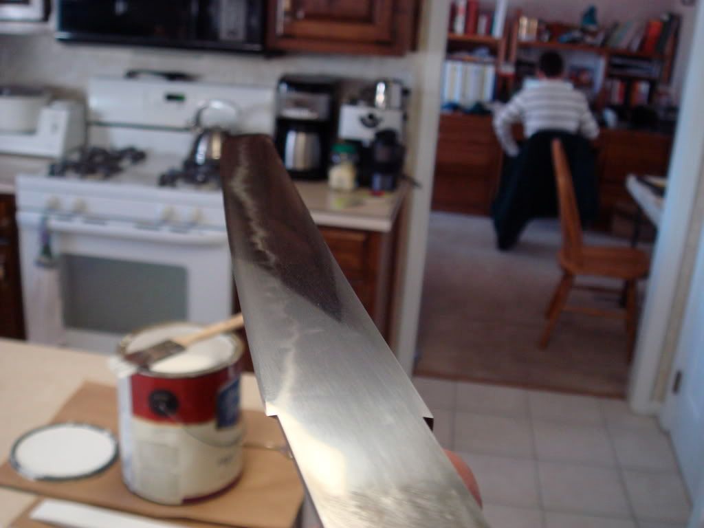

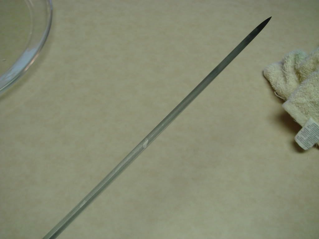

hello everybody
i feel really sluggish looking at all the posts by people like phillip patton who keep churning out all these gorgious peices of work.. so here is something i am almost finished with.
yes.. it is just a blade. i have everything else ready to go.. but i am finishing the final touches on it.
this is the first blade i have made since watching the walter sorrells hamon and polishing DVDs.. so that is where i got the help.
the blade is W1 and was quenched in water. the blade is 15" long, tip to tang, and the blade is about 10 1/2"
i left the clay really thin as the customer didnt want much curve. i have some pics of the clay if anyone is interested. also.. the blade was etched.. but i took it off.. the blade in the pics has no etching on it. it is prettier that way (in my opinion)
please let me know what you think
thanks for looking!
~Chris
