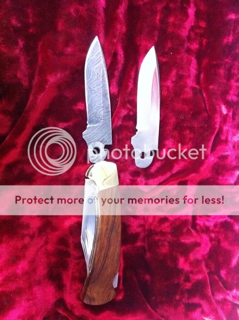

I have a handmade 1095 DP 112 and carbon Damascus DP by Grand at SNR coming in my mail (should be today or very soon) I will post pictures of. They are a little more costly but Grand does great work. So does sitflyer :)

Here's another source, Grand at Snake River Knives made these. I'm thinking the Tiger Stripe Damascus would look nice on an Ironwood Barehead. The steel blade is 1095.
I REALLY like Grands tiger stripe... That DP is beautifull Jerad. Thanx for that pic
