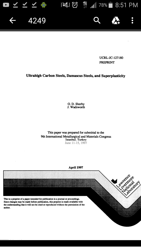

This paper may be of interest.
Yes, I read through that paper, quite fascinating actually, and our research with further the research of UHCS if successful.
