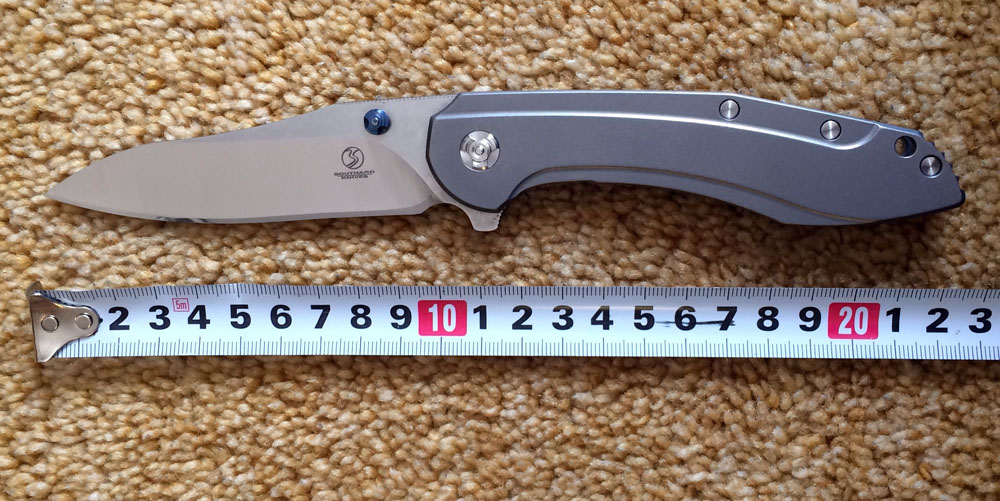

Specifications (in my measurement)
Overall length: 8.8"
Blade length: 3.7" (3.6" cutting edge)
Handle length: 5.13"
Blade thickness: 0.134"
Weight: 4.3 oz
Blade material: CTS-XHP
Handle material: Ti
Lock: Frame lock​

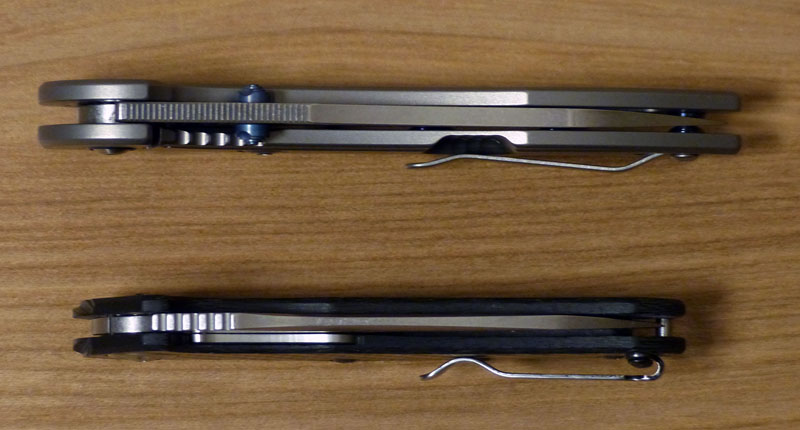

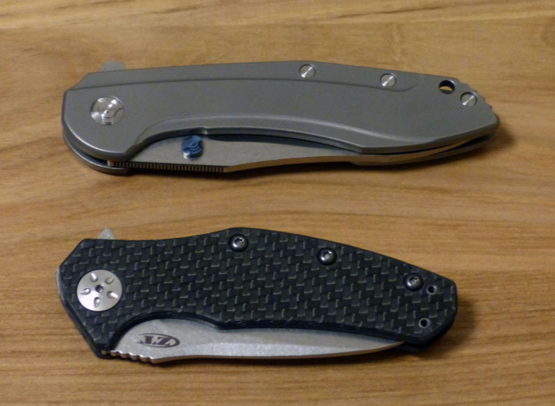

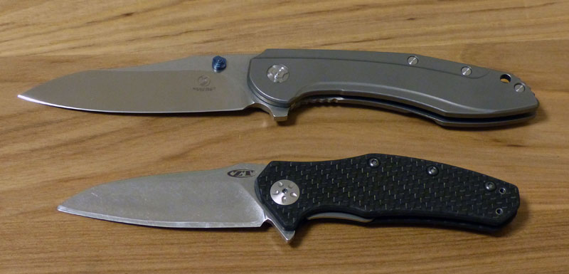

Being 5” when closed, it felt quite big as compared to my EDC ZT 0770CF at the first look. But with the relatively small weight/size ratio and the thinness, the knife feels lighter.

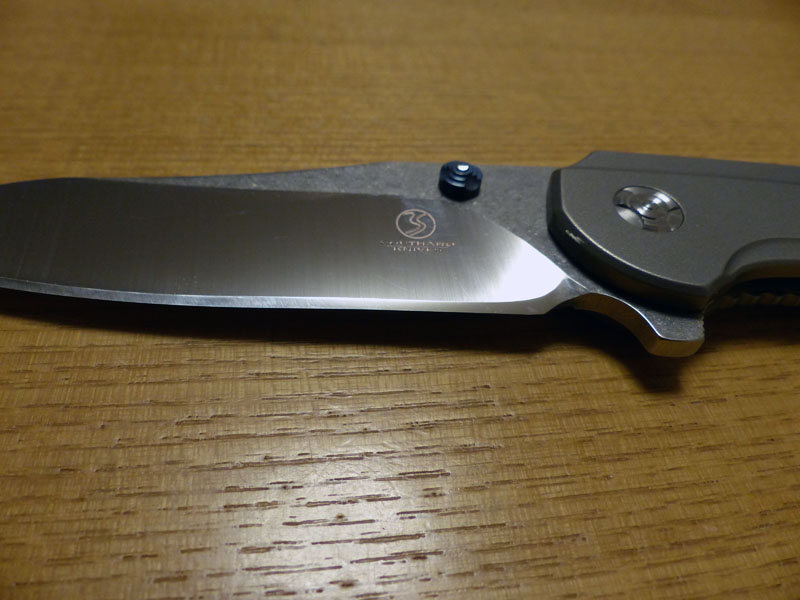

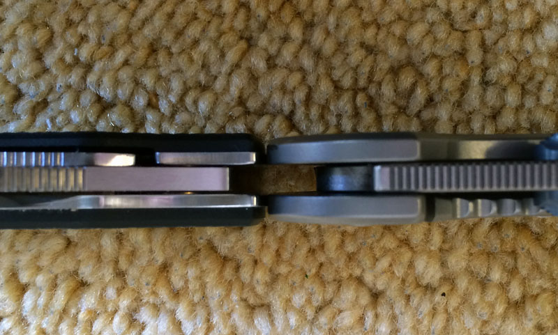

The overall fit and finish are great. No complaints at all. Dead on centering, no blade play, perfect lockup, and hydraulic-like operation.

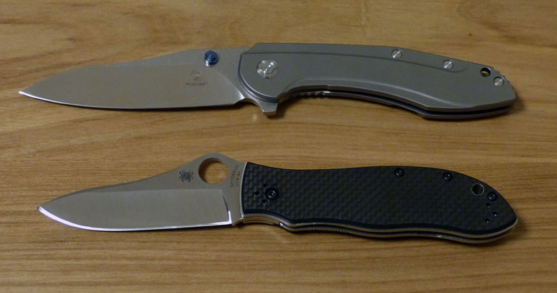

I can only compare it with production knives like Spyderco Gayle Bradley, as not owning other midtechs or customs, and think the finish is above all and the action is much much smoother than those.

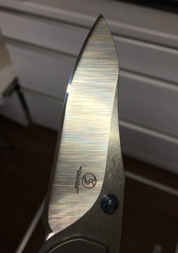

The blade itself looks great. I like the blade shape and the finish a lot. Very nice pair of stonewash and satin finish. The edge didn’t come very sharp, but I don’t mind it and will sharpen the knife over the weekend. I will see how the CTS-XHP edge develops as compared to M390 and M4 and holds.

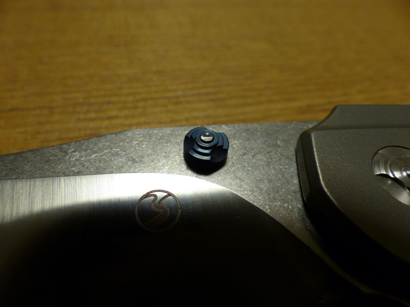

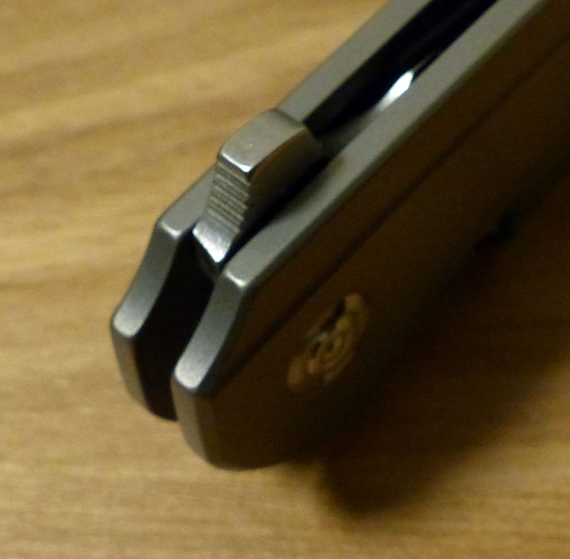

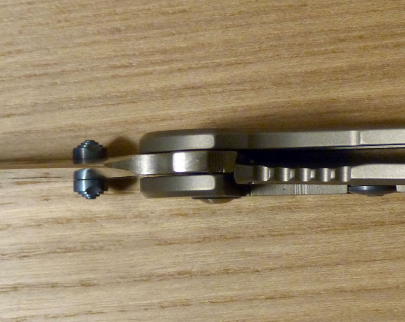

The flipper works perfect. Reliable operation from any positions. I am not sure about the thumbstuds. But it might be just that I am not used to it.
The detent ball holds the blade well. Mine is not too stiff nor soft, just right. Though, I realized that it could accidentally open when the flipper knob is pushed against the pocket liner. I almost stabbed my palm.

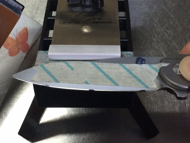

I've done the first round of sharpening on EdgePro Apex from #120 to #2,000 polish tape. My initial concern was the thumbstuds, but they didn't interfere the operation.
The initial edge angle was about 21 DPS, and I took it down to 15 DPS. The bevel is still pretty narrow, indicating the very thin ground of the blade.

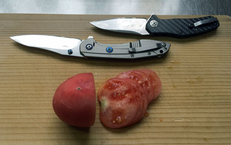

It sliced a tomato quite nicely.
Although the blade of Tolk is thicker than that of ZT0770CF (3.5 mm vs 3 mm), they cut the tomato equally good.

If mine is any indicator, the thumbstuds work great for opening - use the shape to guide you, both in terms of placement & direction of pressure.

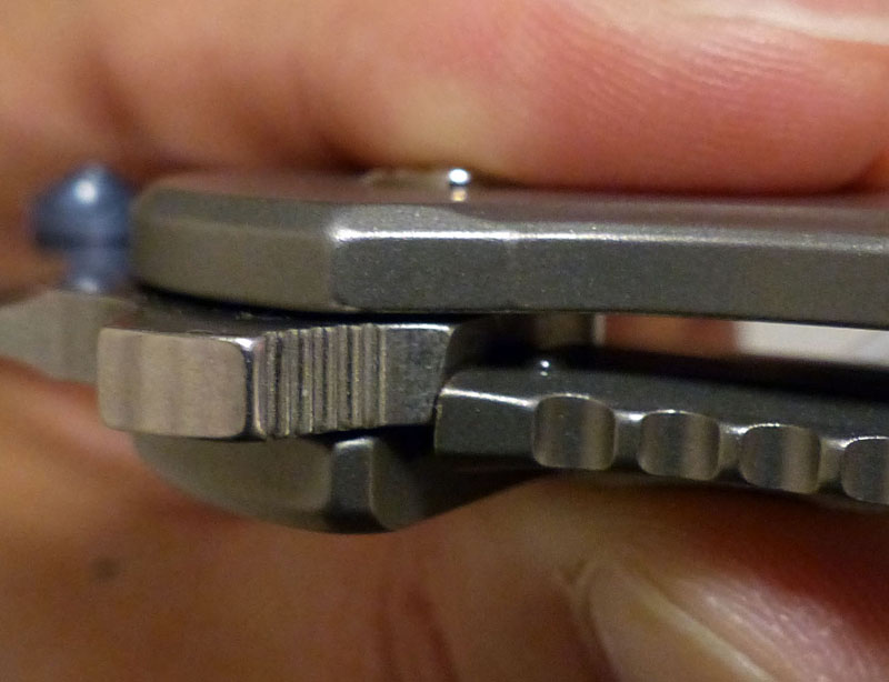

To break the detent, I even have to push both of the thumbstuds. Maybe the detent on mine is too stiff. But it may also be just me because this is the only knife I have with thumbstuds.
Miso
You have to push BOTH thumbstuds? Does it hurt your finger when using the flipper?
I have noticed that if I don't utilize the "notch" in the stud, I tend to apply pressure in the wrong direction; and realize it when the knife doesn't open properly. A slight variance makes a huge difference. It could be circumstance that my thumbstud is aligned just so. Alternatively, yours could be just a little off - try adjusting the direction in which you apply pressure. (Obviously, the usual warning to make sure you aren't putting pressure on the lockbar applies). Maybe a little lube is in order?
My comment about breaking the detent, then opening the blade, was in reference to a slow controlled opening. If I'm not trying to open the blade slowly, it's a fluid movement; and the blade flies open the way it does when using the flipper.
Enjoy your Tolk!
Enjoy your Tolk!
I had to use BOTH. But no. The flipper opening is really effortless.
After reading your comment, I played around with the thumbstud and tried to push it to slightly different directions.
I can now break the detent with just one thumbstud. It is sore a bit. I still cannot make the blade fly to the end with it......

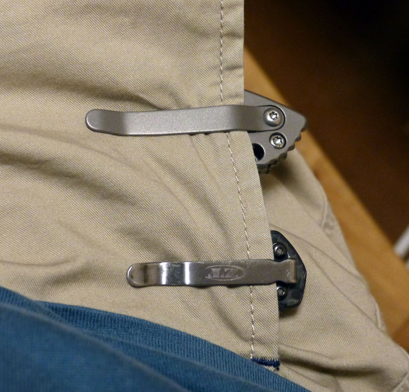

"Though, I realized that it could accidentally open when the flipper knob is pushed against the pocket liner. I almost stabbed my palm. "
Keeping that blade in tip-up position and pushing the clip "down" until it bottoms out on the lower seam of your pocket...will ensure that that you do NOT cut your palm with an accidental blade opening... The blade is safely "held" in position by the pocket. This is my EDC; the Southard AVO...
Right. I guess I need to change my habit.
I wish Brad Southard makes some Avo again.
Miso
I have sharpened the knife a couple of times now and am happy with the edge.
In my subjective comparison, M390 takes the keenest and aggressive polished edge with ZDP-189 as the close second and CPM-M4 behind them.
The CTS-XHP steels on Tolk feels more like CPM-M4. It takes a keen edge but not as aggressive as the other two.
I will see how the edge holds over time.

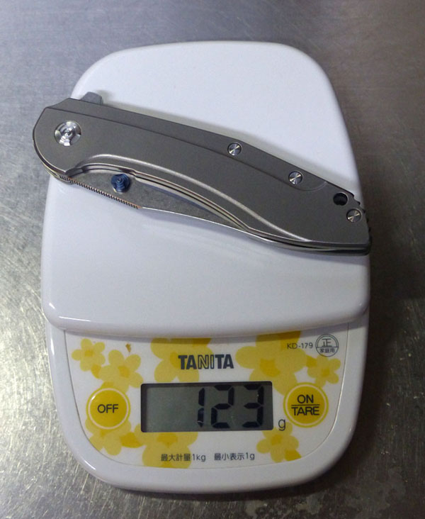

The list weight of Tolk is 4.7 oz (133 g). But mine weighs only 4.3 oz (123 g). I thought my scale is off, but it did spit out the right weight for Manix LW (82 g). So, it was a pleasant surprise.
Miso
hhmoore,
Assuming that you too have the 2nd version of Tolk, I guess this is the result of the improved design, which has not been reflected in the Southard web site? But then, Brad speaks of the new CF Tolk in his Instagram and mentions that the CF version is 1.02 oz lighter than the Ti version, that means the Ti version is still 4.7 oz.
I am a bit confused.
Miso
Mine is the first version. I don't normally weigh knives; but I was doing a comparison of a handful of knives for somebody.

I tried to further reduce the edge angle with EgdePro from 15 DPS to 13 DPS, but the thumbstuds got on the way.
The best I could get was about 13.5 DPS.
