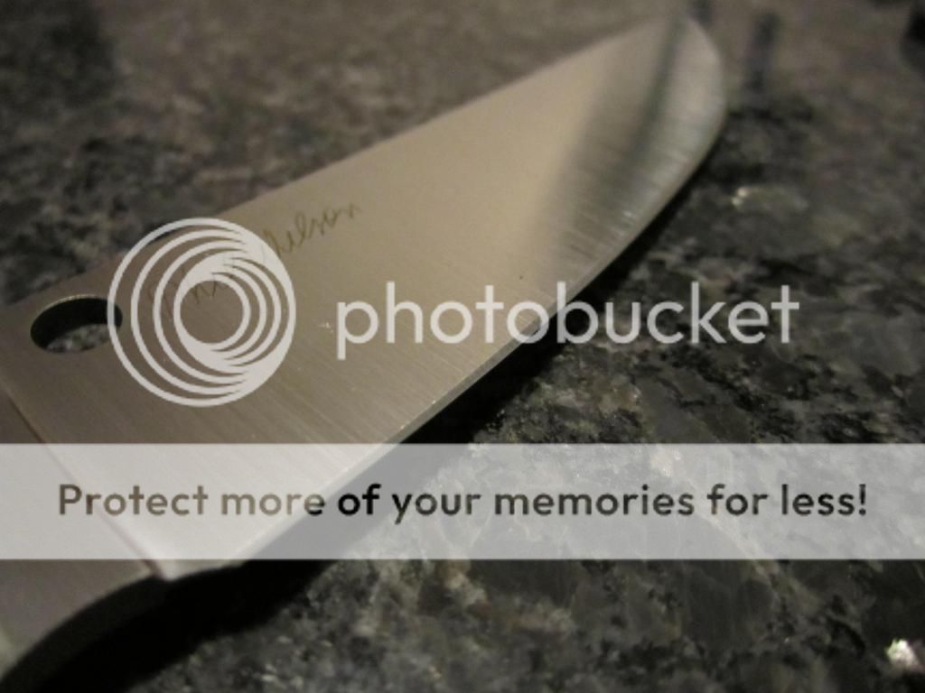

Heres the before pictures:

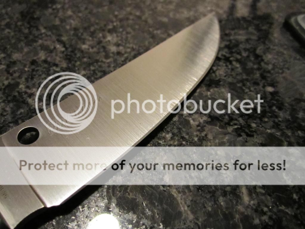

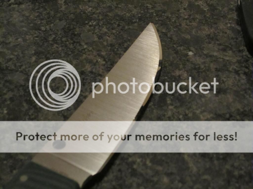

And the afters:
Cleanly slices Paper Towel , TP , Paper , sends armhairs flying , whittles hair , cleanly shaves the face...
The S90V is no joke , I found this more difficult than the S110V I've handled , the niobium content in S110V sure makes a difference in carbide size/distribution. Fun stuff.
