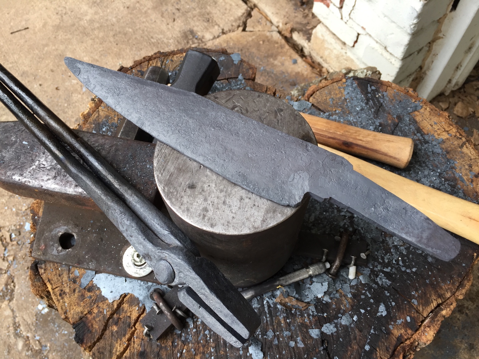

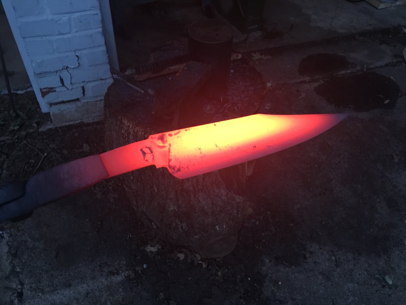

Finished forging this one earlier today, trying to get all my forging done before the weather gets much hotter so it'll probably get ground next week or so.
This was as forged.

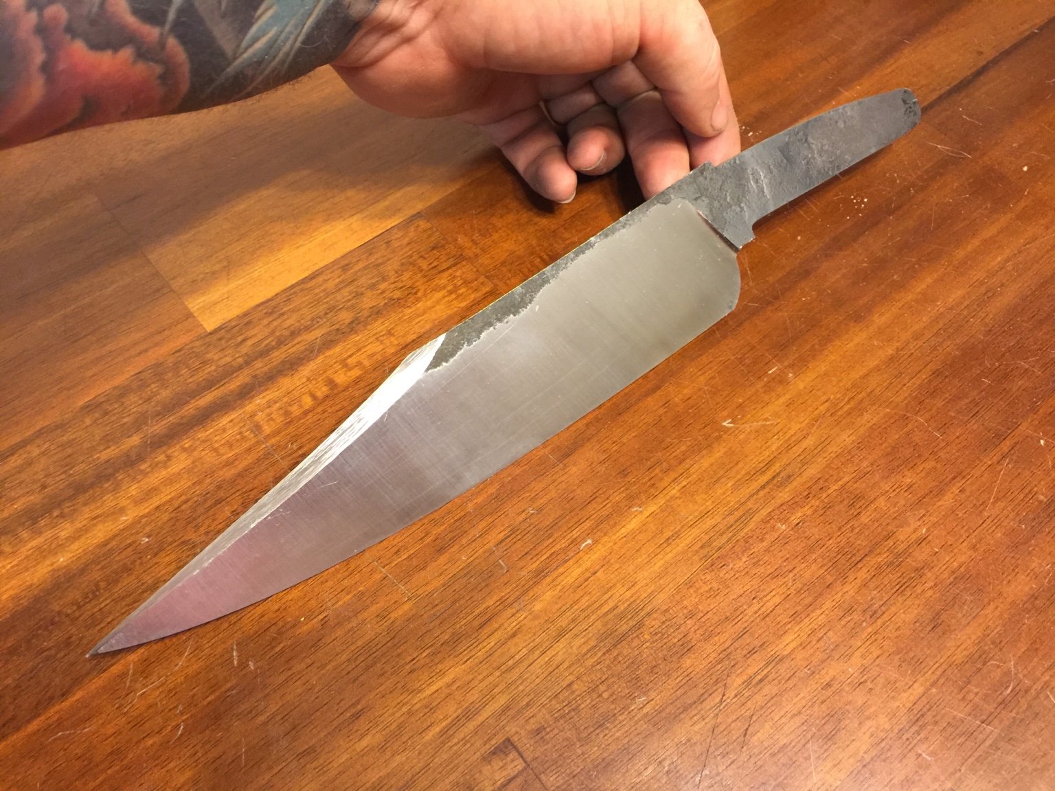

After cleaning up the profile on the grinder.
Finally managed to forge the choil behind the plunges to set up a nice plunge when I grind it.
It's looking like it's gonna finish out around 9.5" from guard to tip, and I got a decent distal hammered into it. Left a little material at the clip to get clean lines after grinding.
Steel is 80crv2, doing a stainless guard and some torched curly maple for the handle.

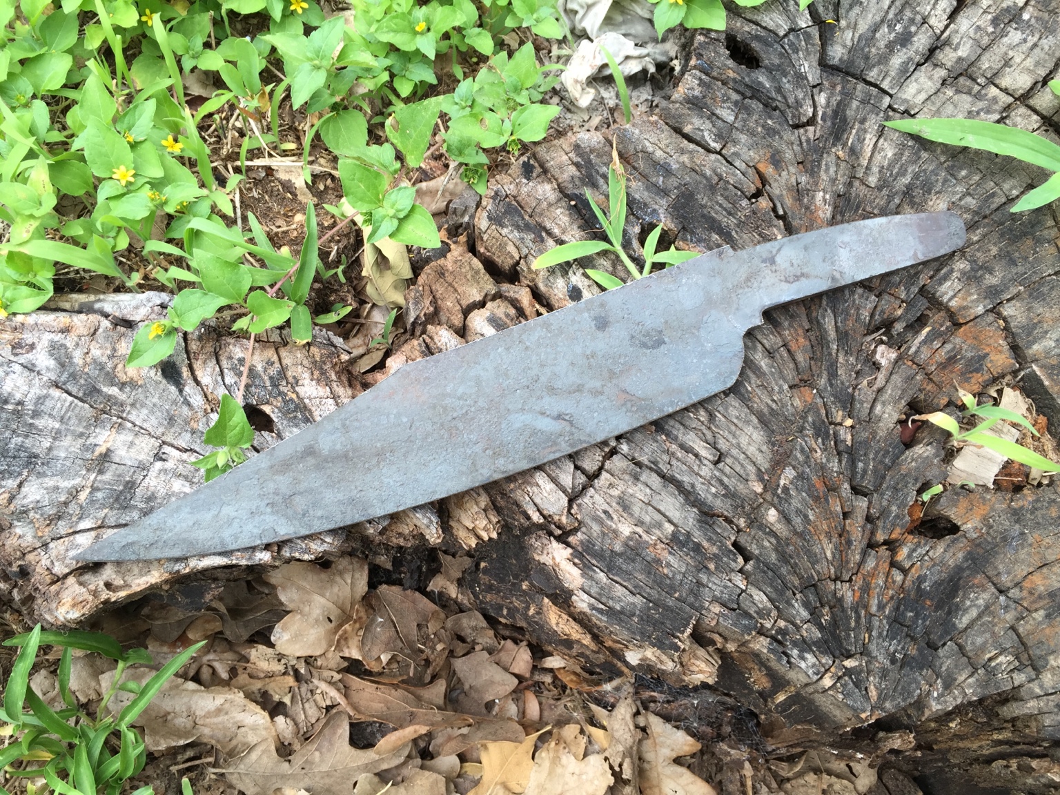

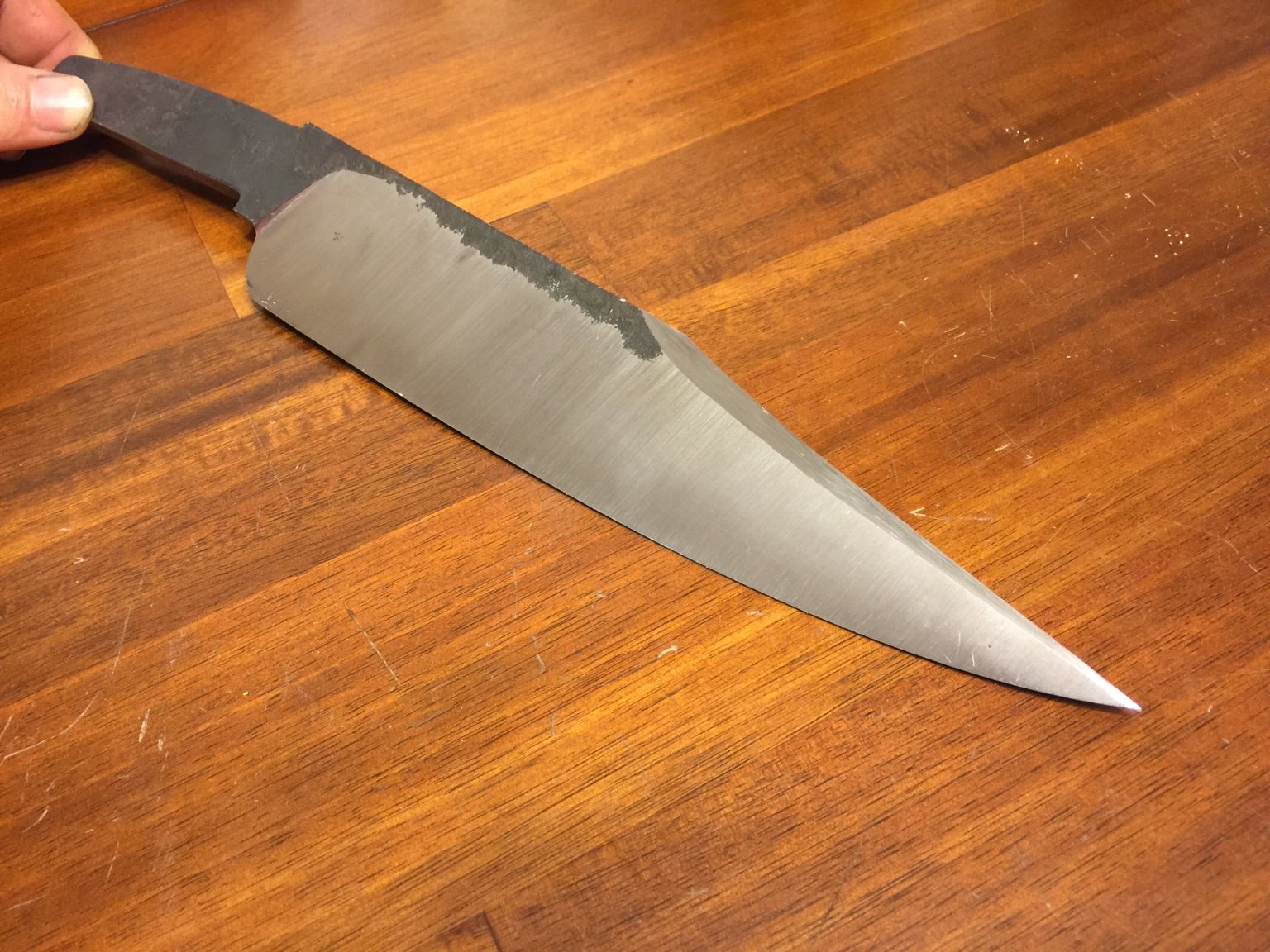

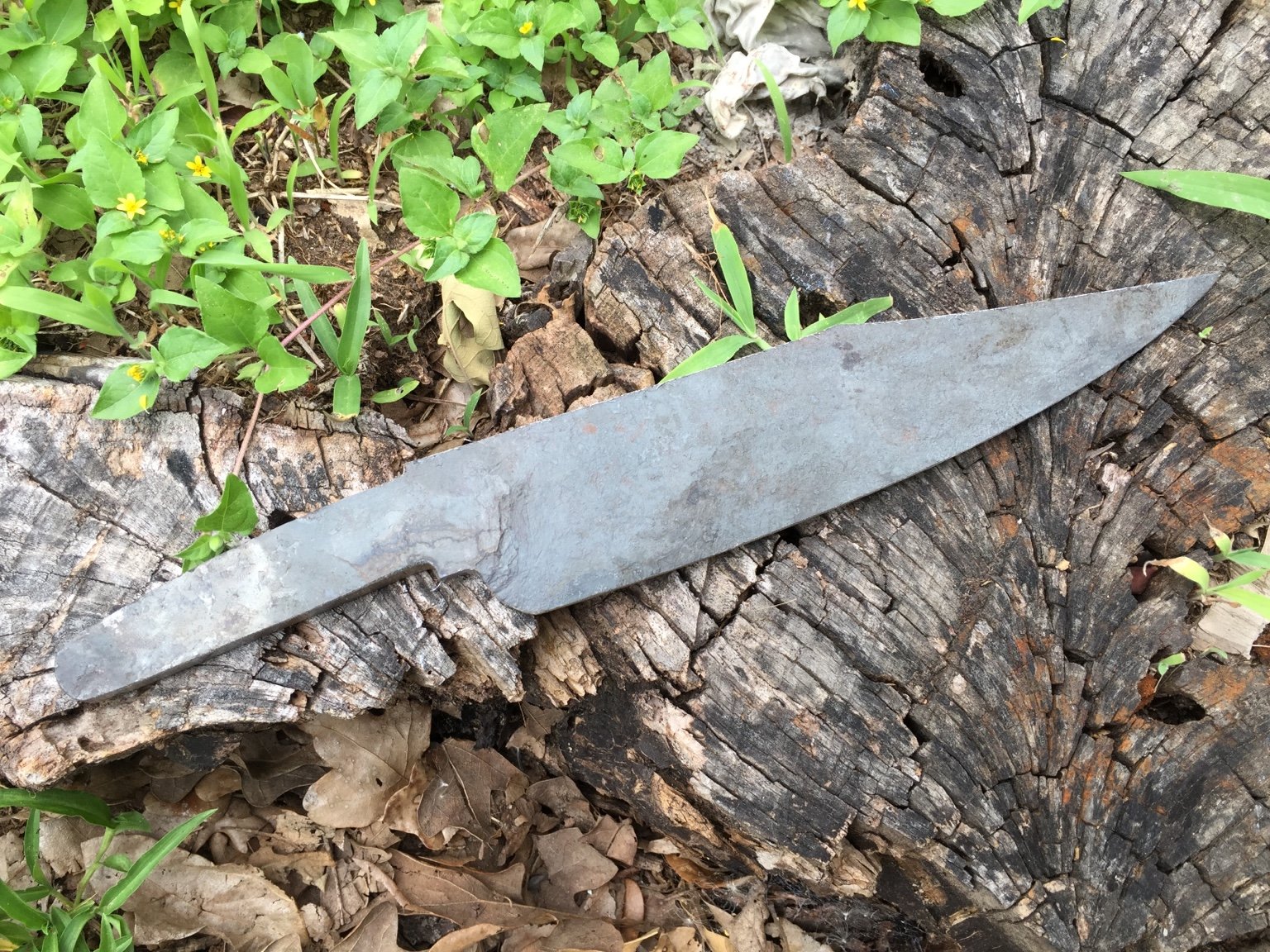

This was as forged.
