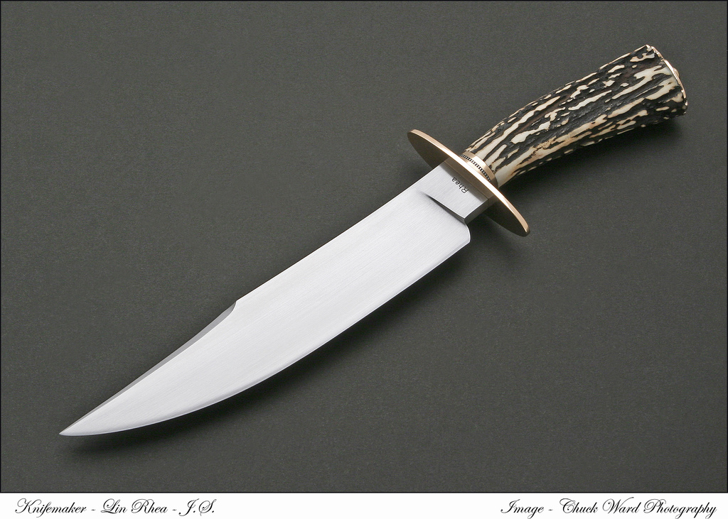

This Bowie is the first one I have for the Fisk Micro Show.
The blade is 9 1/4 inches of W2 steel. I got this steel from Don Hanson and His advice for heat treat was right on the money, including soak time. I edge quenched this one getting aquainted with the steel. It has a nice temperline similar to 1084 with a little more flutter. I tested the edge geometry on some Elk antler and it did very well. This is not the only one I forged from the W2, so it was a learning experience. I'm really liking it.
The fittings are Silicon Bronze and Stainless and the handle construction is Through Tang.
The Sambar was a little rough and would not be comfortable, so I knocked the tops off the popcorn and that helped, plus gave it a nice contrast of light to dark.
It will have a Kenny Rowe sheath before the show.
I'll post another photo later that shows the handle from both sides. Lin
