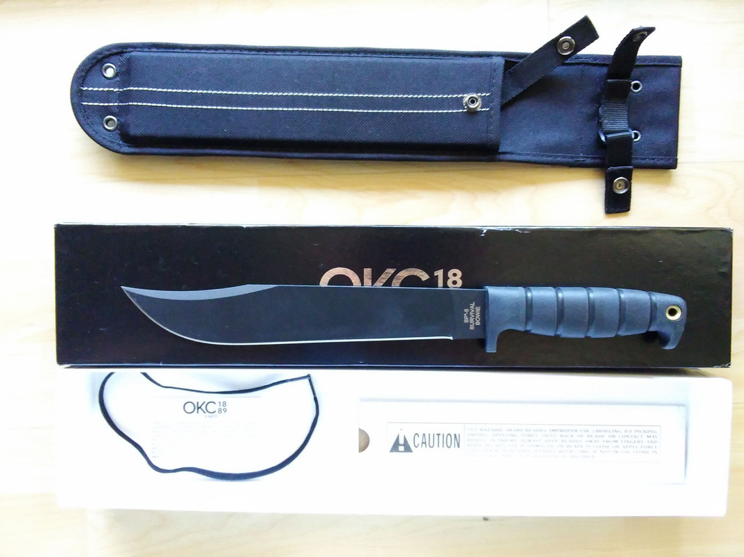

This is my first big knife that is not a machete, and it's my second OKC knife (first was an Old Hickory). First impression is that it is an beautiful blade and I am very happy with my purchase! It comes in a nice box with a sheath and shoelace lanyard.
I wasn't sure about that upswept clip point, but it looks a lot nicer in person! F & F overall is very nice. The edge is sharp and usable right out of the box. This knife weighs 15 oz; at the bottom end of big chopper territory. It does not feel tip heavy, though. The center of balance is right at the start of the ricasso. That big, blocky handle is heavy, which makes the knife feel more lively and less tip heavy. I am not a fan of huge ricassos or choils, but for the price I cannot complain.
The sheath is functional, but a bit of a miss. It is longer and wider than it needs to be. Perhaps it is shared between multiple models. I wish the retention straps were removable, because they get in the way of sheathing the knife. I can do with just either strap and wouldn't mind being able to temporarily remove the other. The sheath itself weighs 6 oz, which is a drawback compared to an axe or tomahawk. The bigger the knife, the heavier the sheath, which is just dead weight. Knife + sheath weighs 21 oz, which is heaver than my Fiskars hatchet. The Fiskars will out-chop and out-split the SP5.

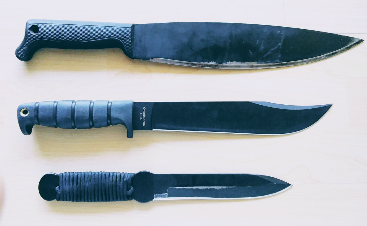

Here is the SP5 with other fixed blades for comparison. The Cold Steel Barong has a 12" blade. The SP5 has a 10" blade. The Cold Steel True Flight Thrower is the equivalent of a 6.75" blade. The SP5 is my gateway into big fixed blades, and I like it a lot. I can see why people see it as a multi-purpose blade, because the size, weight, balance and blade shape make it a versatile design. I want to thank Ontario for offering a great, made in USA product.

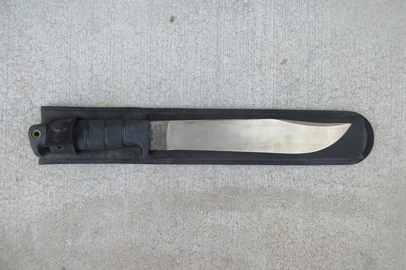

One of my SP5 knife with a few mods. The first thing I did was strip the coating off. I wasn't a fan of the upswept bowie tip so I ground it to be a little bit straighter. And I reprofiled the edge to convex grind. I am a big fan of the this SP5 which has seen a lot of use.

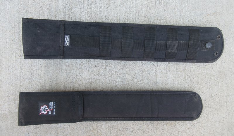

Gentlemen- In 2016 Ontario redesigned all their sheaths and one sheath was designed which would fit both the SP-5 and the SP-53 so these two knives have shared a sheath for the last seven years.
so, this sheath seems about the right length of SP5. But it is still a SP53 sheath. Due to camera angle, the SP5 just looks longer and sheath looks shortened a bit.
