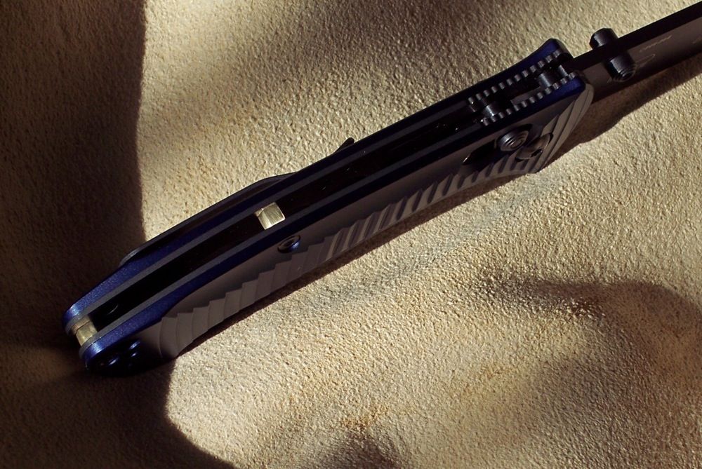

I've made standoffs for all but one of my BMs that came w/ a nylon backspacer, this a 525M4:
If I had a 707 I'd tell you what the gap is, I don't. If you're lucky there will be comm'l s'offs avail-- o'wise you'll have to make your own.

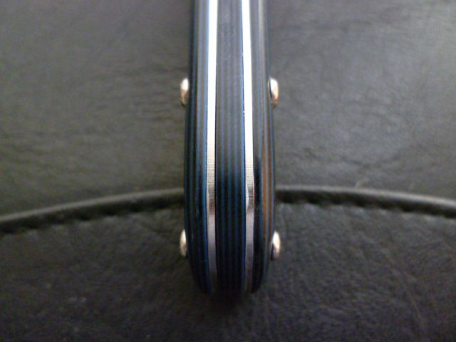

Replaced the black spacer with G10.
(still need to countersink the screws just a bit more)
