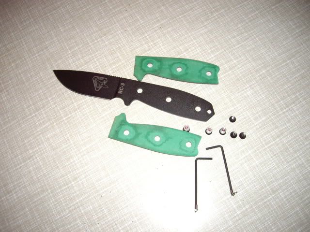

A few months after buying the knife I took the handle off out of curiosity. This is what I saw on the liners.
I guess it's water marks?
Later, I removed the coating from all of the blade, it slices slightly better but as you say I should've removed it from just the blade part only.
So, knowing that water creeps through the screw holes I've wanted to keep an eye out for rust.
The last time I took the handles off was about 6 weeks ago, I didn't see any rust (maybe because of the patina I put on the knife when I first took off the coating?), I re-oiled the tang and put the handles back on.

I do not think those are water marks on the liners. It looks like a little bit of machining lubricant or screw oil or something like that that the liners absorbed from the screws when they were inserted in manufacturing. If water were very apt to find it's way in there you would likely see water marks also around the edges and I don't see any. The liner material is a high density fiber paper that resists water a bit just because it is so dense. But petroleum products, particularly a very light machine oil will be absorbed by the liner. Don't worry over it. Mike
A thick grease, or better yet a wax based lubricant on the blade under the scale works well.
You can also simply use a good qaulity epoxy coating which is clear and thin on the handle.
