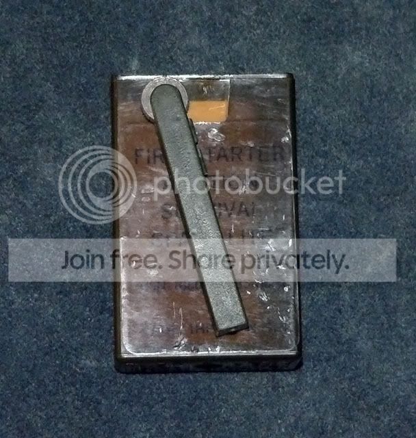

i carry the one in the picture there (the issue one) and it does work good with very easily lightable tinder... but like what was stated before, this is a last ditch effort though. its original purpose was for use in military aviators survival kits. its minimalist equipment for sure.
