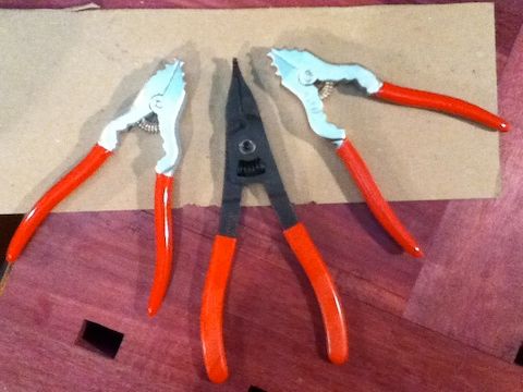

In the past I was using the thinner SPREADER PLIERS in the photo bellow. They are a Godsend but some times I cant get them into a gap or they dont have enough leverage and I have broken them proving that they dont have enough strength for some tasks. I have a more robust pair of Proto brand at work that are just really nice but I dont want to break them too.
Why a photo with two of the same pair : First off the rivet is not hollow and is more robust in the one on the right and Second to remind you that you can ALSO use these spreaders in pairs so stock up.

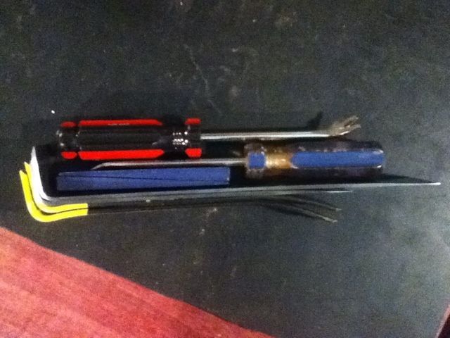

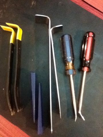

Side view and face view of the gang.

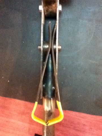

As you can see; if you use one lever you have to hold the work with something and the control is iffy.
Used together in pairs it is almost like using some spreader pliers but I have broken spreader pliers and these levers are much much stronger and have more leverage.
Cant fit those black and yellow ones in ? Use the thin stainless ones; at least to get things opened up enough to get the thicker levers in. I may even buy a second set of these thin stainless levers and cut the ends off and just use them as simple wedges. They are inexpensive enough to have more than one pair.
Still need more spreading power ? Or cant get the long levers in to a confined space ? Use the blue Klein wedges (they make many sizes).

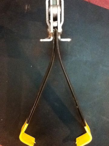

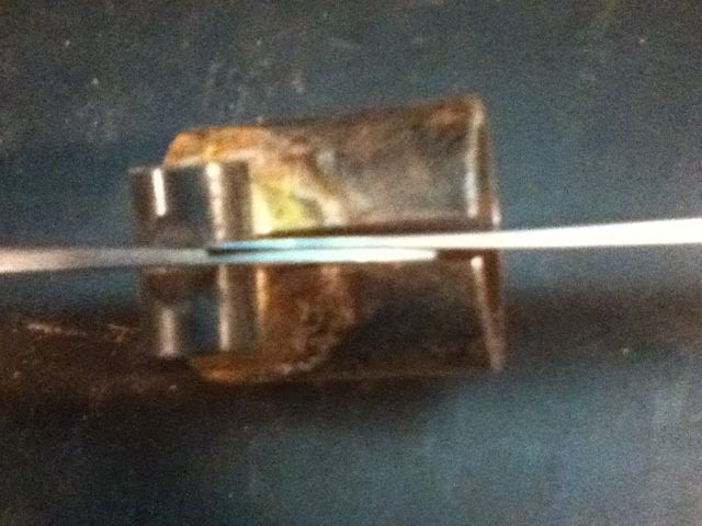

When a gap is too wide to use the straighter part of the black and yellow levers one can use the ninety degree bent ends and spread with them. I tell yah these suckers are SO handy in pairs.
All these guys pack into a very small space for how much they can do for you. At least I use this kind of thing all the time. Some, obviously, will have no use for them.
What started all this was the lowly tack puller (the one with the screw driver like handle).
Very handy tool. If you only have one tool in your tool box . . .
well maybe not that good but get one; better yet GET TWO !
