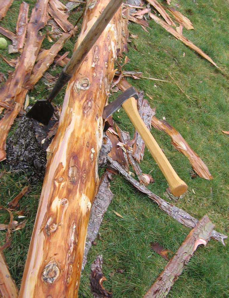

Thank you Square peg. New spud made to my specifications by Josh Burrell
Separate,special thank you for your patronage of Josh Burrell,an excellent craftsman,and and just a good guy:)

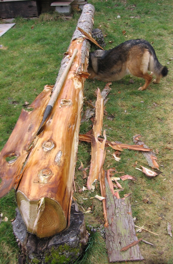

S. P.--Those are exactly what I was talking about, thanks for putting a picture up. Your spuds are a couple of beauties and look ready to go!
I have one small suggestion (this is for everybody with old tools)-- use slotted screws instead of philips head, slotted fits the period for these old tools. I also have a collection of square headed nuts and bolts I use for the same reason. This is a small thing I know, but I feel better when I look at and use my old tools. The bonus is that you get to use those great old screwdrivers you have also collected.
I can see how those spuds would be to work with, good. I guess used a lot to strip around the log's radius, whereas the one I have works mostly in the length taking long strips away. How are they for incidental knots encountered along the way?

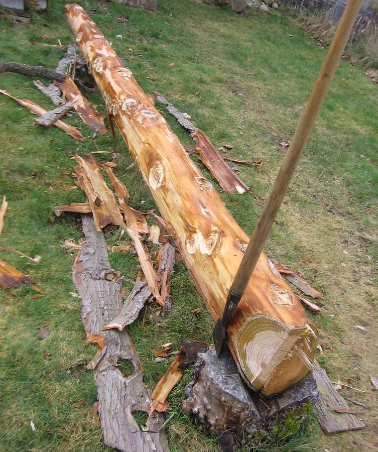

The one with the darker handle is sturdier and does well prying around knots. It's a Warren Bulldog. I have a longer Warren cedar spud that does well stripping lengthwise as you do with yours. I shave the knots with an axe before I strip. Green cedar strips easily. And no, I didn't fell that one, the neighbor did. Just look at that cut! :(
BTW, I love seeing the different tools and methods you use to perform this work. It has a kind of elegance to it. American style work seems more utilitarian (which fits me well). In either case it's up to the individual to bring excellence to the work.
Wow that is interesting wood. Is it a real cedar or Western Red Cedar? The Western Red Cedar I have worked, ( planted in Germany these 80 years ago now), with axes like that was that enjoyable though prone to split out at the bottom. By the way, your dog Warren is no bulldog, it's a German Sheppard but you don't have to tell him that:)
