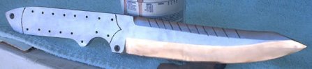

Does this baby need "TEETH" or just a razor sharp edge on the spine?
Handle material?????
I thought about Micarta... how about some suggestions.
It is getting Nickle silver pins.
I still have time before Heat treat to add stuff.
Top is Convex ground bottom is flat ground.
Made with 1/4" ATS34 with 6 1/4" blade 11 3/4" OAL.

Saw teeth,IMO,are the worst thing one could put on a knife.Just sharpen the top edge.
0.25" ATS? Hooley dooley, you must be cranky! :D
I'd vote to sharpen it, would suit the shape much betterer
well for a real brute like that i'd us heavy canvas micarta like on my Bushwhacker thats on the crafts show page of my site. i love ironwood but that 1/2 brown canvas micarta will go to hell and back and just smile

I think some saw teeth on the bottom fourth of the back edge would look VERY wicked, and would make the knife more useful overall, best of all worlds... I would make them straight up and down on the side toward the grip and 45 degrees toward the point, like this
grip===l\l\l\l\l\======point
I don't know squat either, but since you asked:)... I think saw teeth would add a lot of "character". Either square shaped or rounded (scalloped?) serrations to offset the finger groove, maybe about 1/3 of the blade length. While Micarta is the toughness winner, I am very partial to natural materials. The ironwood you mentioned would be perfect IMHO. That is a fine blade no matter how you choose to finsh it.

Thanks for all the input guys.
I think it will wind up with Ironwood and no teeth.
I want the lines to stay a little smoother.
It will get a Fully sharpened false edge to help keep it interesting!
