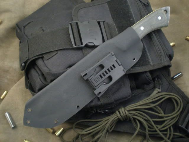

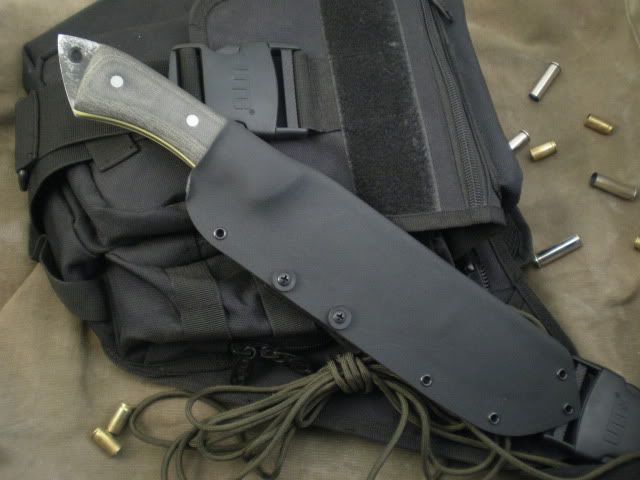

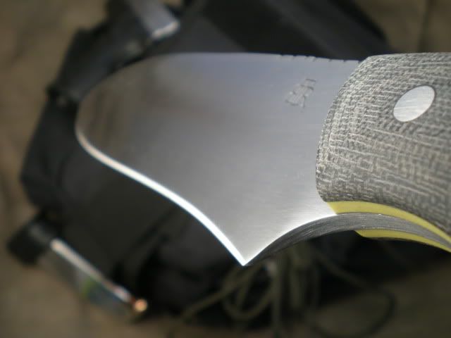

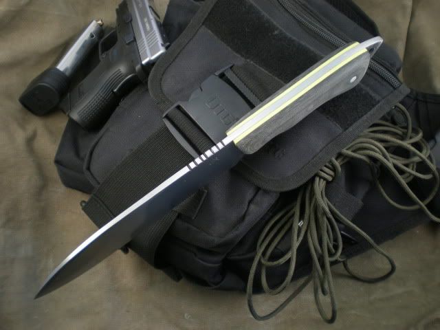

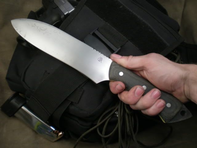

I just finished this one up, it has black micarta w/ yellow g10 liners.
The blade is .214" 5160 at 13.5" OAL and 7.5" blade. The pins are 1/4" stainless.
It will be getting a kydex sheath and Tek Lok.
