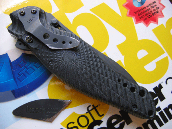

Rod Systems seem to work the best with Recurved blades. I use my Sharpmaker Corners for mine and it seems to work ok. If yours has CPM154 it must be one of the earlier ones cuz I just picked one up and it's S30V. How do you like the clip? I mangled mine after having it for a day because it was WAYYYYY too long. Other than that it's an ok knife though.:thumbup:
oil
Before Mod:
After Mod:

They changed the texture to make it more grippy on the later models like mine. There's a thread around here telling about a guy who wanted to remove his clip from his first run Spec but found Kershaw didn't finish the finish under the clip so he didn't. My handle is finished under the clip but the other side of the pivot is big, bare, and ugly without it.
I'll see if I can't find that other thread.
later,
oil
