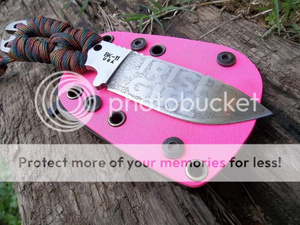

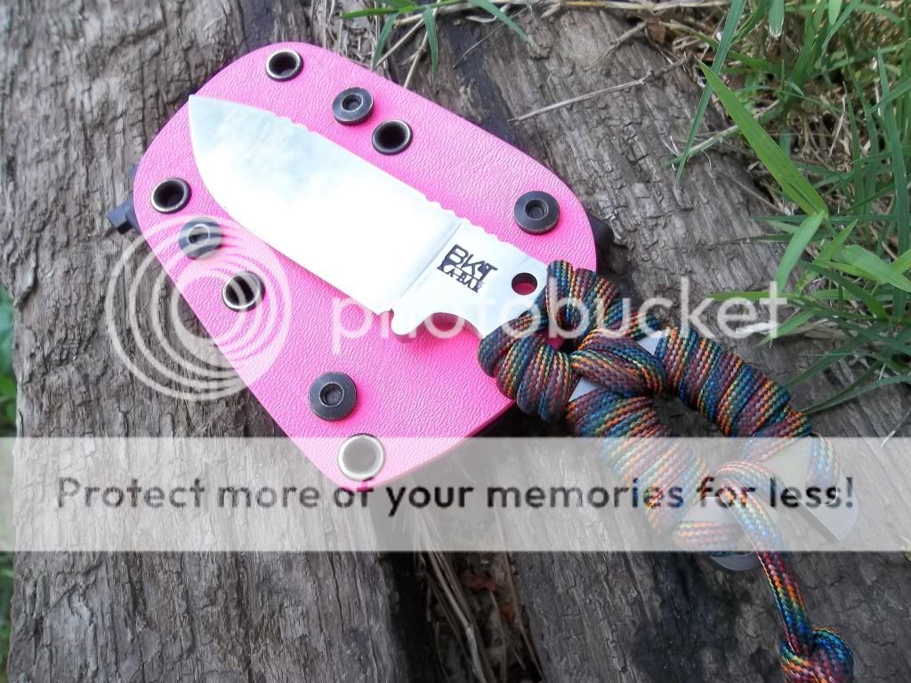

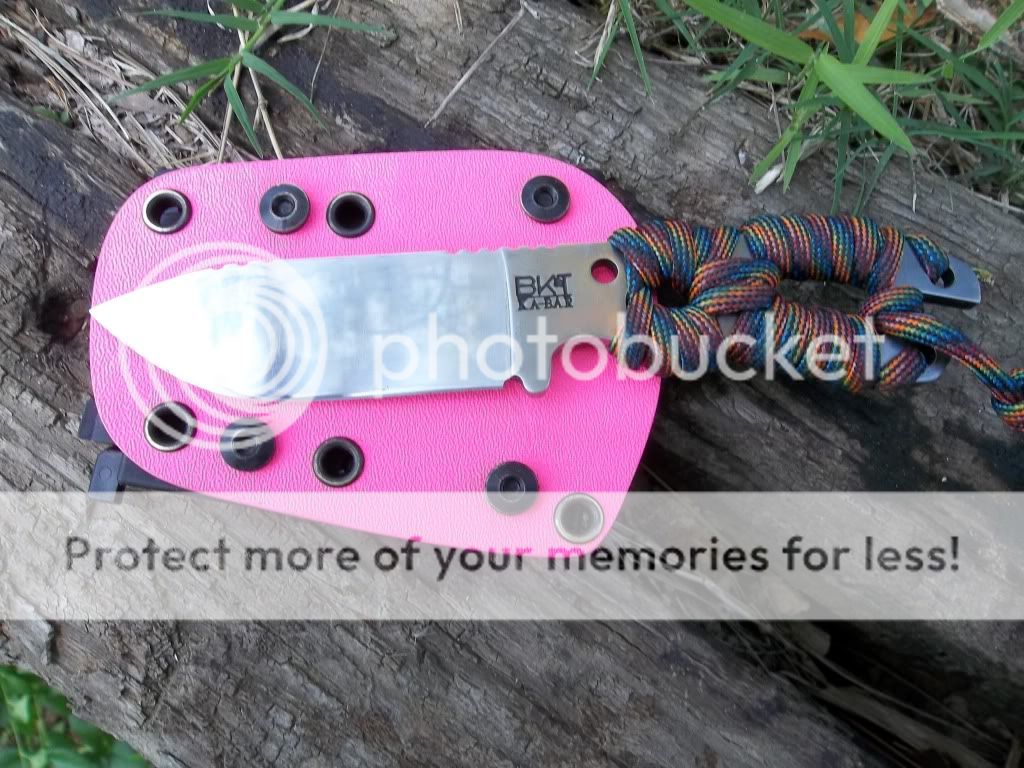

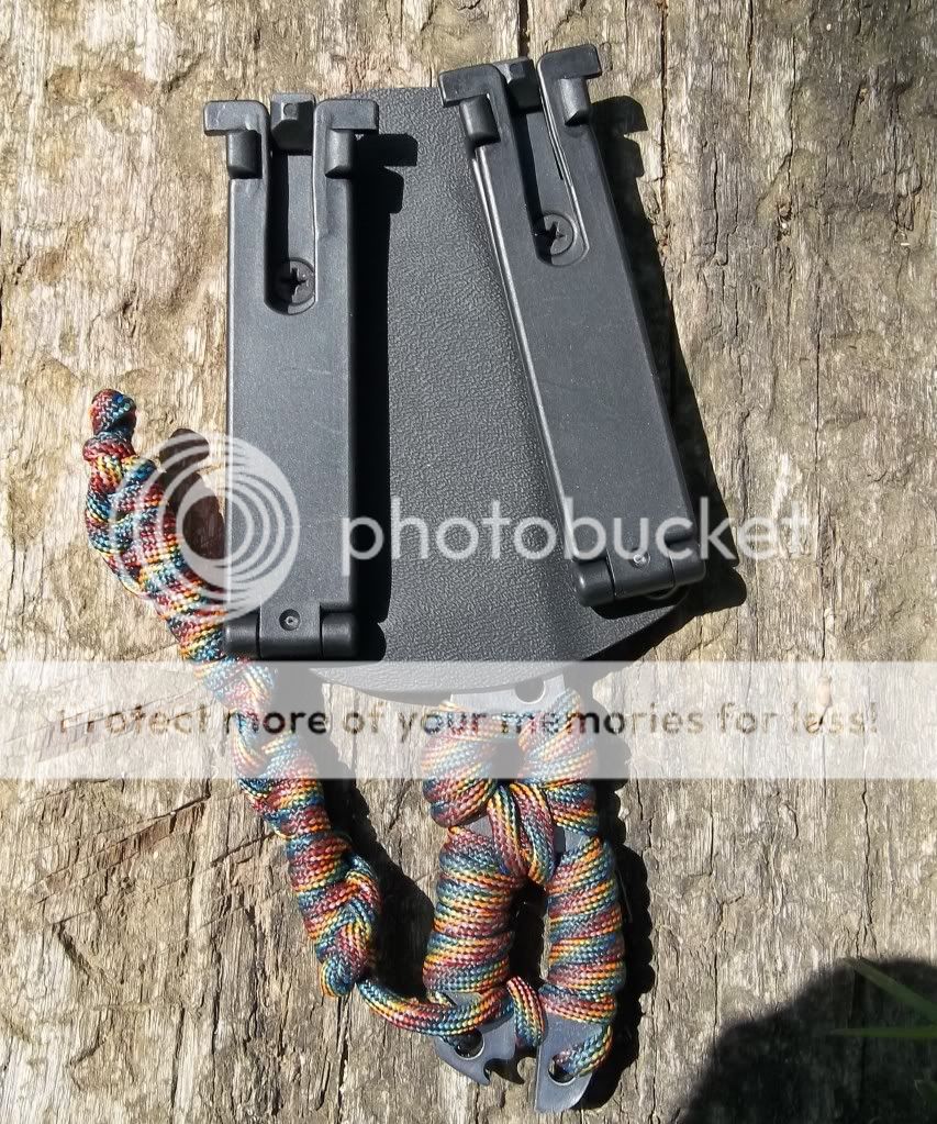

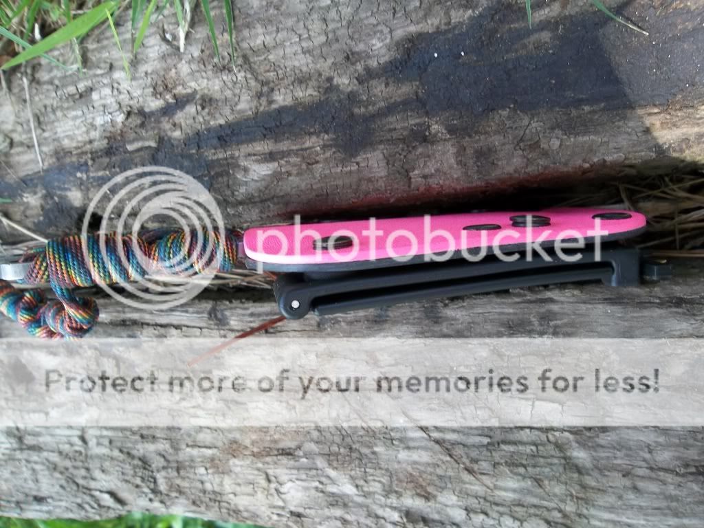

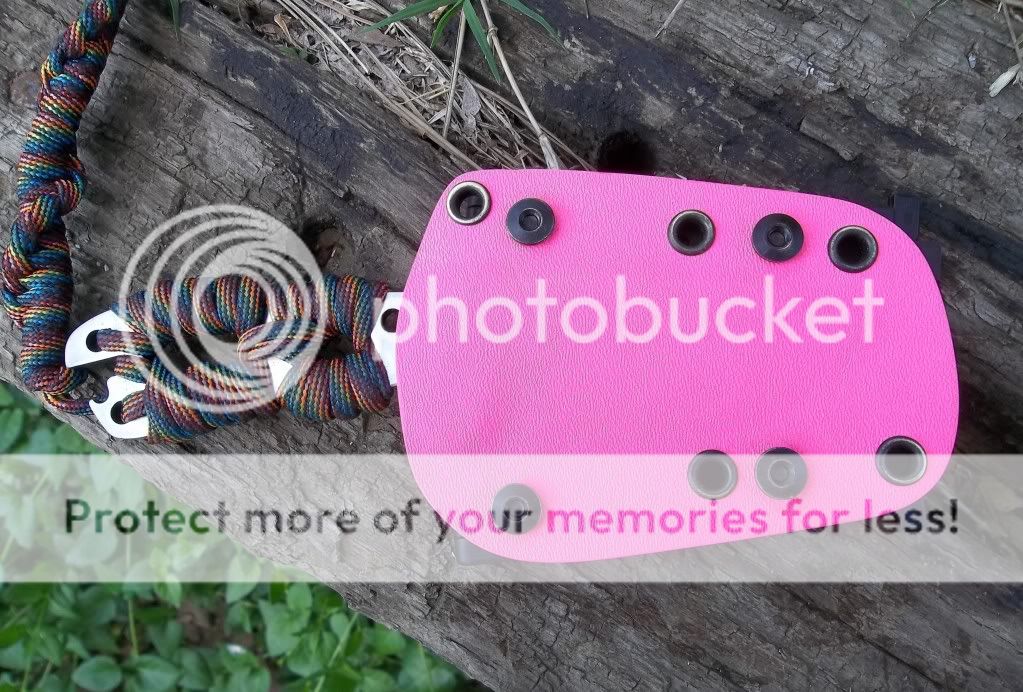

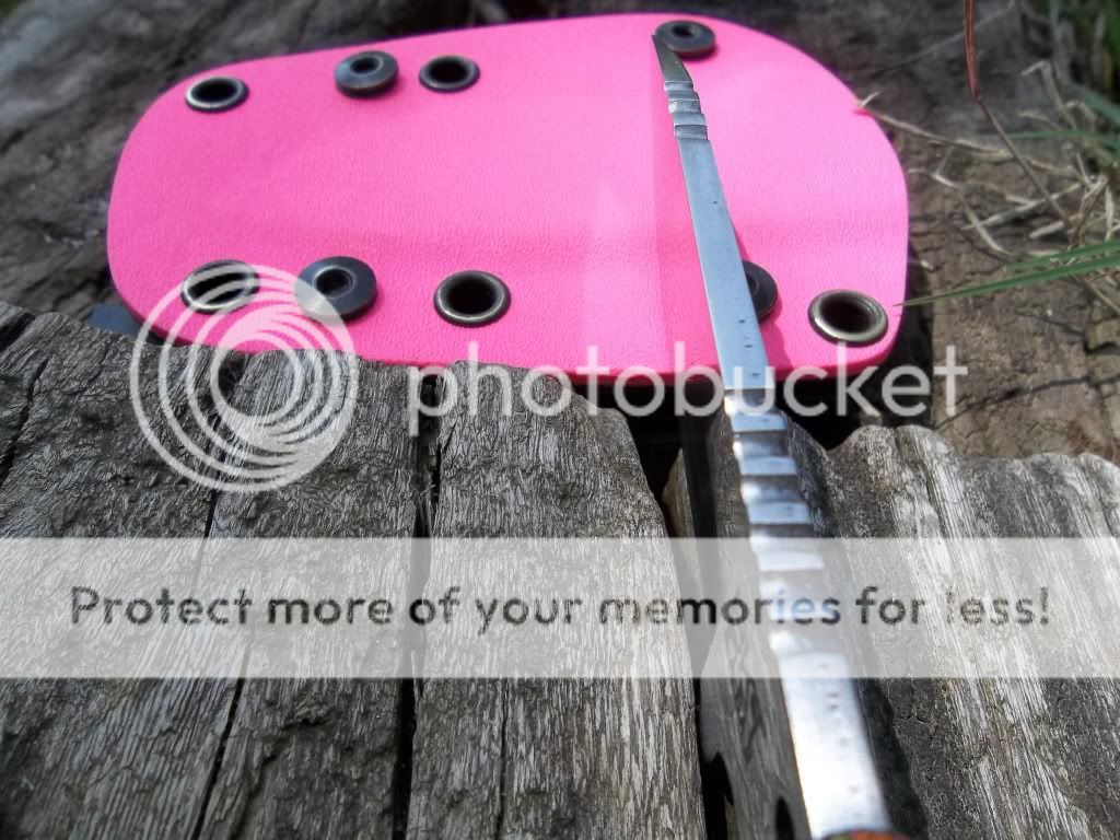

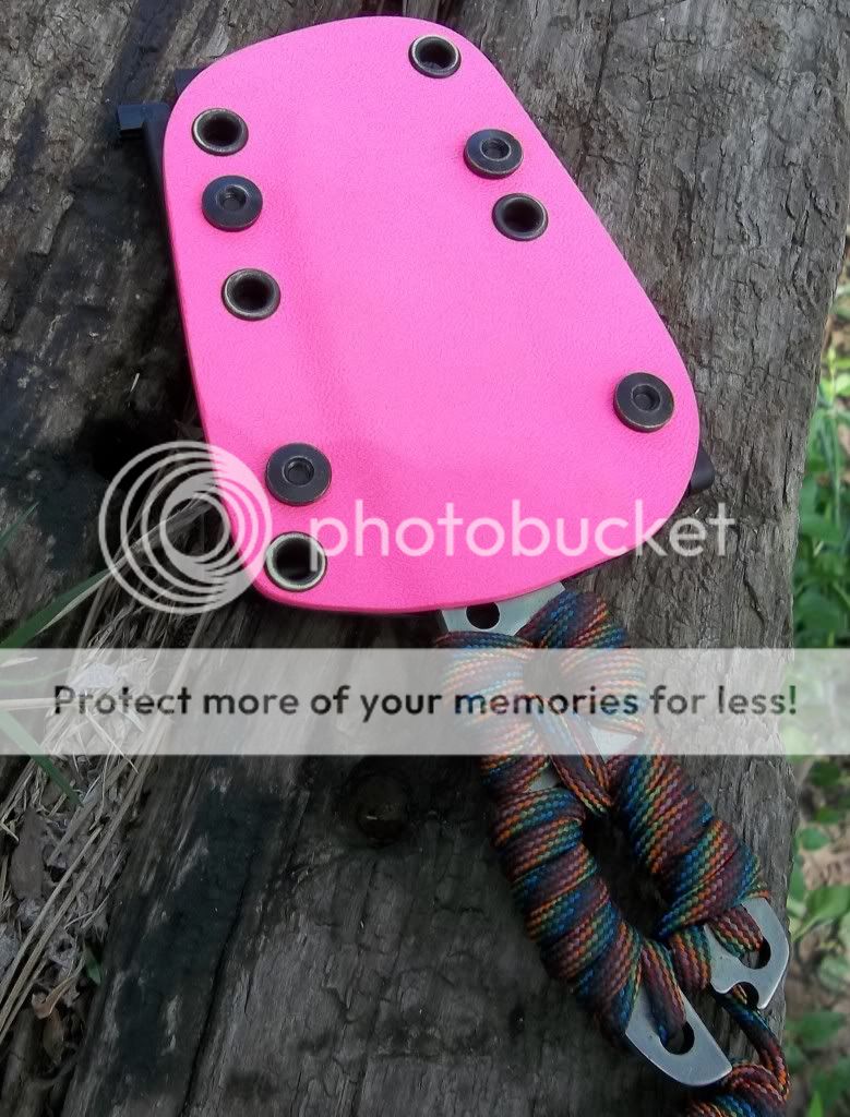

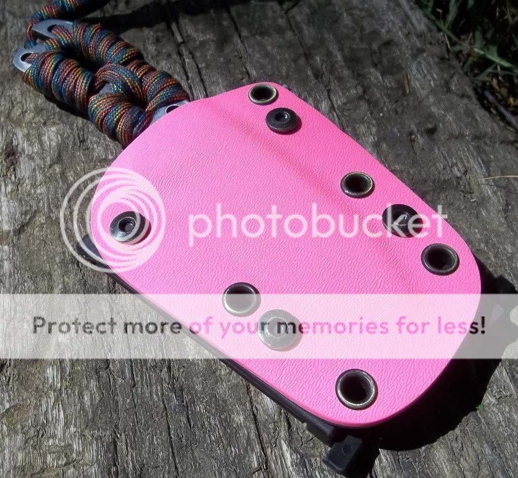

I'm hoping she's pleased with it. She ordered ''Shiny, Pink and Unique'' and I think I satisfied the specifications LOL.
Took whole thing to a high-polish User-Shine, Rainbow 550-Wrapped it, Jimped it, Pink Kydexed it....and Polish-Etched her personal nickname.

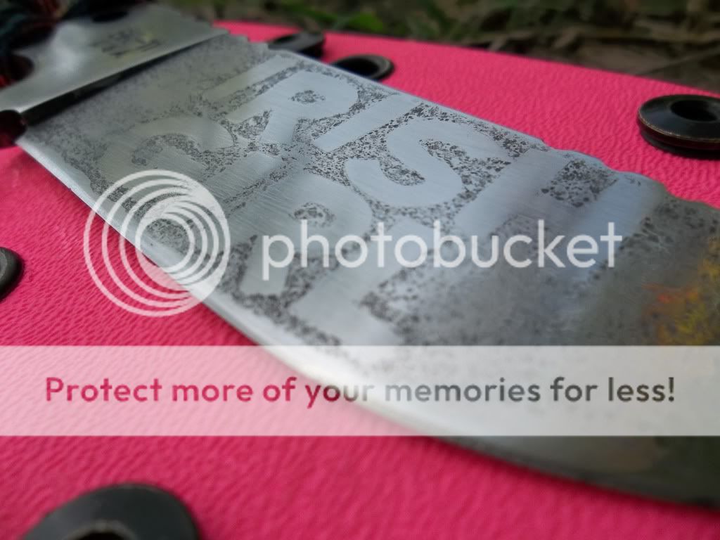

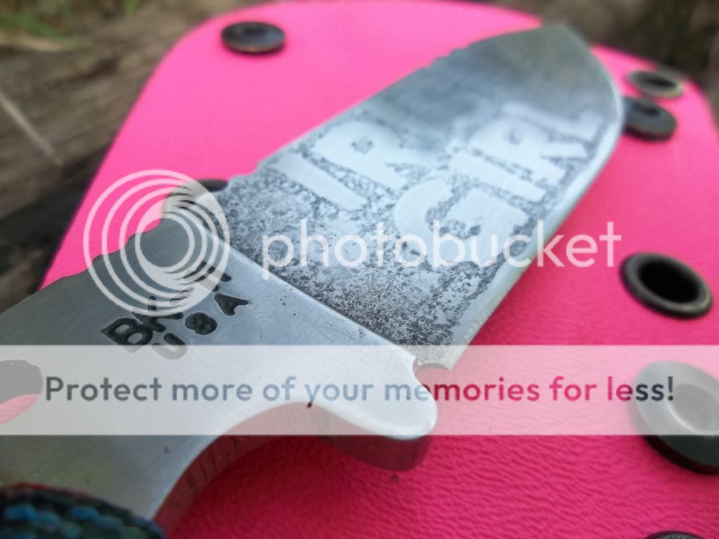

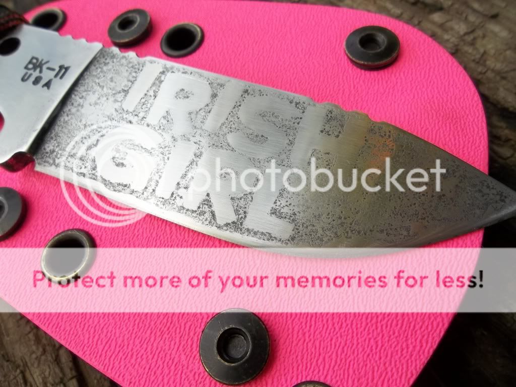

I was trying to figure out how to etch it, after I saw Clich's BK9 I knew it was something I wanted to incorporate into this project. I also didnt want to sacrifice the ''Shiny''. I did some thinking, and came out with this technique.
Vick's Vapor rub on everything but the blade-flat on the etch side
Stickers applied to blade
Cold-Blue rubbed all over flat, several coats to ensure even covering
soaked in bleach for ~25 minutes WITH STICKERS STILL ON
then dried, sanded, cleaned same as normal bleach-etch procedure.
It pops, a very defined "Irish Girl'' on a Still polished blade. As the one pic kind of depicts, it will still throw reflections off even on the etched half.
I would like to thank Mighty1 and Greybush for their much appreciated help with materials for this project. Thanks Guys! Mighty's package arrived Literally seconds after I completed sheath...great timing!
Now for final sharpening tonight and shipped in the morning
Fantastic job. The etching turned out very cool. I like the texture left on the blade. Really well done.
If she doesn't like it, I will change my name and you can give it to me. lol

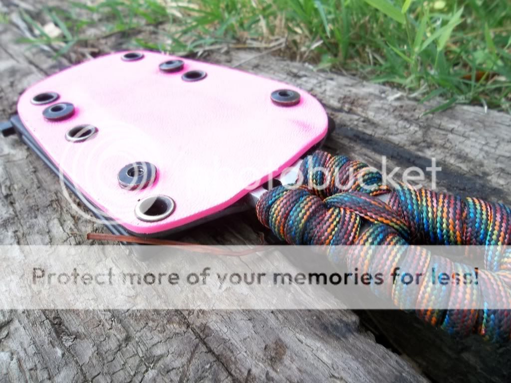

I'm gonna have to holler at you about a kydex sheath!

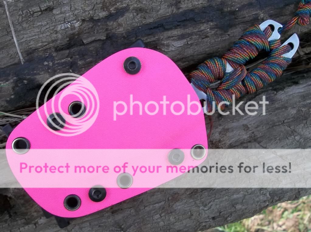

Looks like the necker worn by a unicorn or something, btw, did you make that kydex? Very nice finish on it :thumbup:.
Yep, and thanks

It works, was kinda nerve-wracking dunking it in, but it worked out. I was mostly worried about if the stickers would hold up in the bleach..THIS brand did, no promises on any other stickers. Who Knows.

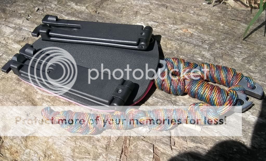

Nice, I would rock the pink(I do have a pink izula), clich I think knife kits has the molle locks.
