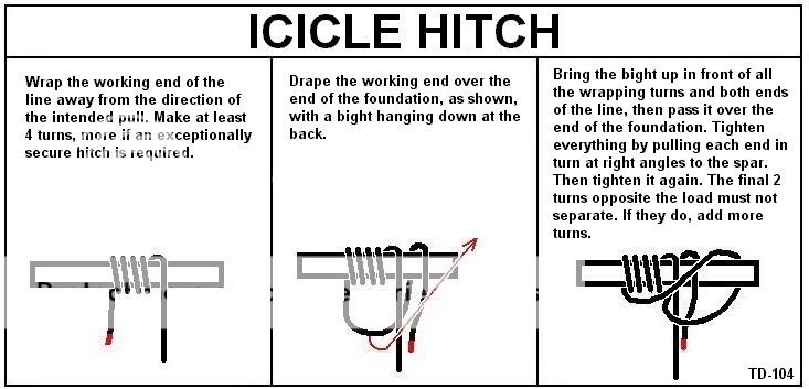

First, the Icicle Hitch. I have to admit, I've never used this knot, but I do practice it because it is just plain cool.
A quote from Geoffrey Budworth, "As an extension of his double pile hitch, John Smith first demonstrated this astonishing contrivance in May 1990 at the eighth Annual General Meeting of the International Guild of Knot Tyers, when he hung suspended by it from a splicing fid (tapered point down - Doc's emphasis). As this demonstration proved, with careful arrangement this hitch will hold a considerable load on the smoothest of foundations - even a fireman's brass pole would be suitable. It has recently received fulsome praise from a civil engineer, who used it to lever a young tree out of the ground, after previous efforts by other means had failed and left the tree stripped of its bark and consequently slippery and smooth" (The Ultimate Encyclopedia of Knots & Ropework, Geoffrey Budworth, Prospero Books, 1999, ISBN# 1-55267-986-1, page 104)

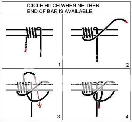

Here's a way to tie it if you can't access the end of the anchor.

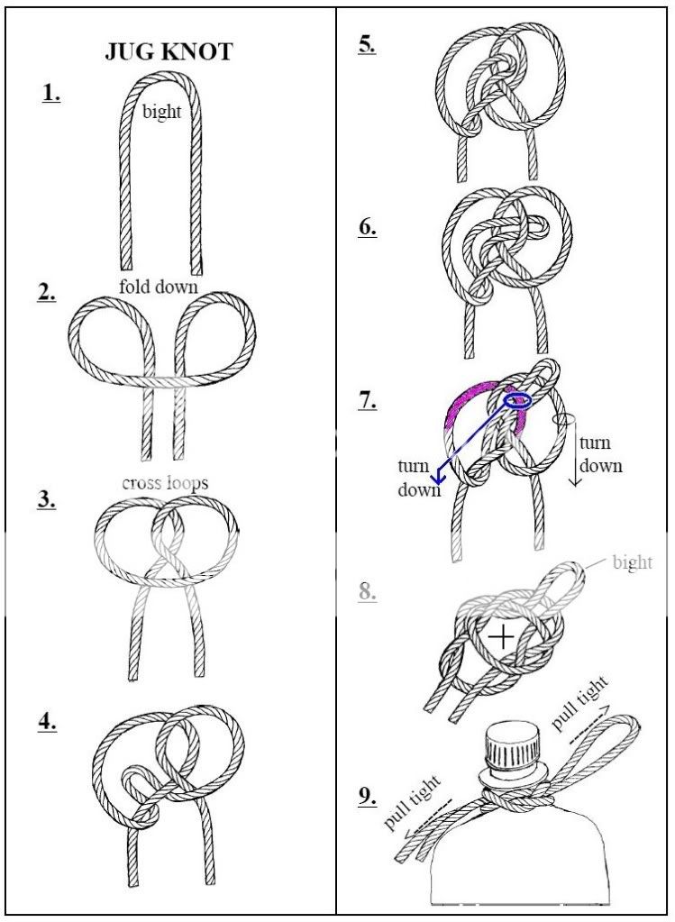

The other two, actually one plus an accessory is the Jug Knot and the Asher's Equalizer. I use this all the time when I go to the store for a big bottle of pop or whatever. (I think they talk about me at the store :( )
I'm going to do this drawing one of these days, because I think it's just a bit confusing. It originally came from a web site called Rope Works but it's drawn incorrectly (step 7). (BTW, this is no reflection on his site, in general - I find it excellent and am probably going to buy his book, one day). This knot by itself, is handy for hanging a store-bought bottle of water off your belt, if you don't have any other carrier. Looking at the picture at the bottom of column 2 (#9), if you tie a toggle on the loose ends, you can loop the upper loop around your belt, or whatever, and place the toggle through the loop to secure it. If this isn't clear, say so, and I'll whip up a diagram.

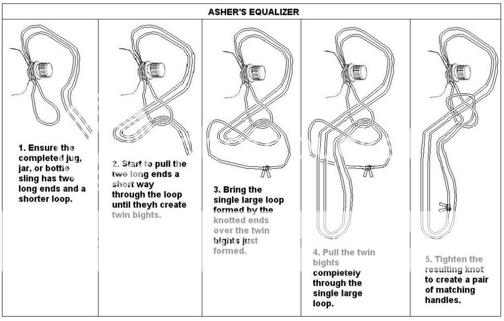

The accessory to the jug sling is the Asher's equalizer - this provides a handy handle for carrying the bottle. Please excuse the quality of the drawing - I'm going to have to redraw it one day.
One other thing :(, if you want to carry 2 bottles, use a loop of cord, and fashion a single constrictor on each end of the loop (and use toggles :D ).

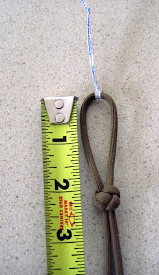

This is my favorite specialty/decorative knot:
Lanyard knot ABOK #787
used to make lanyards along with sennits and other plaits
I usually make a loop with a lanyard knot in it as a dangler if I wear belt sheaths
starts with the carrick bend that was in the bend's thread, then take the ends around and through.
This pic is from http://stormdraneslanyard.blogspot.com/
If you want to see all kinds of really cool applications of this & other knots, check out Stormdrane's blog: http://stormdrane.blogspot.com/ His stuff is amazing!
how to tie it: http://www.marinews.com/Sailors-Knife-Lanyard-Knot-784.php

Love the Jar Sling. Comes in handy all the time. I never use the equaliser though.
Haven't figured out a use for it quite yet.

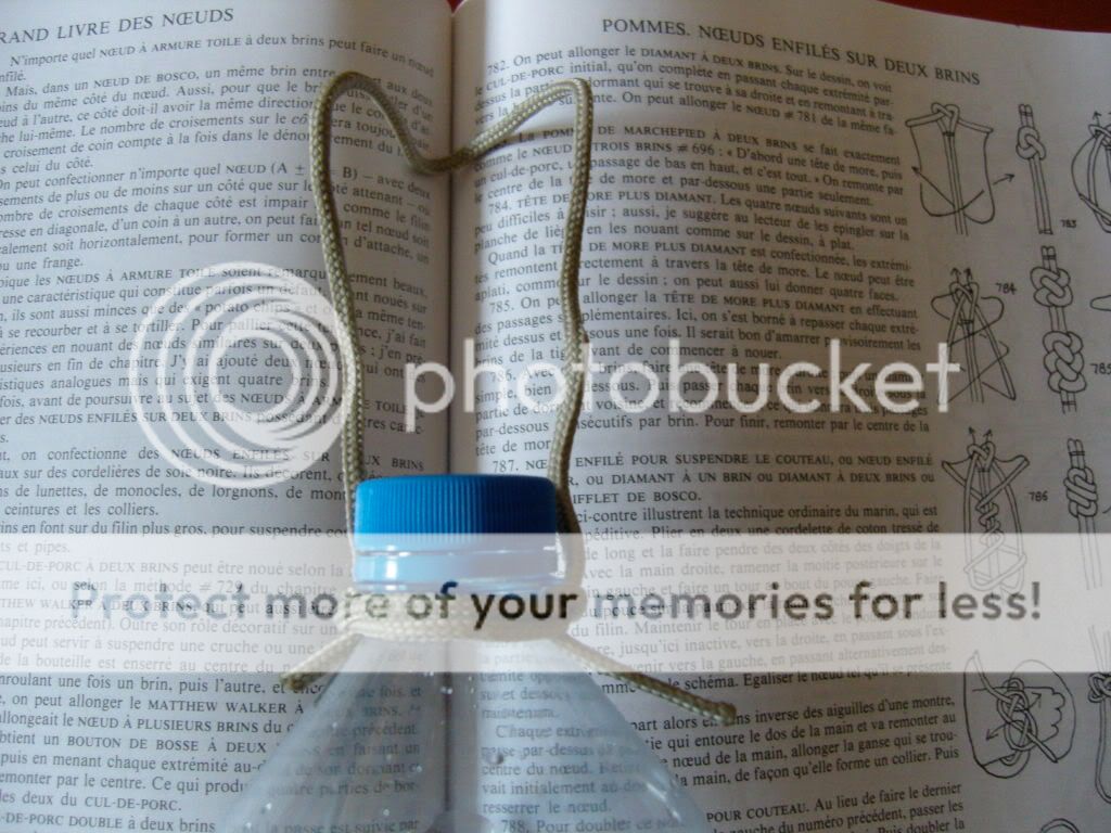

Hey dantzk8, that's pretty neat - Ashley's book in French. :thumbup:

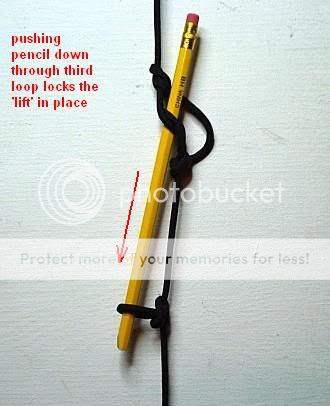

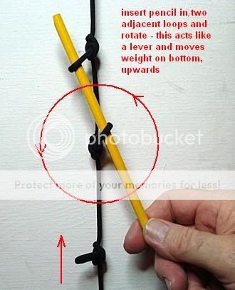

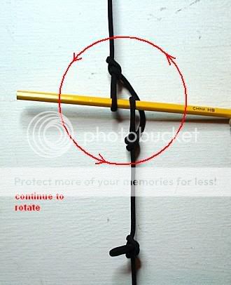

That's cool, sort of like a trucker's hitch but instead of a pulley you have a lever... which doubles as a toggle. So probably good for putting tension on a line or shortening it by a very specific length. But I can't see something like that being remotely secure.

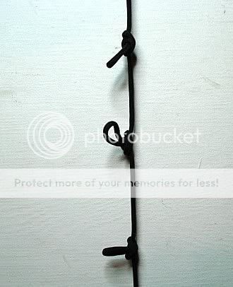

Here's my contribution - possibly useless, I came up with it in the wee hours of the morning. If I recall correctly, that central loop was pretty interesting. I don't remember exactly what it was supposed to do, but at the time I was convinced it was amazing. So let me know if it blows your mind.

I bought this translation 15 years ago. One of the most valuable purchase i've ever made. Thanks to mention the Geoffrey Budworth's book, i will order it despite the language barrier. Vocabulary is a problem when it comes to knots, for instance a bowline knot is, in french, a "noeud de chaise", literally: a "chair knot".
