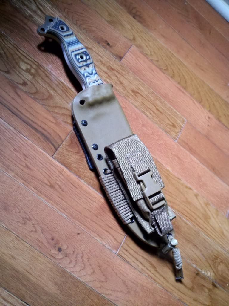

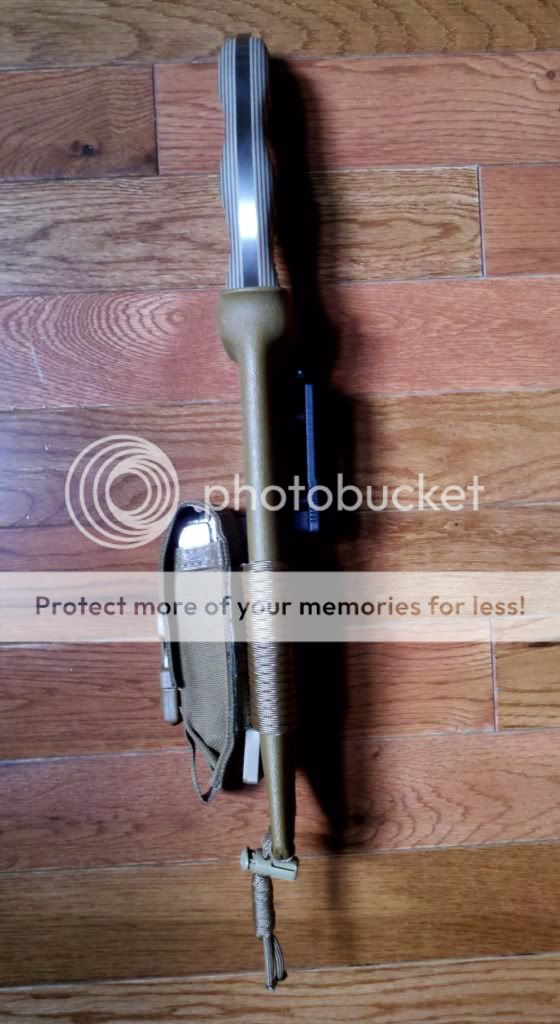

Here is what I did with my HH. Kydex by Buy Brown, pouch is a Spec-Ops multi tool pouch.
