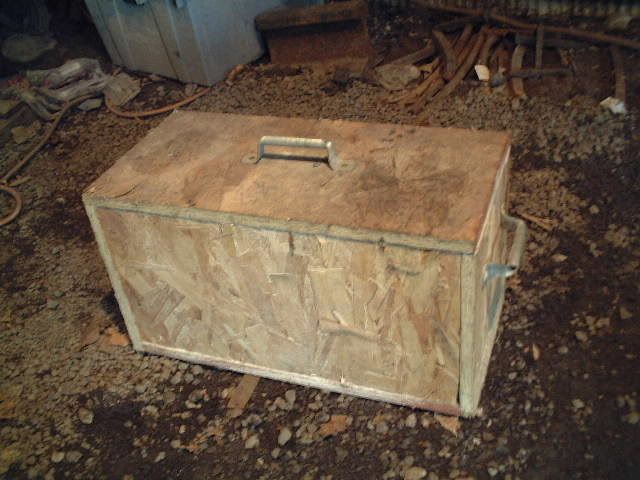

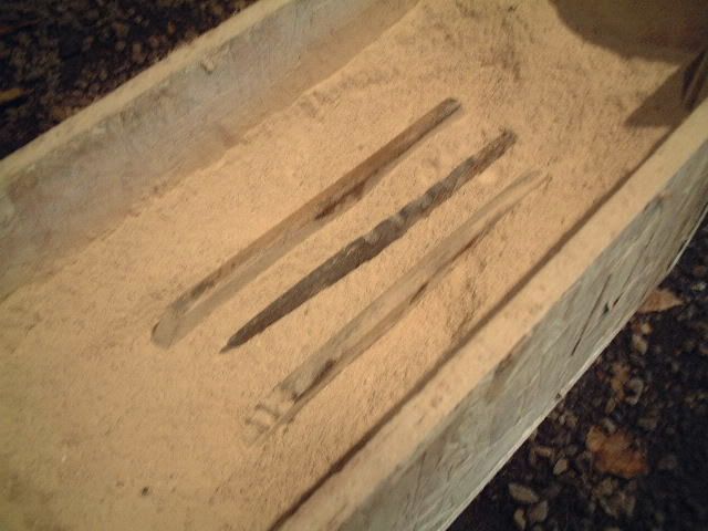

Here's something you can do, and what I used to do before I got my oven:
Make a box like pictured here and fill with lime, the really finely powdered lime. About the best insulator you will find.
Heat up two large pieces of steel that are through and through heated to a dull red in low light - maybe a little bit bright.
Bury them on edge in the lime about an inch or so apart.
Then heat up your blade to a dull red and place between the bars. Cover with lime and place lid on container.
I've had a knife blade still too hot to handle with bare hands the next morning!
You never really got up past critical, so this is NOT a full anneal, and your blades can still be like BUTTER!
