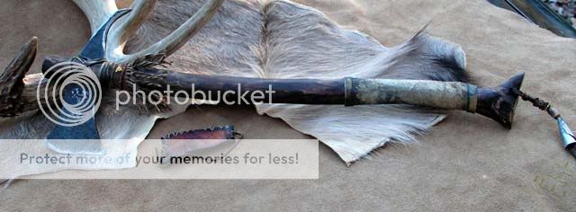

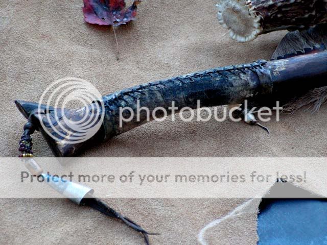

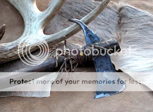

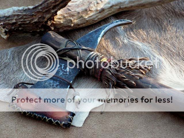

I put this one together over the last few nights. The head is over 100 yr. old plow tip.
All that pitting is nature not mine. 7″ across with 2 1/2″ chopping edge. Hacksawed, hot cut,
forged on charcoal and quenched in water. Threw the haft held on with pine pitch and rawhide.
The haft was a Sweet Gum branch , drawfiled, oiled, toasted, scraped and waxed. No dye.
Rawhide wrap from some of my deer hide. A little fringe, beads and a hand rolled “snuff can tinkler” because I could.
I love the way the handle fits my hand on this one……Randy

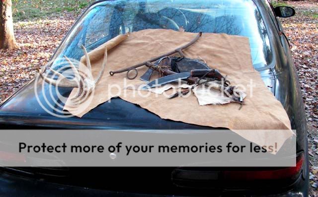

AND, I had an e-mail asking about my pics and the setup of my “photo light box”
…trunk of a Geo…..Randy
And I really don't say this enough, LARGE thanks to Mr. John Cohea for resurrecting this great old style of 'hawk,
they are a ton of fun to make......

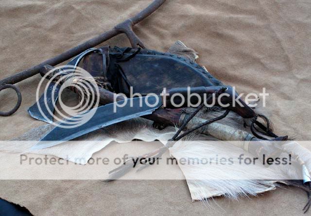

Another great piece! It looks natural next to the snake chopper. A mean pair showing real talent. Coodoos Bro.
Howard
Robin, Howard and Colog...THANKS for the great comments. This one was fun,
everything was already here, just needed putting together....
Nice combo. Are those some white heart glass red beads? Nice work. Looks like it was just unearthed from a past time. Regards Lee
Thanks Lee. It has some white hearts and shiny yellow and deep red. And some wooden.
All were in one little box from an antique fair....
Very unique looking piece...Does look like it would feel real good in hand. Great job !

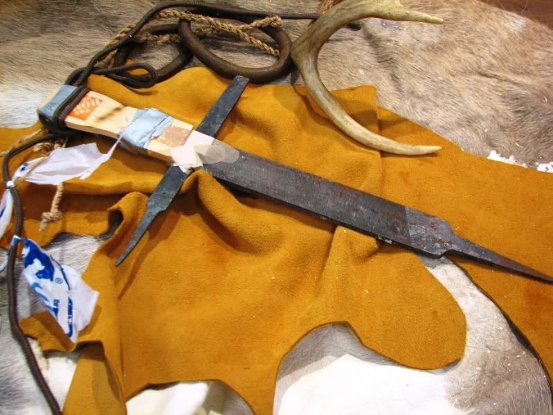

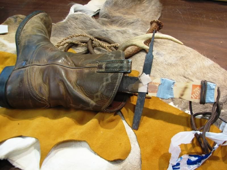

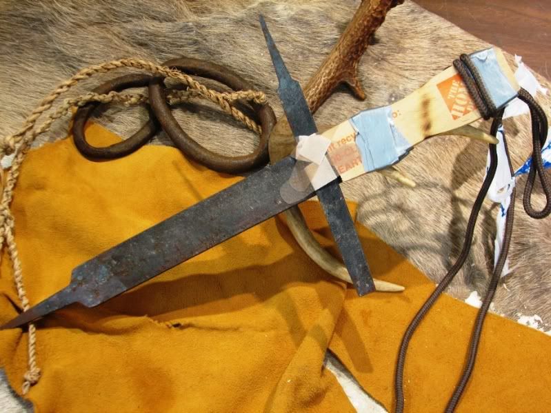

Here is one I call Apocolypse Shank:

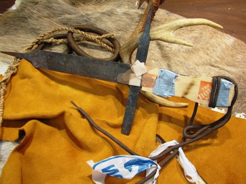

Made from an old file I found near an 80 year old plow. I would have used the plow for the blade but it needs another 20 years or so.
Scales are wood I had laying around. oiled, toasted, scraped, scortched, fried, smoked, salt and peppered, whipped, waxed, hog tied, not sanded, no dye. Wrapped with duct tape from my roll of duct tape. All hand work.
Aged with my own mixture of dirt, varnish, poop, 11 herbs and spices.
Guard is obviously made from another old file. Held on with pine pitch, bubble gum and 20 year old band aids.
Lanyard from a 9 year old shoelace. A few feathers made from Food Lion bags just because I can.
Just what would have been on any chuckwagon.
Got the idea from Randy to make a sheath out of an old boot.
No electricity used.
I hated the sheath so I threw it in the drawer for a while.
The new sheath fits like a glove

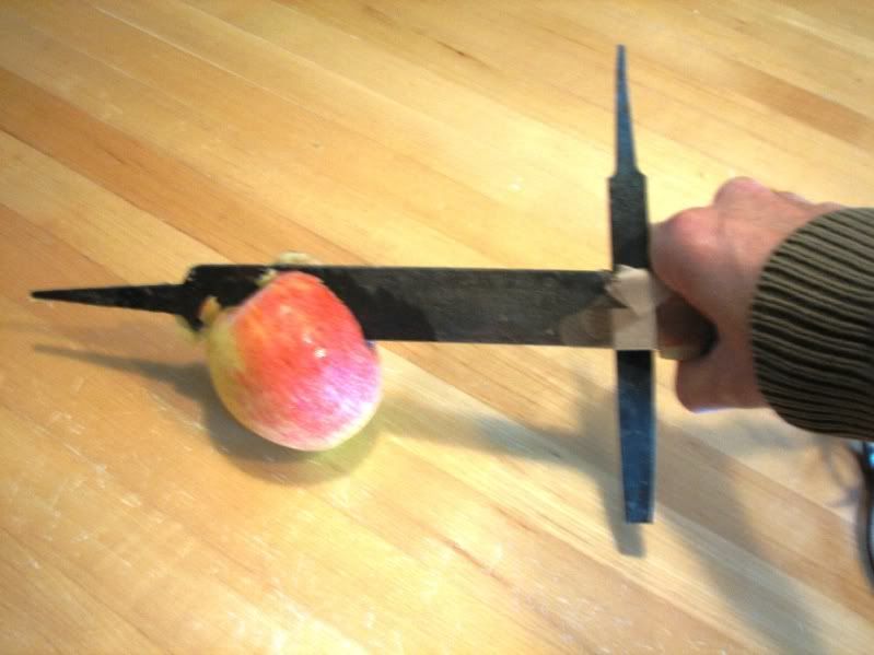

made a striker out of another old file and attached it to the sheath
This one will be used in the woods and I want to be able to get a fire going.
Starting to get a nice patina to the blade from some kitchen duty
This one is a keeper and is not for sale so please do not ask.
Thank You Randy for all your help and inspiration! :D
