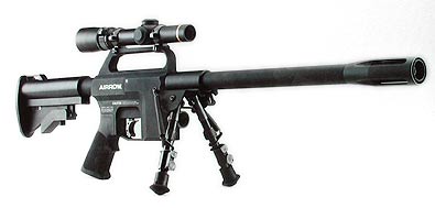

I have progressed some on my spike cane gun. This has gotten to become an education as well as the usual offshoots into childhood adventures.
I have just about finished the valve for the cane. It should withstand pressure in excess of 10,000 PSI and the tubing that will be the barrel is rated at 10,000. Of course, I can't get air higher than 3,000PSI and I had to sign a waiver with the dive shop to get that.
It can also use CO2. CO2 is around 850 to 950 psi depending on the temperature. It is really nothing as a liquid and pressurizes in the tank when it becomes a gas.
Given the same pressure, the CO2 is slower than the nitrogen based air. This is because the molecules are larger in CO2 and you just can't get the same speed.
Oh.....the spike is finished for the cane also. I just need to make the cam that opens the valve when I turn the spike to unlock it.
Anyway...while playing with this and planning the big bore air gun, I remembered something I built years ago. It is a copy of something called the Airrow Stealth. It shoots shortened arrows. I didn't have the money for SCUBA tanks in those days and was using a ball valve for a trigger.
I was talking to one of the air gun geeks and he said, "Use a power Washer Valve"
HMMMMMMMM. I went out and bought one and it was rated for 4,5000 PSI. Happy days, 600 FPS arrow gun is on it's way.
