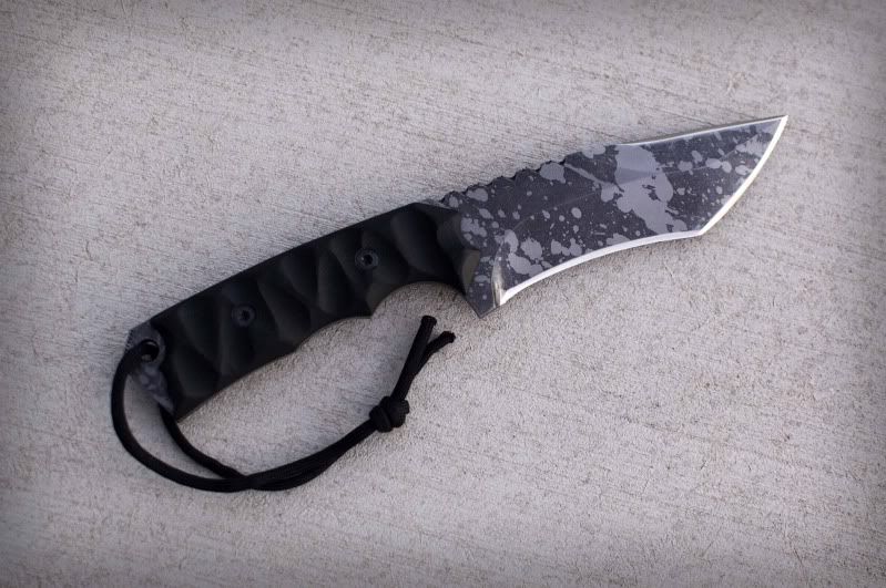

i saw this awesome looking acid etched finish on a knife somewhere on here... it was acid etched but it had shiny splatter spots all over it, like someone randomly splatter some acid resistant material on it before dipping. just curious what liquid material you would use to splatter on, that would dry and protect that area of the blade from acid?

that's cool, but i really have a thing for the finish that looks like you dipped a paintbrush in paint and just slashed it across a wall (without actually touchin it), with a bunch of long splatter lines

I've always imagined hot glue guns were used on blades etched like that. Drip a few small blobs in different areas then let the glue kinda string down (the higher you hold the gun above the blade, the thinner the "strings" will be) from the gun as you move it around randomly (slower or faster for different looks). Might take a couple tries to get the look you want. Just my 2 pennies :D

Here is one I did with spray paint and ferric chloride. I soaked a rag in spray paint and then just slung it across the blade to splatter on as a resist. Then dipped in and out of FC for about 3 minutes. Cleaned it off with mineral spirits and neutralized with ammonia. Then I stone washed the blade in a tumbler for about 20 minutes.
You can also splatter paint onto a knife by holding a popsicle stick at an upward angle in front of the spray nozzle. The paint gathers on the popsicle stick and the force of the spraying makes it splatter off onto your knife. It's an old airbrushing trick I learned in high school, but it works with rattle can paint too. Warning, it will splatter everywhere in front of the popsicle stick, so make sure you're not aimed at anything you don't want painted. Hold it closer to your knife for larger drops and further away for smaller ones.
