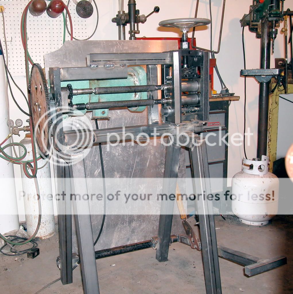

This is my proto type rolling mill. works good, (next one will be more powerful).
Thought I would post it so anyone making one could have a chance to look at it.
The split drive is nice for keeping your bars straight.

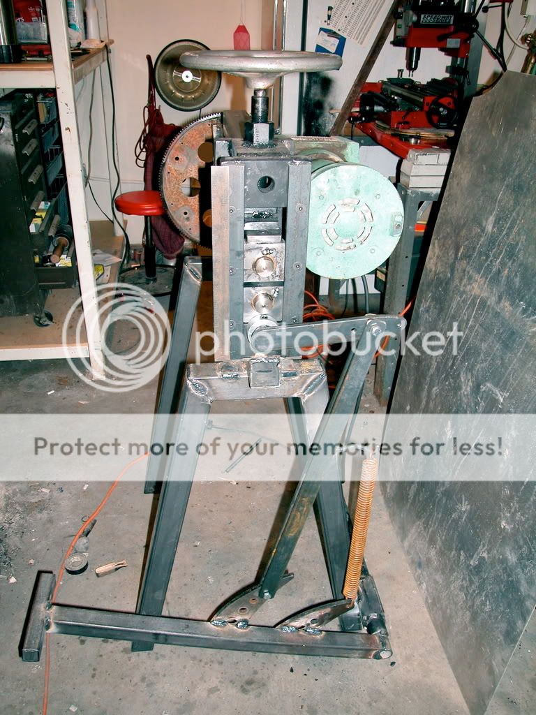

T.C. What kind of arrangement are you using for you feed petal. Is the lever turning a shaft with a pair of cam lobes to raise the lower driven roller?
Jim Arbuckle
Jim Arbuckle
jim your right on the money its a twin cam :D setup.

It's used to roll hot steel down to narrower and narrower thickness. Same as a power hammer or hydraulic press squishes the metal to make it longer and thinner.
The foot pedal allows you to have two different gaps between the rolls. When the foot pedal is not depressed, the gap is larger than the thickness of the steel. The hot steel is put through the rolls to the far side. The forger then pushes his/her foot down on the pedal, forcing the rolls closer together. The rolls grab hold of the steel, which is not thicker than the gap between the rolls and rolls it out from one side of the mill to the other side (forcing the steel narrower and longer at the same time). This is a good tool for those of us who do not have room for a power hammer or a hydraulic press.

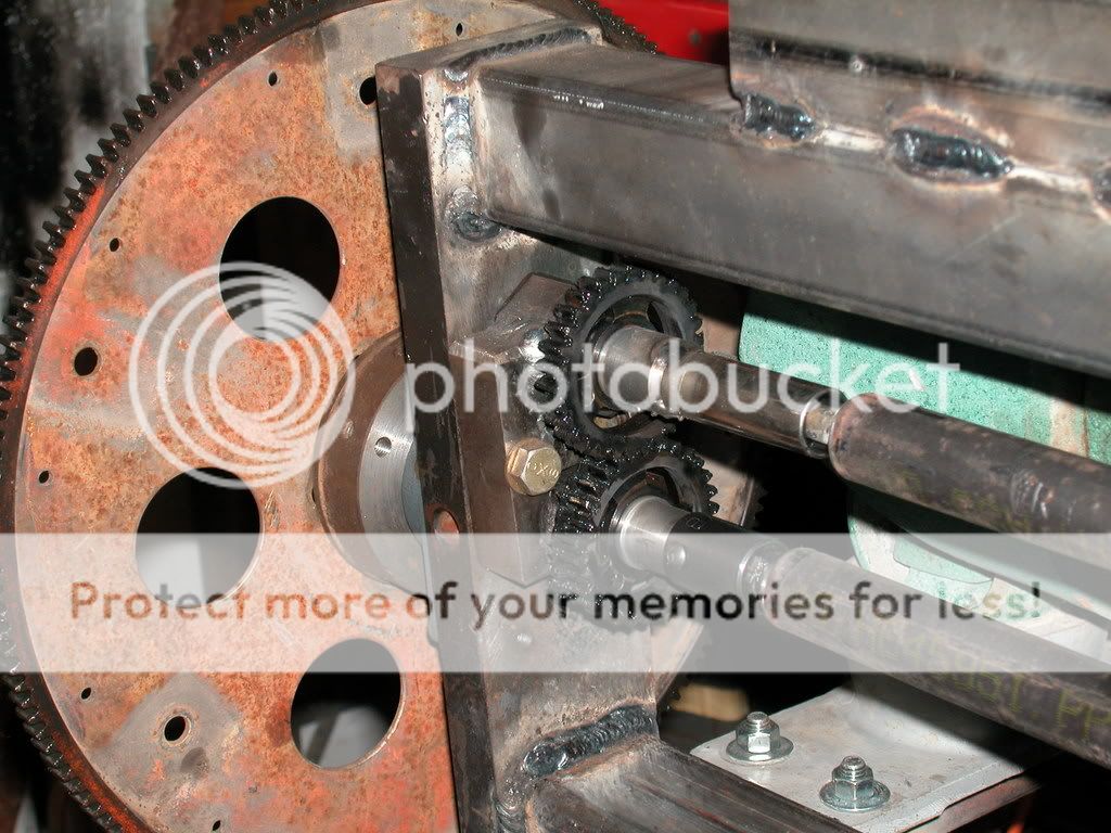

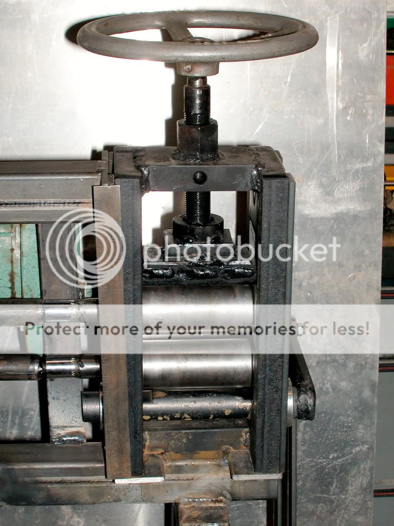

A few things that might help, this roller was made so that the rolls could be changed quickly, (shaped rolls )
the rollers are made of hollow Cummings rest pins press fit with the shafts then trued up in a four jaw on the lathe. (harded and ground by Cummings):D
the splitter gears are out of a motorcycle and are a match set from one transmission.(about three sets in that one bike)
drive shafts are heavy wall tube and grade eight bolt on each end, fit in threads for ajustment and then pre-heat and weld.
recivers are sockets (proto:D ) some are deep wall and welded some are machined fit.(all will me machined on the new mill) the deep walls have spring and stops inside to maintain spaceing.
primary drive is a gm flywheel and starter gear(this was some what of a fix):o
rpm is 22 at the rollers
base HP 1/3
it is set up with bushings and grease(same on the new one)
the new roller has a forward and revers and more power, not too many changes.:D :D
all togather not unplesant to run:D
